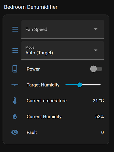

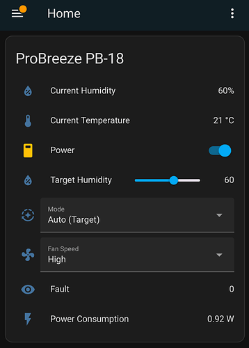

Home Assistant configuration and card look as follows (I only mapped data points relevant to me):

(The power consumption is coming from a smart socket. The device sips a bit under 1W in standby with it still being fully accessible over Wi-Fi and about 150W with the compressor running. The 12L device can easily handle a 20m² dry room with humidities up to 80%.)

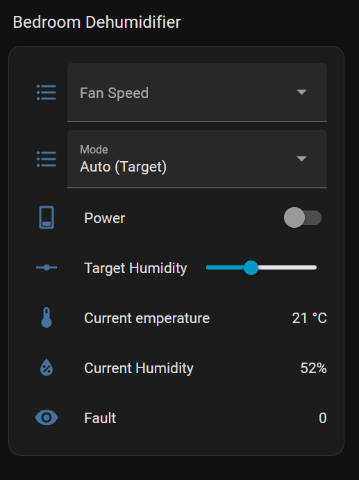

Thanks for taking the time to sort this out. I’ve just bought one of these and have done all the Tuya developer stuff and have just the Power button added as an entity (which works fine) Is there a simpler way of adding all the entities you show in your screen grab?
Figure it out, manually added them all.

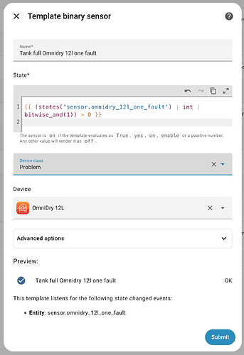

To decode the fault bitmap, you can use helper. You can have a single helper that will display the list of Errors or one helper per type of error.
  1. if you want a single sensor with the list of errors, create an helper (Settings → Devices → Helpers)
    Choose a helper of type template, then choose sensor. Then use the following template
{% set value = states('sensor.omnidry_12l_one_fault') | int %}
{% set labels = ["FULL","Cleaning","E1","CL","CH","LO","COIL","MOTOR"] %}
{% set bits = [1,2,4,8,16,32,64,128] %}
{% set data = namespace(active=[]) %}
{% for i in range(labels | length) %}
  {% if (value | bitwise_and(bits[i])) > 0 %}
    {% set data.active = data.active + [labels[i]] %}
  {% endif %}
{% endfor %}
{{ data.active | join(', ') if data.active else "OK" }}
Remplace omnidry_12l_one_fault by the name of your sensor !
You can of course change labels to more meaningful names (ex: “Temperature to low” instead of CL)
  1. If you want one sensor by faults, create helpers (Settings → Devices → Helpers)
    Choose a helper of type template, select binary sensor, then use the following template
    {{ (states('sensor.omnidry_12l_one_fault') | int | bitwise_and(X)) > 0 }}
Remplace X by
  • 1 for a Tank Full sensor
  • 2 for the Cleaning error
  • 4 for the E1 error
  • 8 for CL (temperature is bellow 5°C)
  • 16 for CH (temperature is over 38°C)
  • 32 for LO (Humidity is bellow 25%)
  • 64 for COIL
  • 128 for MOTOR
See example bellow
