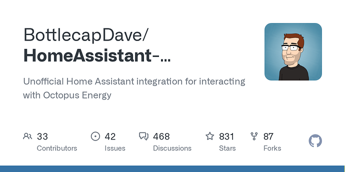

Maybe this integration could provide the data you want, without requiring custom programming?

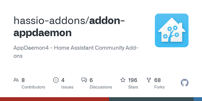

If you’d rather use Python, then AppDeamon is an option. It too has easy access to everything Home Assistant has on offer:
https://appdaemon.readthedocs.io/en/latest/
