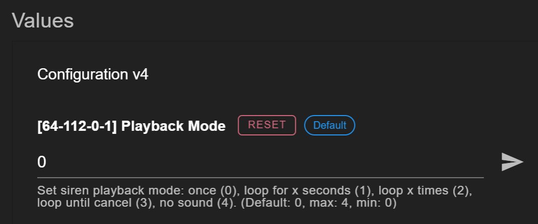

The command_class can be found in the Z-Wave JS UI under the Configuration tab:
There are about five actions that can be used to set the property values. I found the zwave_js.set_value to be the easiest.
