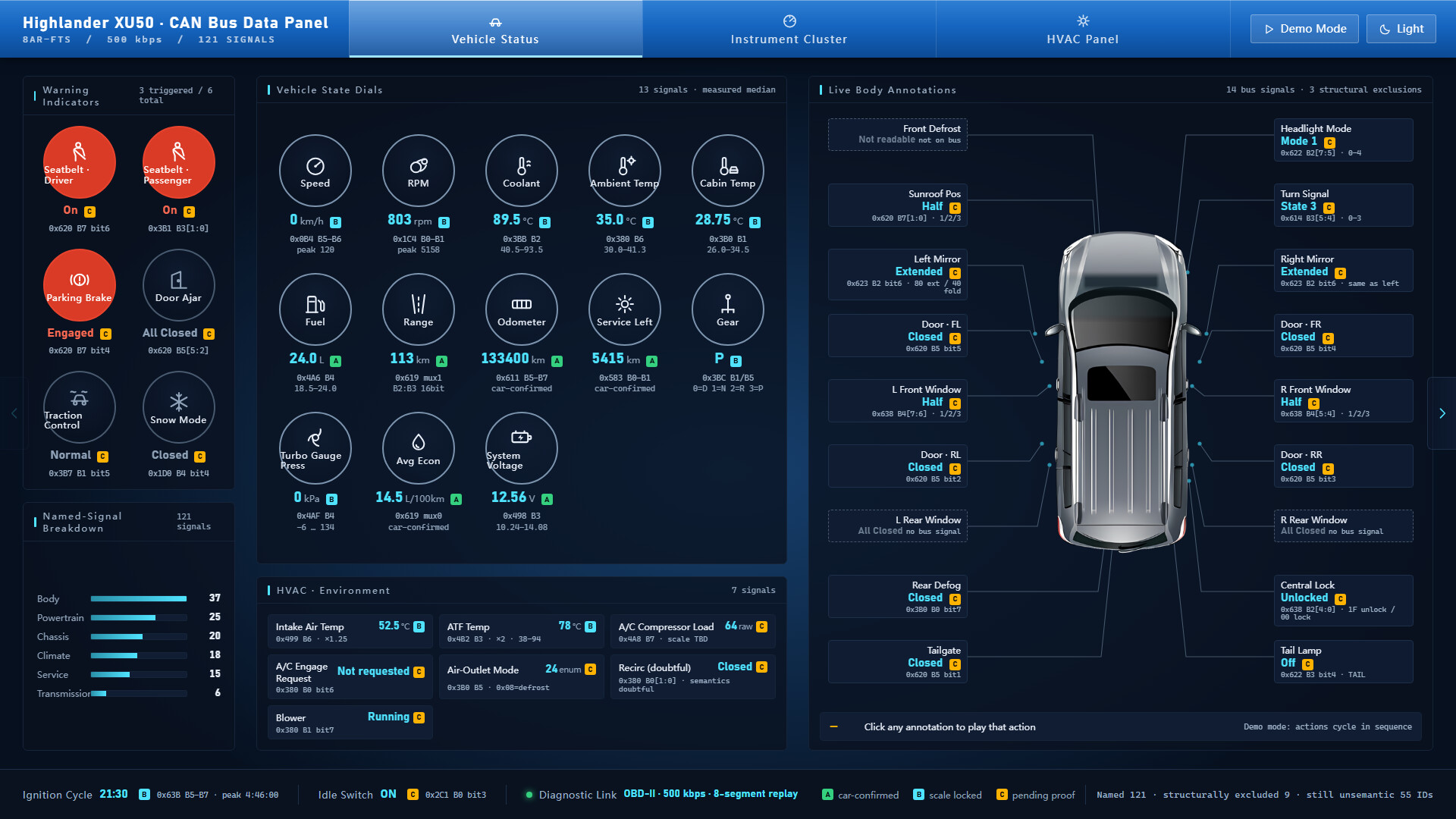

Here’s where it is right now — my own dashboard, rebuilt entirely from decoded signals:

Everything is driven 1:1 by decoded signals. The Vehicle Status tab above is the top-down car reacting live to the body signals — doors, windows, mirrors, turn signals, headlights, trunk, central lock.

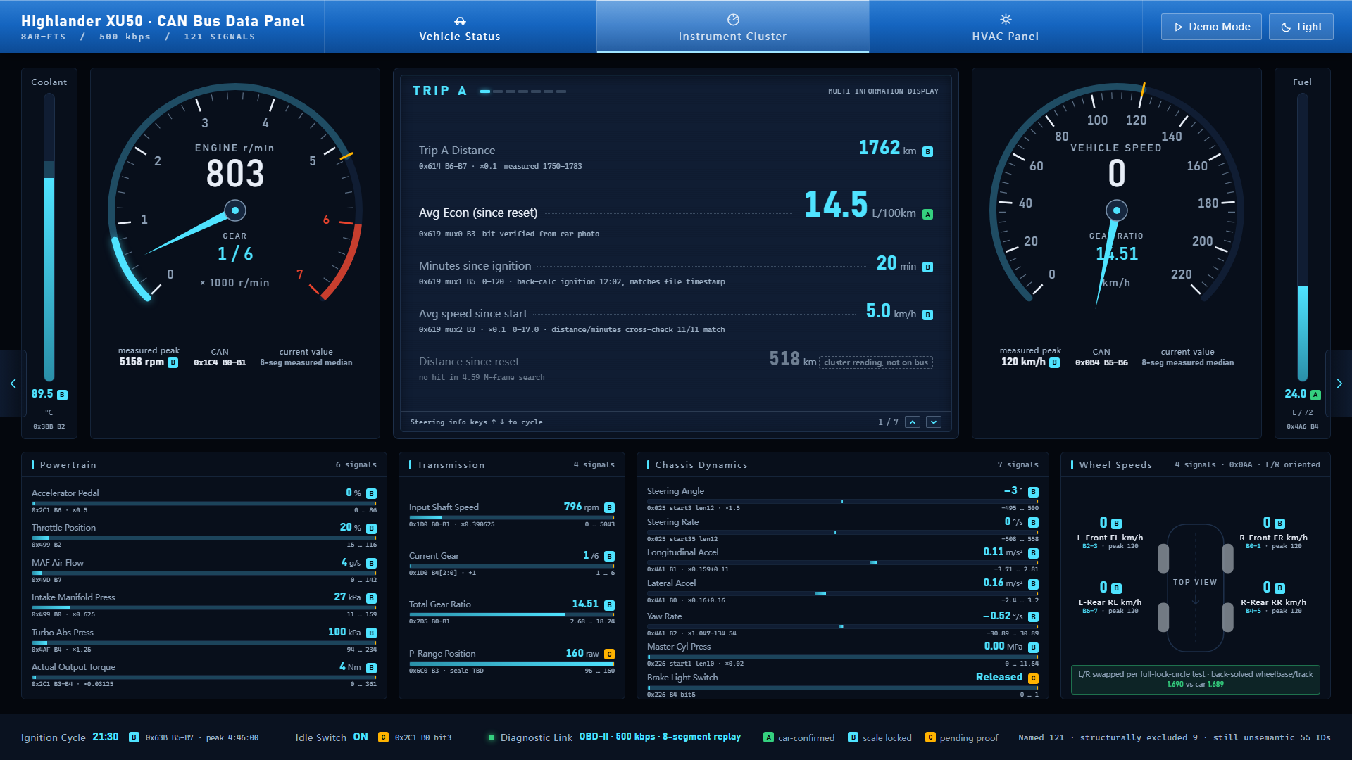

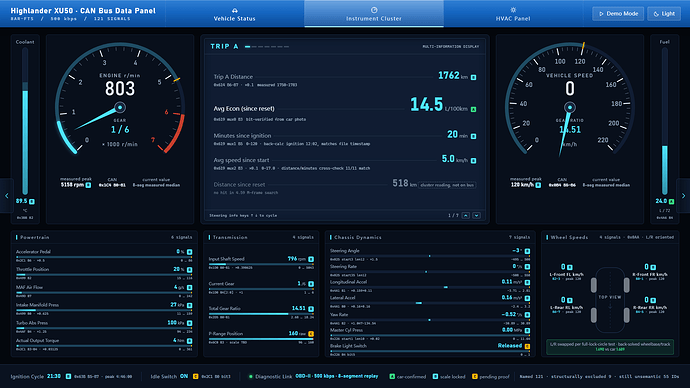

Instrument Cluster — RPM, speed, gear, trip computer, chassis dynamics, per-wheel speed:

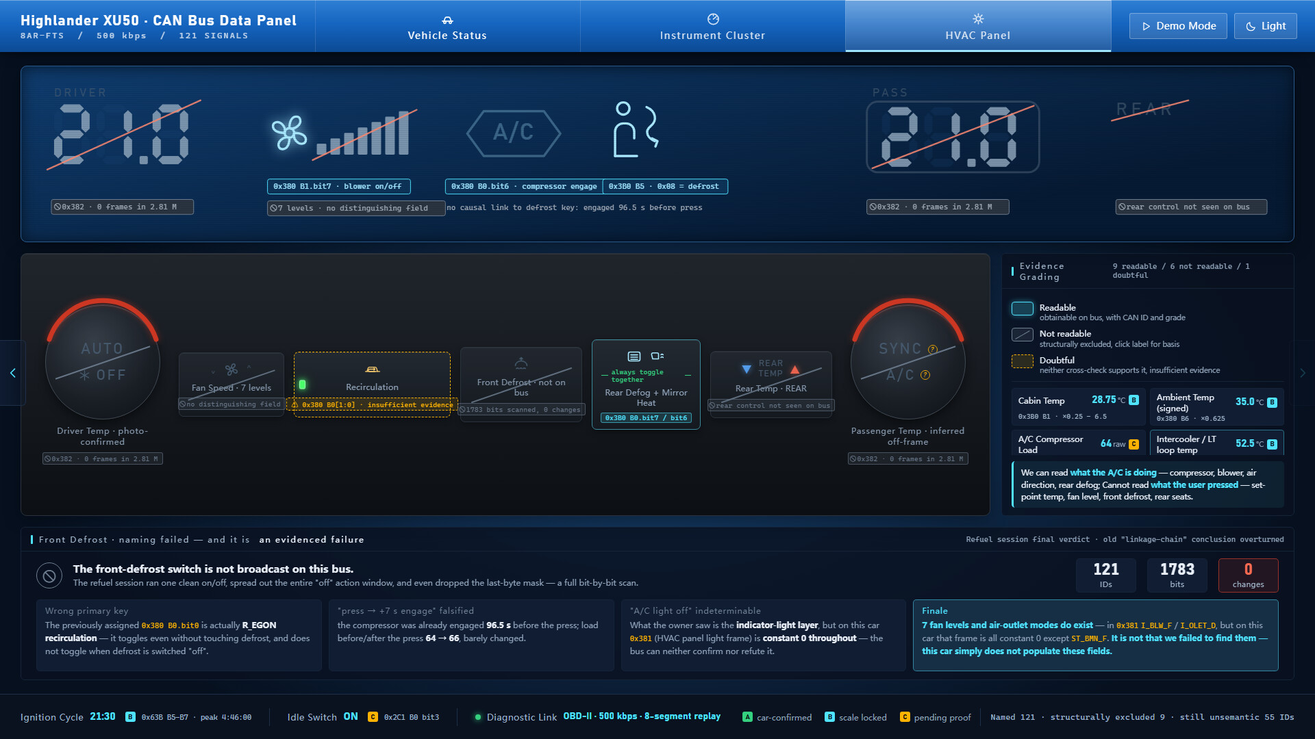

HVAC Panel — compressor, blower, air direction, rear defog. It also carries an honest evidence grid of what the bus can’t tell me — including “front defrost”, which after a full bit-by-bit scan turned out to simply not be broadcast on this bus at all (more below):

  • A negative result, proven: “front defrost” isn’t on this bus at all. I first assumed it was a linked action chain, but a full bit-by-bit scan across a clean on/off session showed zero bits changing. The switch simply isn’t broadcast on the powertrain bus — a genuine, evidenced “not readable”, not a decode I missed.
