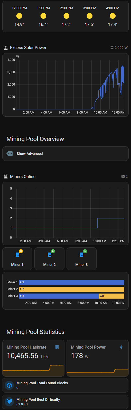

1] Overview
Project Solar Mining introduces a smart, self-regulating mining pool that enables households to mine Bitcoin using excess solar power.
This self-regulating mining pool dynamically manages a Bitcoin mining pool (up to 3 miners) to optimize energy usage based on excess solar power being returned to the grid.
It ensures miners only run when there’s sufficient excess power, preventing unnecessary grid draw, while incorporating hysteresis to avoid frequent on/off cycles that could stress hardware.
1.1] How It Works
1.1.1] Trigger
The automation runs every 15 minutes.
This interval allows for regular checks without overwhelming the system.
1.1.2] Setup Excess Power Variable
It sets a variable [Excess Solar Power Remaining] to the current excess solar power.
This represents the current excess solar power budget available for miners.
As miners are activated, this value is reduced to reflect remaining capacity.

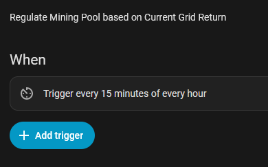

Don’t poll it. That is creating unneeded triggers. Use a numeric state trigger with a for time of 15 minutes.
First of all, thanks for the suggestion.
So this is not correct?
The goal is to regulate the mining pool each 15 minutes.
Not sure I can do without that part without losing some predictability.
Edit: I could do this by making a more complex When section that triggers when:
  • miner 1 excess solar power met is on for 15 minutes
  • miner 1 shutdown threshold met is on for 7 minutes
  • miner 1 requirements override changed
  • miner 1 out of circuit changed
  • miner 2 excess solar power met is on for 15 minutes
  • miner 2 shutdown threshold met is on for 7 minutes
  • miner 2 requirements override changed
  • miner 2 out of circuit changed
  • miner 3 excess solar power met is on for 15 minutes
  • miner 3 shutdown threshold met is on for 7 minutes
  • miner 3 requirements override changed
  • miner 3 out of circuit changed
But that makes me think it would make the automation less maintainable.
