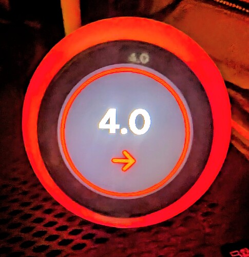

I’ve just shared my project using the Xiaozhi Specball V2 (commonly known as the “Bolita”) as a dedicated Diabetes Monitor.
It’s an ESP32-S3 based device with a display, and I’ve integrated it with Dexcom CGM data through ESPHome and Home Assistant.
Key Features:

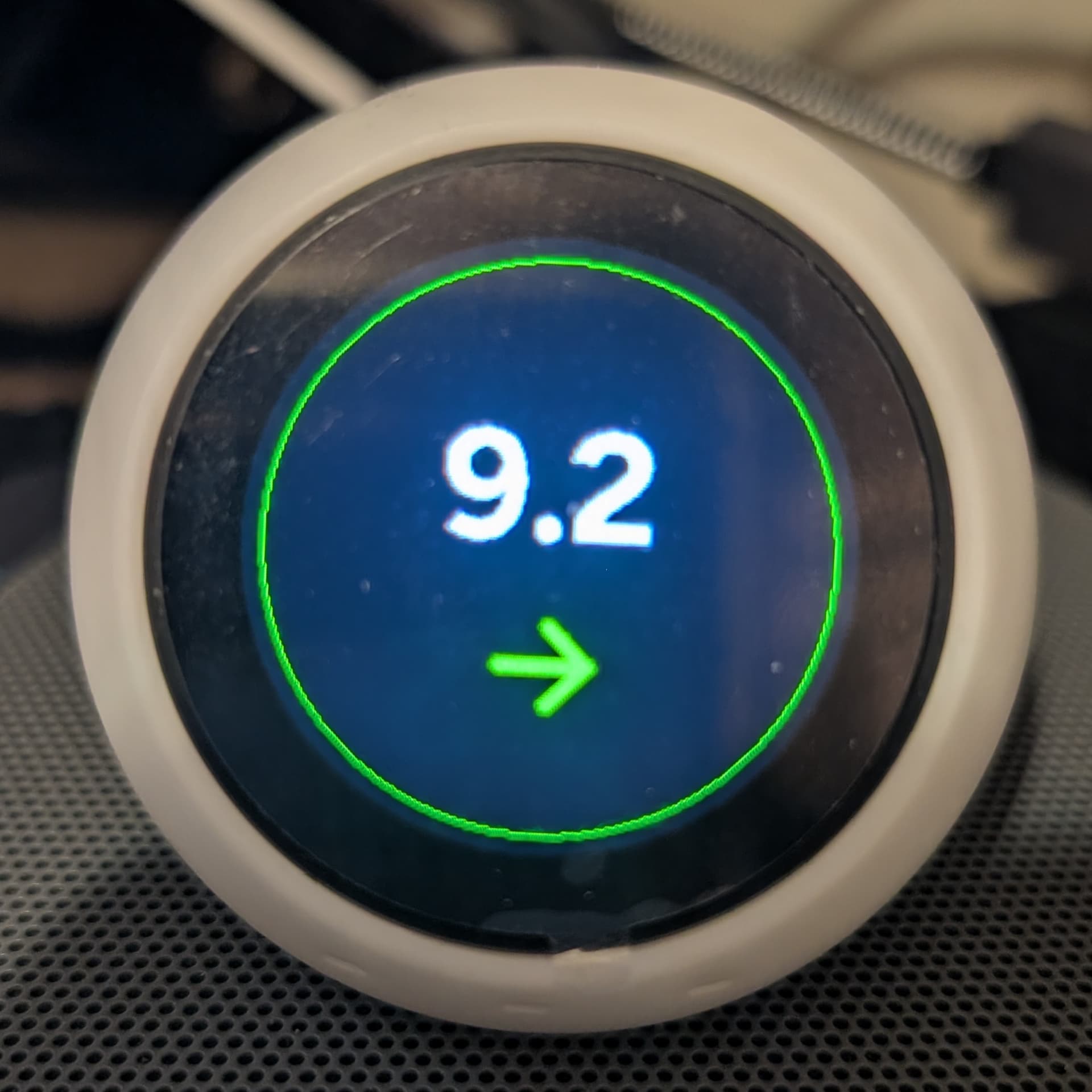

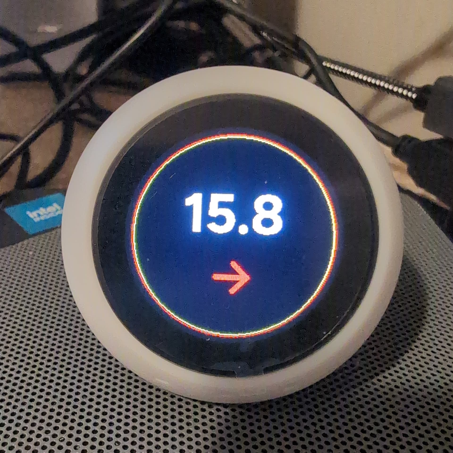

  • Real-time Glucose: Visual tracking directly on the Specball’s screen.
  • Voice Assistant: Integration for alerts and status updates.
  • Customizable: Based on ESPHome, so you can tweak the UI or sensors easily.
If you have one of these “balls” sitting on your desk and want to give it a life-saving purpose, check it out!

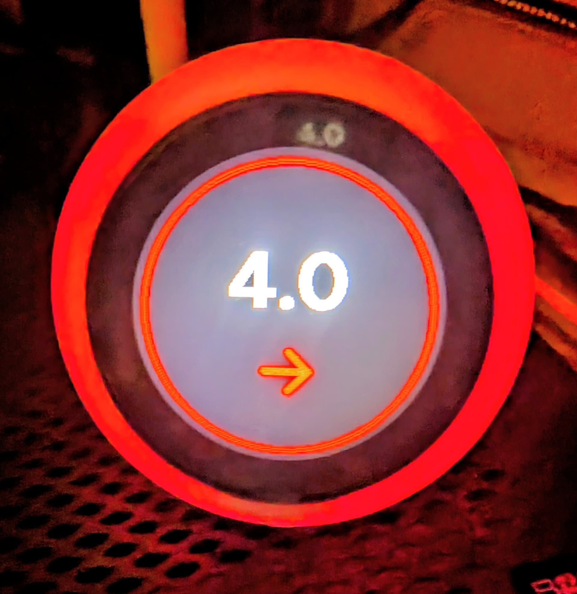

New features: Internal RGB led use to send visual alarm, activated when reach tresholds Low Medium/High and High.

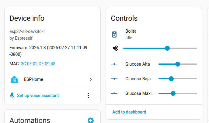

New 3 entities created in ESPHome to adjust those tresholds
