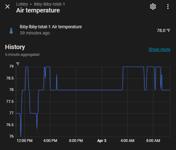

I set up a Prometheus database that takes data from HAOS and then use Grafana to display the data.

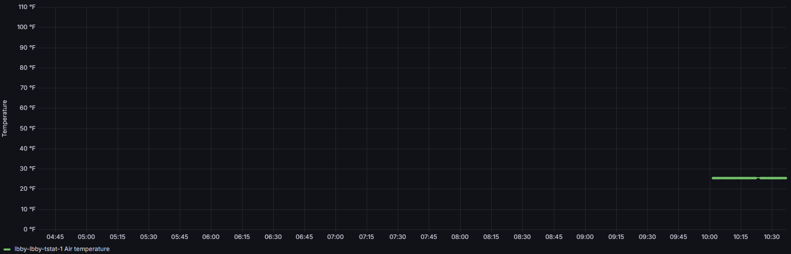

When I display a temperature entity data in Grafana, the values are in Celsius, and the y-axis shows in Fahrenheit.

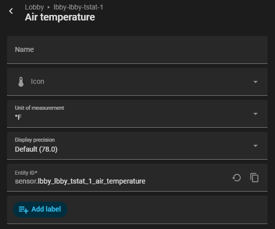

The unit of measure inside each of my entities is in Fahrenheit, but somehow Prometheus is pulling Celsius data.

Hmm I don’t know what just happened, but I checked on things again and now they’re reporting in Fahrenheit…
Oh nevermind I’m silly. I forgot that I tried to multiply in grafana to convert C to F. I also added to properly convert the number fully.
I used the Operations → Binary Functions to multiply and add
