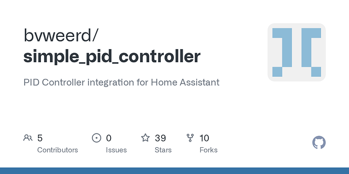

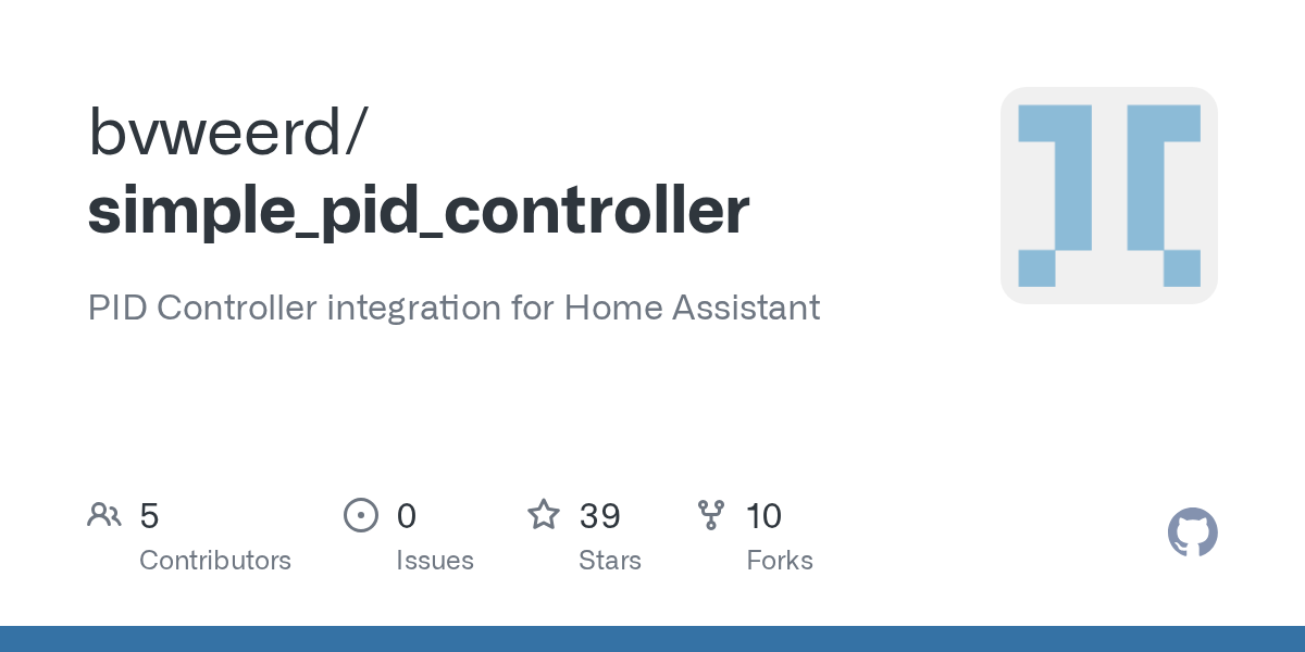

This will probably do a better job of proportional control (if you tune it right):

Would this work with an AC connected to HA through SmartThings?
