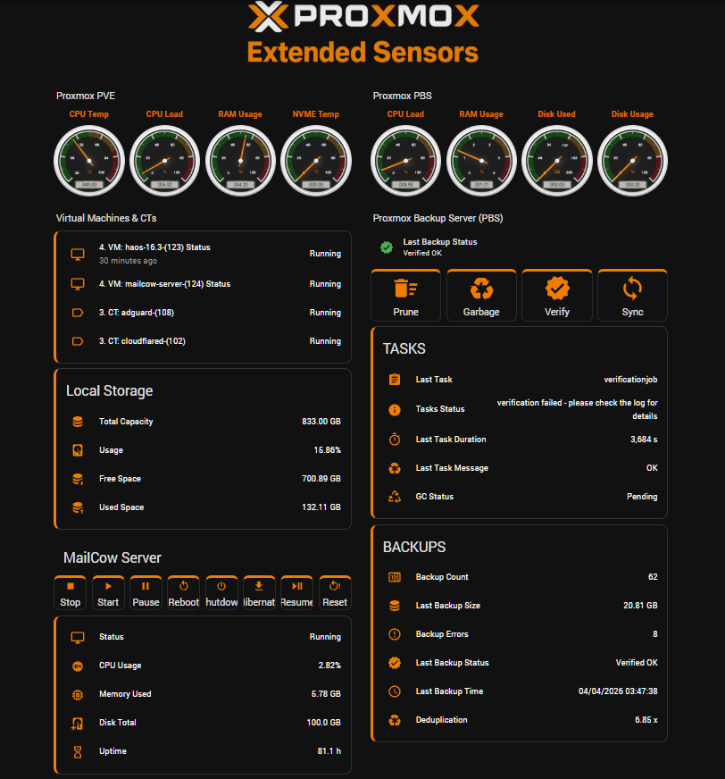

:magnifying_glass_tilted_left: What does this integration offer?
:check_mark: Advanced monitoring for PVE
  • Sensors for CPU, RAM, storage, node status, and VM/CT status
  • Network RX/TX sensors for virtual machines and containers
  • Clean device grouping for a clear and organized UI
:check_mark: Direct actions on VMs and CTs
Buttons for:
  • Start
  • Shutdown
  • Stop
  • Reboot
  • Reset
  • Suspend / Resume
  • Hibernate (when supported)
All accessible directly from Home Assistant without opening the Proxmox interface.
:shield: PBS integration and maintenance tools
:check_mark: New maintenance buttons
Trigger PBS maintenance tasks directly from Home Assistant:
  • Garbage Collect
  • Prune
  • Verify
  • Sync
:check_mark: New “Last Action” sensor
A local sensor that displays the last maintenance action performed.
  • Initial state: “Waiting”
  • Instantly updated when any maintenance button is pressed
  • Fully local and independent from the coordinator
  • Stable and persistent across restarts
:check_mark: Organized by datastore
Each datastore has its own device grouping, keeping everything clean and easy to navigate.
:broom: Internal improvements and cleanup
  • Full refactor of the PBS module
  • Removal of obsolete entities
  • Cleaner, more maintainable codebase
  • Improved compatibility with Home Assistant
:motorway: Roadmap
  • Custom Lovelace card templates
  • Submission to HACS as an official repository
  • Advanced PBS maintenance sensors (progress, duration, logs)
  • Optional advanced PBS dashboard
  • Create VM/CT backups directly from PVE via Home Assistant
If you’d like to try it, share feedback, or suggest improvements, you’re more than welcome.
Every idea helps refine the integration and push it even further.
Thanks, and I hope you find it useful.

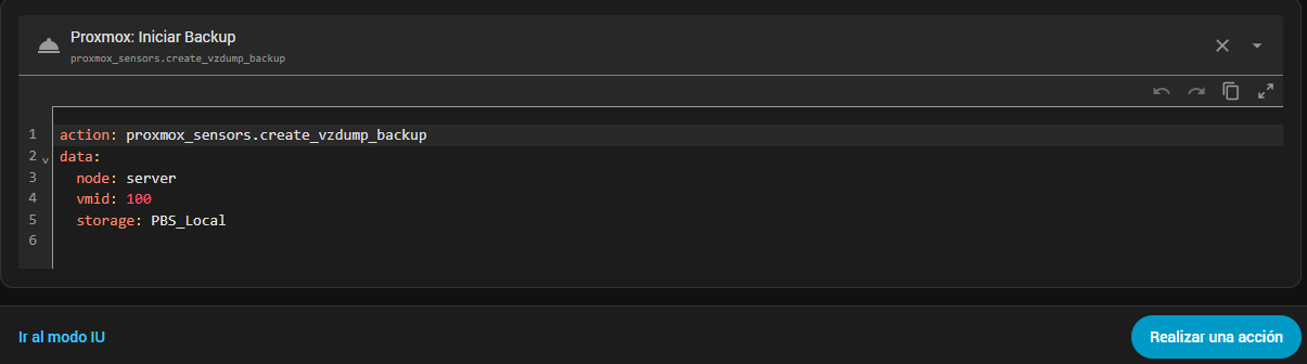

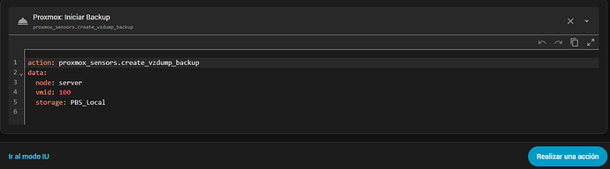

Example YAML:
action: proxmox_sensors.create_vzdump_backup
  node: your_node_name
  vmid: 100
  storage: YOUR_REMOTE_STORAGE_NAME
New service interface in Home Assistant.
Identified backups as seen in Proxmox Backup Server.

Thanks for this integration. Do you mind sharing a nice dashboard ? Like yours in the first post ?
Have a nice day !
I’ve uploaded the sample dashboard to this repository for you to download:
You need to create a folder called “proxmox_sensors” in config/www and include the files from the repository.
Once you rename your sensors, it should look like this:
