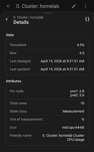

Ok This is my fault, something changed on HA and now atributes are in a detail section inside the sensor. Sorry about that and thanks for your help!
I’m glad you solved it.
That’s right, what used to be called attributes are now called details.
Explore the sensors, which come loaded with fascinating details. :wink:

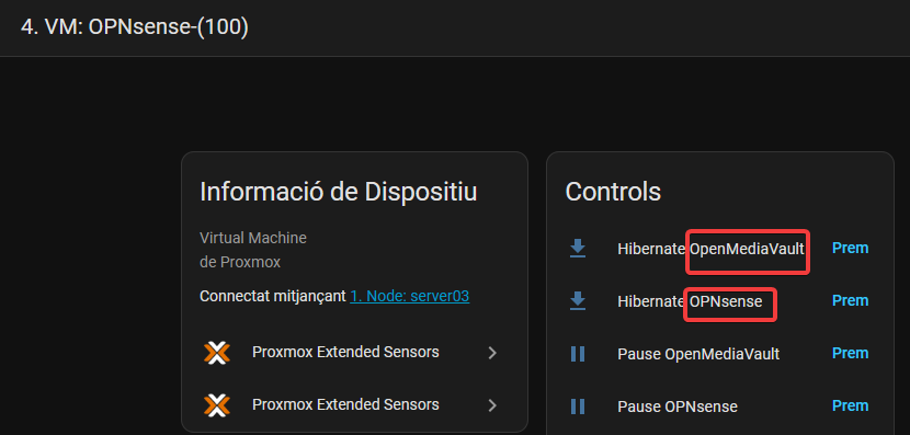

Here I go again, I’ve noticed that the integration mixed VM and LXC from different nodes but same ID. As you can see on the screenshot there are 2 buttons for every VM on the same sensor. This screen is from one node that have OMV ID 100 but it shows OPNSENSE that is from another node and ID 100
Hi!
Thanks for the detailed report — this is very helpful.
You are absolutely right: VM/CT IDs are not unique across nodes in Proxmox, and this can cause conflicts if the node is not included in the identifier.
It looks like the integration is currently not fully distinguishing between nodes when generating entities.
I will review this and fix it so that node + VMID are used as unique identifiers.
Thanks for reporting this :+1:
This should now be fixed in the latest release (v3.0.2).
The update improves how VMs and LXC containers are identified across nodes, preventing collisions when the same VMID exists on different nodes.
Please update and let me know if you still see duplicated or mixed entities.
Updated the integration, re-add all nodes again and now all seems ok

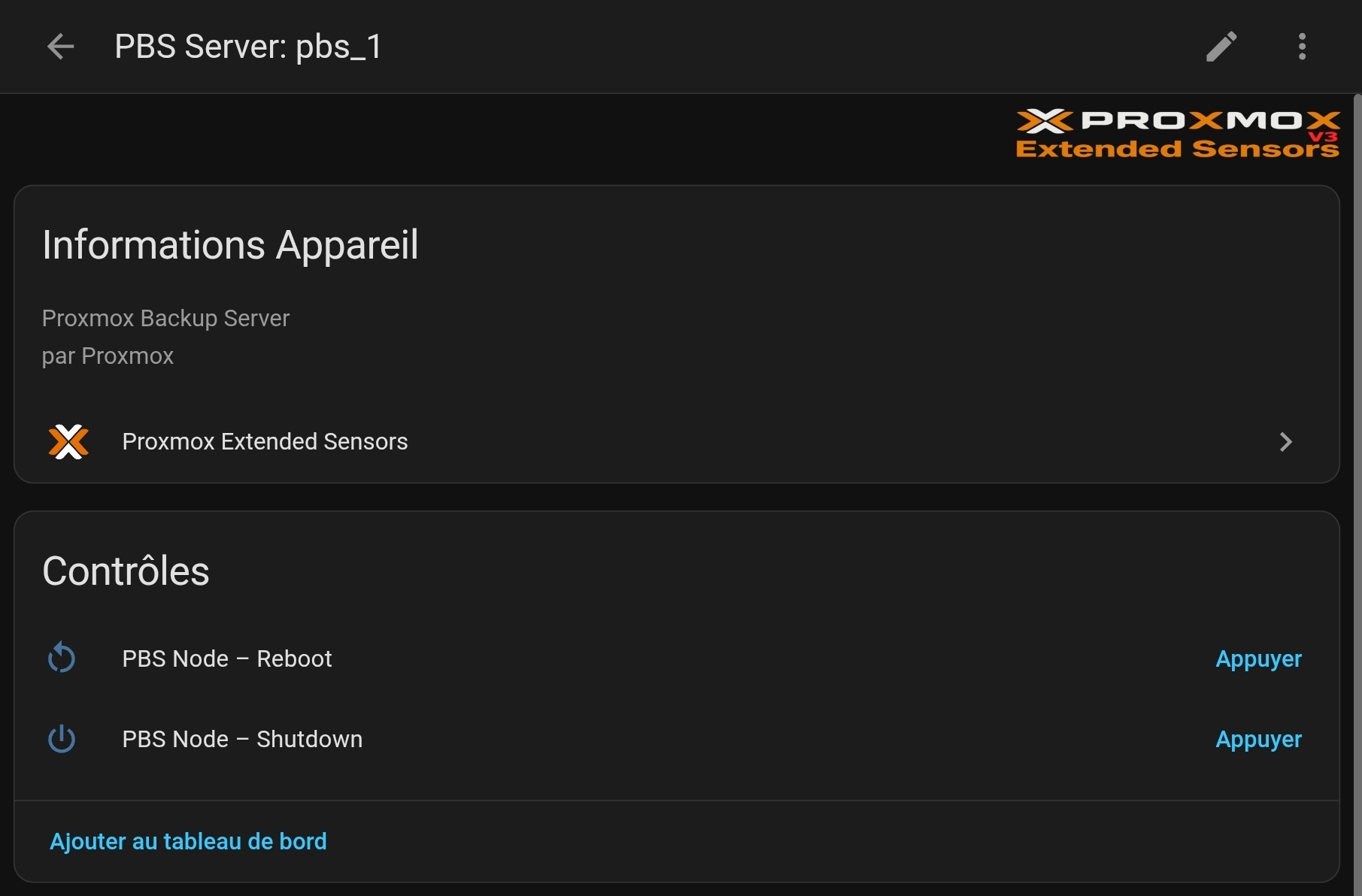

Cependant j'ai un petit soucis avec le PBS
les boutons reboot et shutdown ne fonctionnent pas !! Sinon le reste fonctionne très bien
