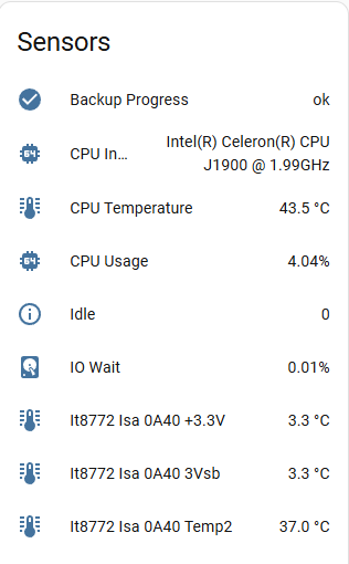

I like this integration that can give me a lot more info. However, the Voltage Rails reading was reported as “Temperature”. Will be good if these can be corrected.
Thanks for reporting this.
Could you please open the following URL in your browser?
http://<your-proxmox-ip>:9000/sensors
and send me the JSON output (or at least the section containing the It8772 sensor)?
I don’t have a motherboard that exposes voltage sensors, so I’d like to see how they’re reported by the API in order to correctly identify them and assign the proper Home Assistant unit (V instead of °C).
This is the output from “:9000/sensors”
{“soc_dts1-virtual-0”:{“Adapter”:“Virtual device”,“temp1”:{“temp1_input”:44.000000}},“coretemp-isa-0000”:{“Adapter”:“ISA adapter”,“Core 0”:{“temp2_input”:41.000000,“temp2_max”:105.000000,“temp2_crit”:105.000000,“temp2_crit_alarm”:0.000000},“Core 1”:{“temp3_input”:41.000000,“temp3_max”:105.000000,“temp3_crit”:105.000000,“temp3_crit_alarm”:0.000000},“Core 2”:{“temp4_input”:45.000000,“temp4_max”:105.000000,“temp4_crit”:105.000000,“temp4_crit_alarm”:0.000000},“Core 3”:{“temp5_input”:45.000000,“temp5_max”:105.000000,“temp5_crit”:105.000000,“temp5_crit_alarm”:0.000000}},“it8772-isa-0a40”:{“Adapter”:“ISA adapter”,“in0”:{“in0_input”:1.632000,“in0_min”:2.268000,“in0_max”:3.060000,“in0_alarm”:1.000000,“in0_beep”:0.000000},“in1”:{“in1_input”:1.356000,“in1_min”:2.676000,“in1_max”:2.100000,“in1_alarm”:1.000000,“in1_beep”:0.000000},“in2”:{“in2_input”:2.208000,“in2_min”:0.204000,“in2_max”:2.064000,“in2_alarm”:1.000000,“in2_beep”:0.000000},“+3.3V”:{“in3_input”:3.288000,“in3_min”:2.256000,“in3_max”:5.232000,“in3_alarm”:0.000000,“in3_beep”:0.000000},“in4”:{“in4_input”:2.232000,“in4_min”:2.580000,“in4_max”:1.620000,“in4_alarm”:1.000000,“in4_beep”:0.000000},“in5”:{“in5_input”:2.232000,“in5_min”:1.836000,“in5_max”:0.132000,“in5_alarm”:1.000000,“in5_beep”:0.000000},“in6”:{“in6_input”:2.220000,“in6_min”:1.524000,“in6_max”:2.292000,“in6_alarm”:0.000000,“in6_beep”:0.000000},“3VSB”:{“in7_input”:3.264000,“in7_min”:5.352000,“in7_max”:1.440000,“in7_alarm”:1.000000,“in7_beep”:0.000000},“Vbat”:{“in8_input”:3.312000},“fan1”:{“fan1_input”:0.000000,“fan1_min”:0.000000,“fan1_alarm”:0.000000,“fan1_beep”:0.000000},“fan2”:{“fan2_input”:0.000000,“fan2_min”:0.000000,“fan2_alarm”:0.000000,“fan2_beep”:0.000000},“fan3”:{“fan3_input”:0.000000,“fan3_min”:0.000000,“fan3_alarm”:0.000000,“fan3_beep”:0.000000},“temp1”:{“temp1_input”:-38.000000,“temp1_max”:127.000000,“temp1_min”:-128.000000,“temp1_alarm”:0.000000,“temp1_type”:6.000000,“temp1_offset”:86.000000,“temp1_beep”:0.000000},“temp2”:{“temp2_input”:38.000000,“temp2_max”:127.000000,“temp2_min”:-128.000000,“temp2_alarm”:0.000000,“temp2_type”:3.000000,“temp2_offset”:25.000000,“temp2_beep”:0.000000},“temp3”:{“temp3_input”:-56.000000,“temp3_max”:127.000000,“temp3_min”:48.000000,“temp3_alarm”:0.000000,“temp3_type”:3.000000,“temp3_offset”:0.000000,“temp3_beep”:0.000000},“pwm1”:{“pwm1”:24.000000,“pwm1_freq”:23437.000000,“pwm1_enable”:2.000000},“pwm2”:{“pwm2”:24.000000,“pwm2_freq”:23437.000000,“pwm2_enable”:2.000000},“pwm3”:{“pwm3”:64.000000,“pwm3_freq”:23437.000000,“pwm3_enable”:0.000000},“intrusion0”:{“intrusion0_alarm”:1.000000}},“soc_dts0-virtual-0”:{“Adapter”:“Virtual device”,“temp1”:{“temp1_input”:43.000000}}}

I’ve been working on the reported issues and all three have now been addressed. These fixes will be included in the next release.
Fixed
  • Hardware voltage sensors
    • Voltage sensors detected through lm-sensors are now exposed with the correct Voltage (V) unit instead of being incorrectly shown as temperatures.
    • Added support for hardware fan speed (RPM) sensors exposed by lm-sensors.

NEW RELEASE 4.0.3
Fixed
  • Fixed automatic node detection when auto-discovery cannot reliably identify the target Proxmox node.
  • Reduced log spam for nodes that are intentionally offline or temporarily unreachable.
  • Fixed hardware voltage sensors being reported with an incorrect temperature unit.
Improvements
  • Added support for hardware voltage (V) sensors from lm-sensors.
  • Added support for hardware fan speed (RPM) sensors from lm-sensors.
