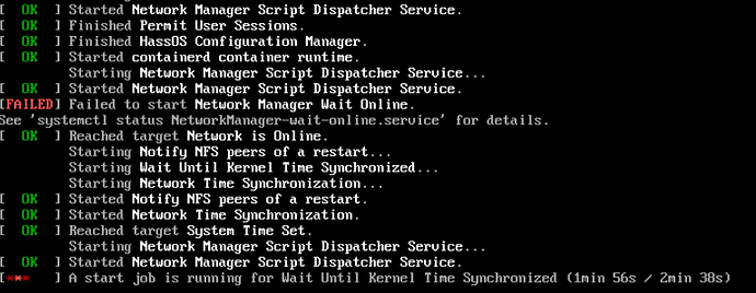

after upgrading i cant get ip. I get following error in the consol.
any idea why? all other VM is working fine. network settings are also same.

I read there is a chance V9 alters the naming of the internet connections. Did u check this?
it seems fine to me. Other than VLAN tag, others are working fine.

problem solved.
It turns out, it has nothing to do with pve9 upgrade. I changed my switch ports in unifi system at the same time of upgrade. and new switch port had VLAN tag disabled. :upside_down_face:
