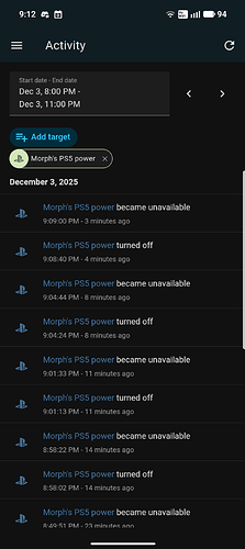

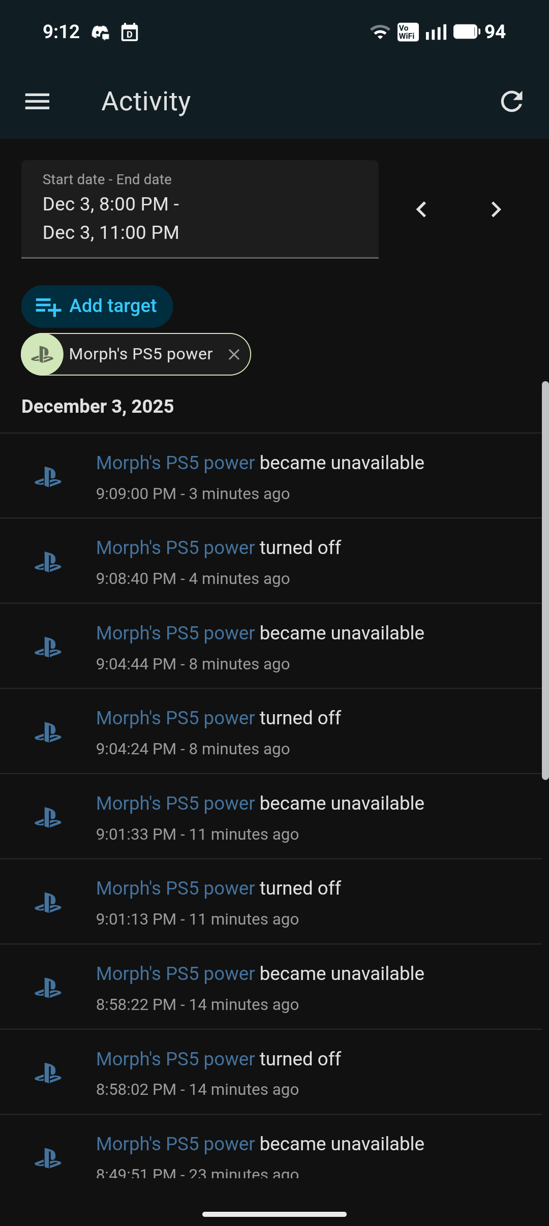

Anyone been having issues getting their PS5 to turn off lately? I installed everything about a week ago, and since then have only been able to turn off the PS5 twice, and I had to hit the off toggle like 30 times before it finally took.
Turning on is perfect every time, though (which is a good start for my universal remote to start the activity at least)
I’m having similar issues, but “on” doesn’t work every time either. I believe that it worked every time when I first installed about 2-3 weeks ago, but I might not have pressure tested it as much then as I did today (turned on and off a lot of times in a row - or at least tried to!).
I did find that if I try to turn off the PS5 before I’ve pressed the PS button on the controller (to get the sign in options) it works every time.
I have same issue
