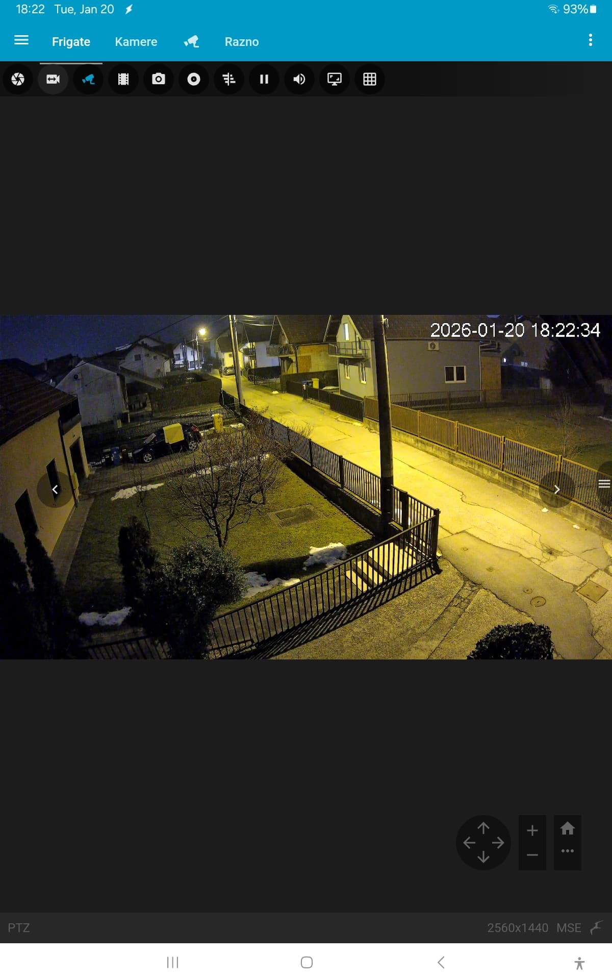

and looks like this:

Thank you for your answer.
Thank to you, now, I can use PTZ control into Frigate. But my card still doesn’t work.

The arrows are displayed, but not working with this code
