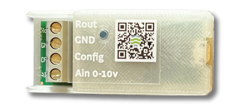

In my setup i cant set a virtual outdoor temperature sensor to influence the heat pump. This sensor is hard wired. I can set target temperature, or start temp/end temp (stooklijn), hysterese, etc through the ems bus (bbqkees).
Any other hooks that the integration has to control the heat pump?
Or did you add an esp32 or equivelent to the heatpump to create a serial signal that can set the outdoor temperature by replacing the wired sensor?
Thanks @Johan71, quite an expensive component.

@Johan71 how do you actually connect the Ohmigo unit?
Do you connect it in parallel with the original temperature sensor?
That is my understanding of the description on Github but that seems a bit strange to me… Or should I just replace the original temperature sensor with the Ohmigo?
I’ve got the integration installed and the Ohmigo gets the temperature from HA and the Pumpsteer automation so now I need to connect it to my CTC heat pump. :+1:
Replace the orginal sensor with the Ohmigo sensor.
