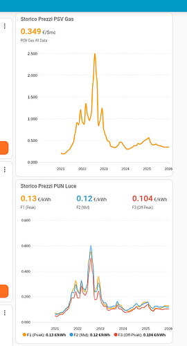

Hello all,
just a quick share of my project to implement custom cards in home assistant for GAS and light prices (reference prices from Italy).
https://blackwiz4rd.github.io/projects/2026-01-09-pun-psv-tracking/
I hope you can will use it in your project too! If you have any issue or doubt feel free to reach out.

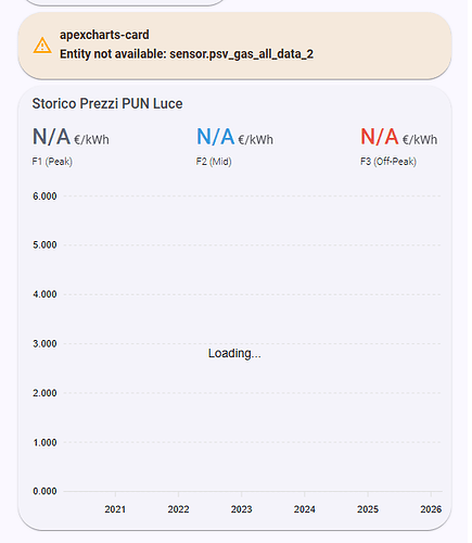

Esce questo errore…come posso fare un debug per vedere cosa c’è che non va?
Non carica nulla…
