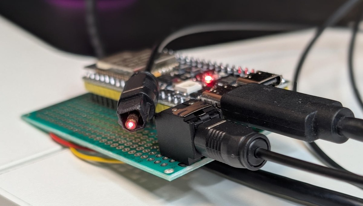

Pure, uncompressed, digital music, thanks to ESPHome and Music Assistant
We will build an elegant, discrete digital audio bridge:
  • It will be powered by an USB charger, hooked to your sound system via fiber optic, and easily hidden behind your living room furniture.
  • Its job is to stay out of the way of your music while being highly responsive to your commands.
  • It will receive music via Wi-Fi from Music Assistant, then pipe a perfect, low-latency copy of that music straight through the TOSLINK fiber optic into the highest-end equipment you care to own — from then on, however your music ends up sounding, will be exactly as good as your DAC, amplifier and speakers.
  • If you have more than one stereo or amplifier with TOSLINK input (e.g. one on each different room in your home), connect a bridge to each stereo in each room, and enjoy perfectly synchronized, lossless digital music everywhere.

You made an extensive page to describe all of this but why not just add a schematic instead of all those coordinates on a prefboard.
It will be much clearer and far more easier to follow what must be done.
Schematics are due soon and well be supplied, but this is a tutorial for beginners who are just starting to learn electronics and haven’t encountered a schematic yet.
