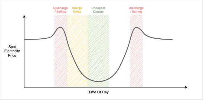

The main idea is based on the observed evolution of spot prices during each day.
It usually features two peaks - morning and evening - and a trough around midday. The peaks - typically short - are a good opportunity to sell excess energy accumulated in the battery at the best prices. Recharging is shifted to the cheapest hours, allowing you to take advantage of dropping - but still good - prices to sell more of the generated PV energy.
To avoid battery energy shortages, it uses PV forecasts to support the decision logic.
The observations introduced above lead to a set of general automation rules:
  1. Sell energy stored in batteries during peak price periods
  2. Delay battery charging during morning hours to keep selling PV production at good prices
  3. Charge the battery during the cheapest price window
  4. Discharge only if enough PV energy is forecasted
  5. Maintain a minimum energy level in the battery to avoid buying energy for household operations
This translates into four phases.
Discharge (morning and evening)
While it could be limited to a single discharge, splitting it into two has benefits:
  • Prices during evening hours are usually slightly higher
  • Due to the narrowness of peaks, it’s better to distribute energy across both
  • Splitting provides better margin management
  • Morning PV forecast allows a last-minute decision to skip the morning discharge
Discharging must not result in an energy deficit later. Therefore, no discharge is triggered if insufficient PV energy is forecasted. At the same time, minimum battery levels must be maintained. The remaining energy must cover the period where the charge is delayed.
The configuration of edge conditions may differ between installations. It should be set with a safe margin to avoid buying energy.
:electric_plug: To sell stored energy, the inverter is switched to a mode that exports battery energy to the grid. Depending on the inverter model and/or firmware version, such a mode may be available as a main operating mode or as a scheduled mode (Time of Use, ToU). This implementation uses a scheduled mode compatible with Wattsonic Gen3 firmware v2.
:red_exclamation_mark: Watch the discharge rate. Discharging too quickly can increase battery wear. A recommended range is 0.3–0.7C. Also, ensure you do not exceed any applicable grid injection limits.
Charge Delay
This is the period between the morning discharge and the cheapest charging window.

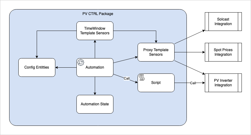

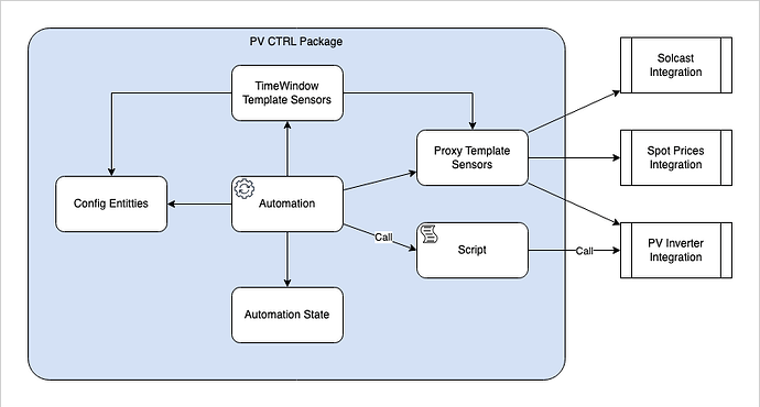

For easier deployment (and no better option) the entire solution is implemented as a Home Assistant package:
Proxy Sensors These act as an API layer over third-party sensors (inverter state, solar forecast, prices), decoupling your code from their data formats. If an integration changes, only the proxy sensors need updating.
On top of that, the proxy sensors preprocess the data, making it easier to use in subsequent logic and reducing resource consumption.
Script Like proxy sensors, the script.pv_ctrl_inverter acts as an abstraction layer, this time for controlling the inverter. It is a single, parameterized script implementing inverter-specific commands.
TimeWindow Sensors These template sensors calculate the start and end of charging and discharging periods for the current day:

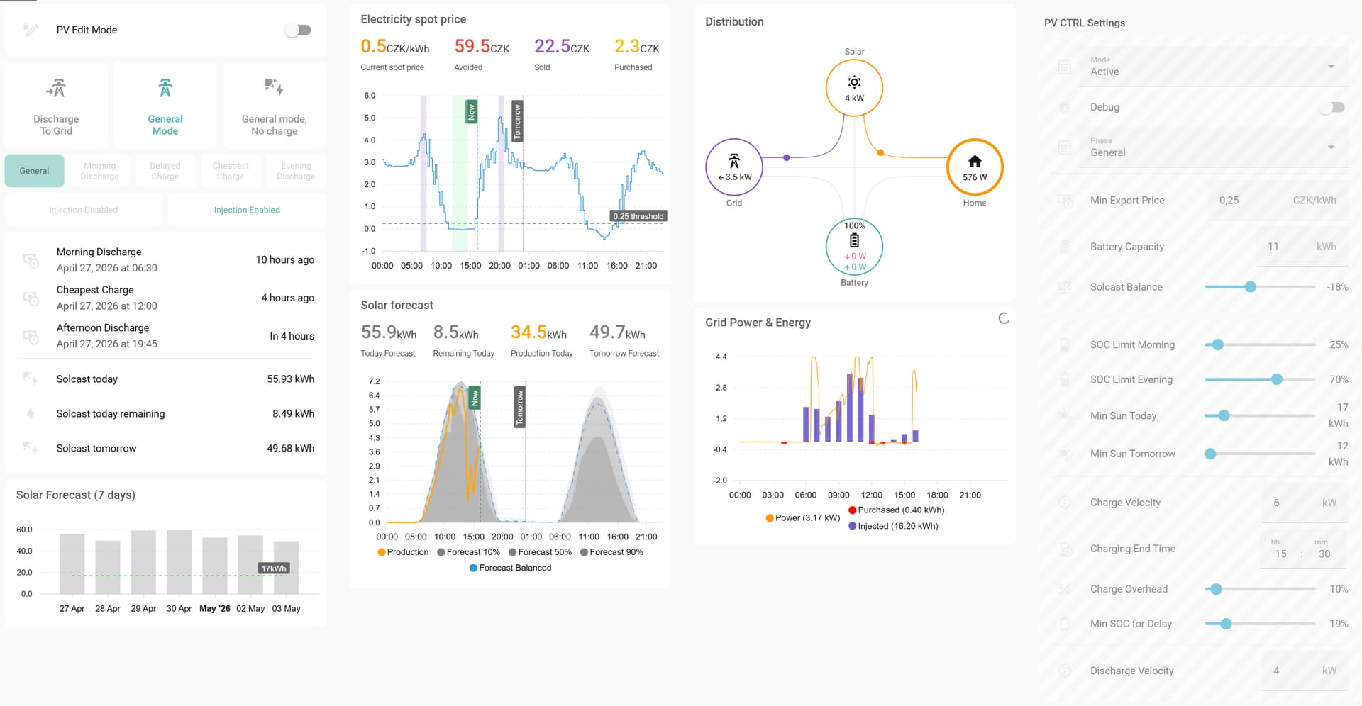

Automation State and Config Entities
Both are implemented as input entities, surviving Home Assistant restarts. All of them are exposed on GUI.
List of input entities
Entity Description
input_boolean.pv_ctrl_edit_mode Used for dashboard only, preventing accidental changes to the settings. It’s especially important for mobile views, where current HA UI makes an accidental change of parameters more then likely
input_boolean.pv_ctrl_debug Toggles recording the debug informations to the Home Assistant log. Automation has to be in Active or Dry Run mode
input_select.pv_ctrl_mode The defaul valuse (after the first init) is Disabled, preventing the automation to start witohut configuring and testing. It provides an option to run the automation either for real or in testing mode (Dry Run). The Dry-run does everything the Active mode does without calling Inverter for changing modes. When Disabled, the automation internally does nothing, though, like template sensors, it still collects data.
input_select.pv_ctrl_phase Represents the current automation phase (under normal circumstances not intended for manual editing). Possible values are General, Morning Discharge, Charge Delay, Cheapest Charge, Evening Discharge.
input_number.pv_ctrl_min_suncast_current_day Minimum forecasted energy for today; required for the morning discharge
input_number.pv_ctrl_min_suncast_next_day Minimum forecasted energy for tomorrow; required for the evening discharge
input_number.pv_ctrl_soc_limit_morning SOC limit for morning discharge
input_number.pv_ctrl_soc_limit_evening SOC limit for evening discharge
input_number.pv_ctrl_min_export_price Maximum energy price (per kWh), that prevents exporting energy (e.g., 0.25 CZK).
input_number.pv_ctrl_charge_velocity Maximum charging power, the velocity the battery can be charged with. Used to cap PV energy provided by Solcast
input_number.pv_ctrl_discharge_velocity Maximum discharge power, used to calculate a time needed to discharge battery to requested SOC
input_number.pv_ctrl_battery_capacity Used in calculation of 1% of SOC
input_number.pv_ctrl_solcast_forecast_balance Allows setting a balance between 10%, 50%, 90% percentile suncast prediction
input_datetime.pv_ctrl_charge_delay_time_limit Limits predicted end time of cheapest charge time window. Might be helpful if cheapest hours (occasionally) starts late afternoon, but you don’t want to delay charging so much
The Automation Finally, automation.pv_ctrl_executor is the core component that makes decisions based on its current state and inputs from sensors.
