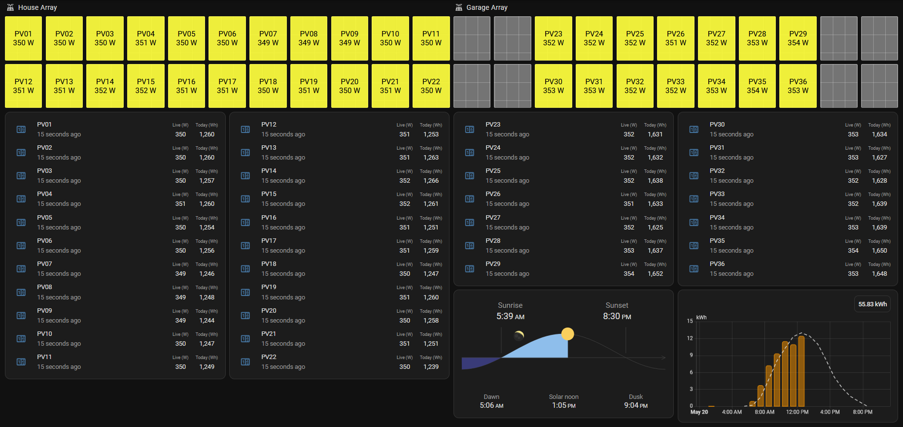

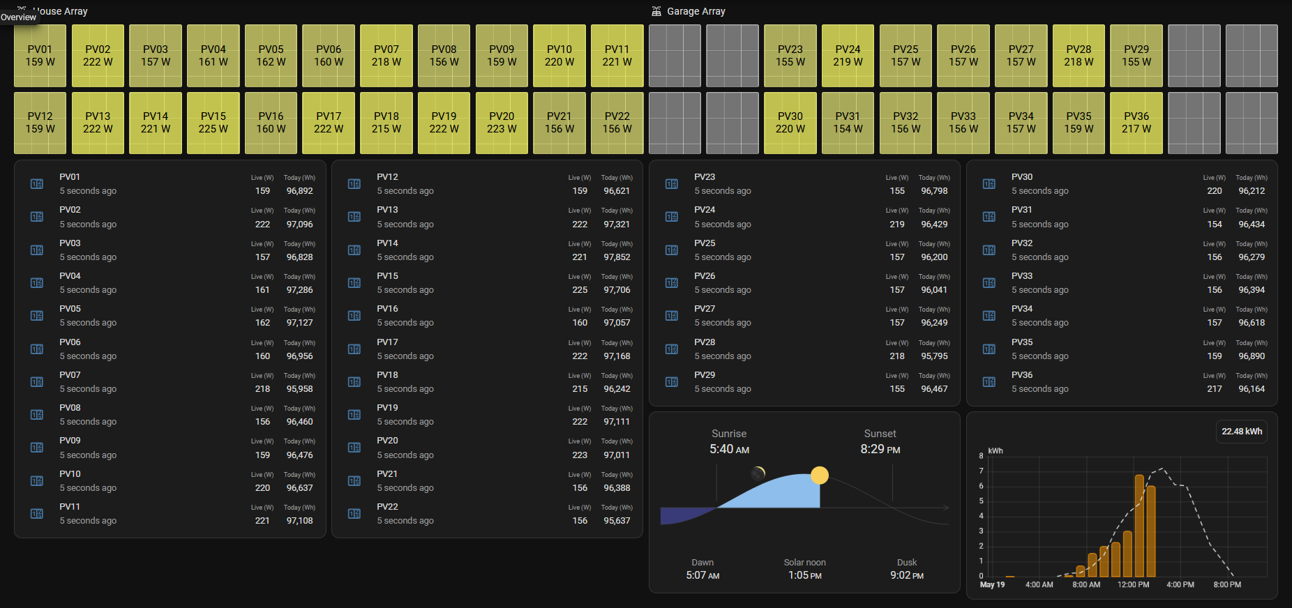

I'm getting erratic values for energy per panel. I created an integral sensor with left Riemann values per panel, and a corresponding utility meter sensor to track daily energy produced.
Some days it's spot on at about 2400-3000 Wh per panel. Other days I get these inflated values in the tens of thousands. (The total of 22.48 kWh in the lower right graph is correct.)
Any suggestions?

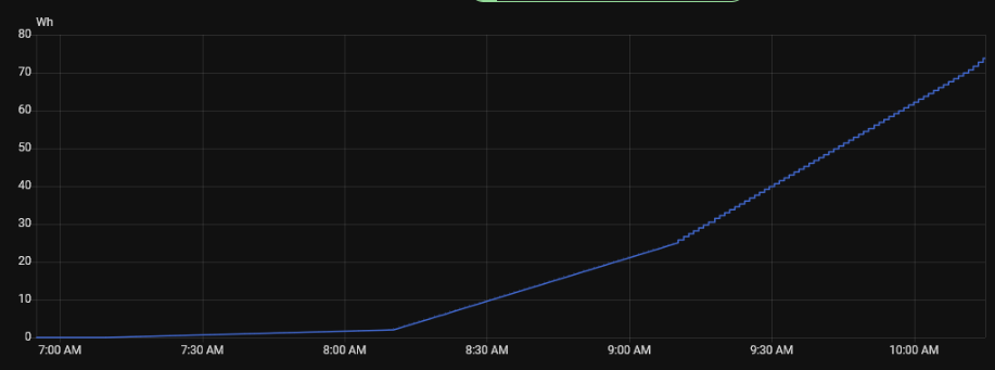

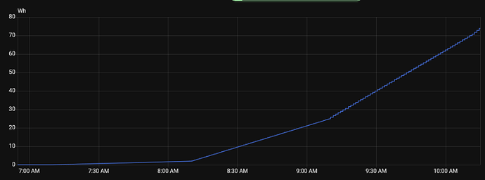

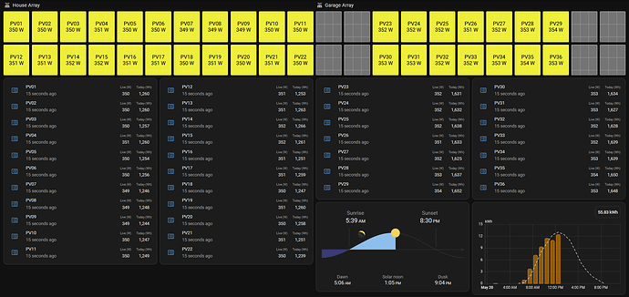

Here's an example of one panel tracking nicely through 10:15am today.

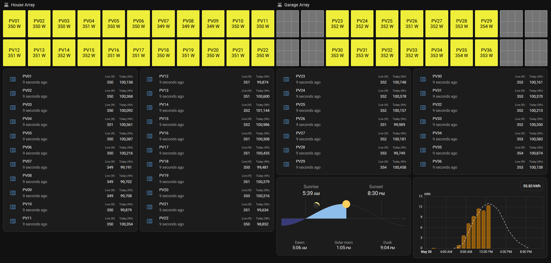

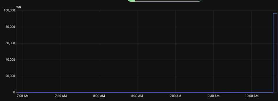

At 10:20am it jumps to 96,000 Wh.

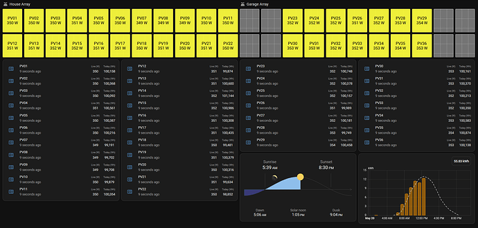

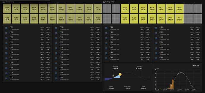

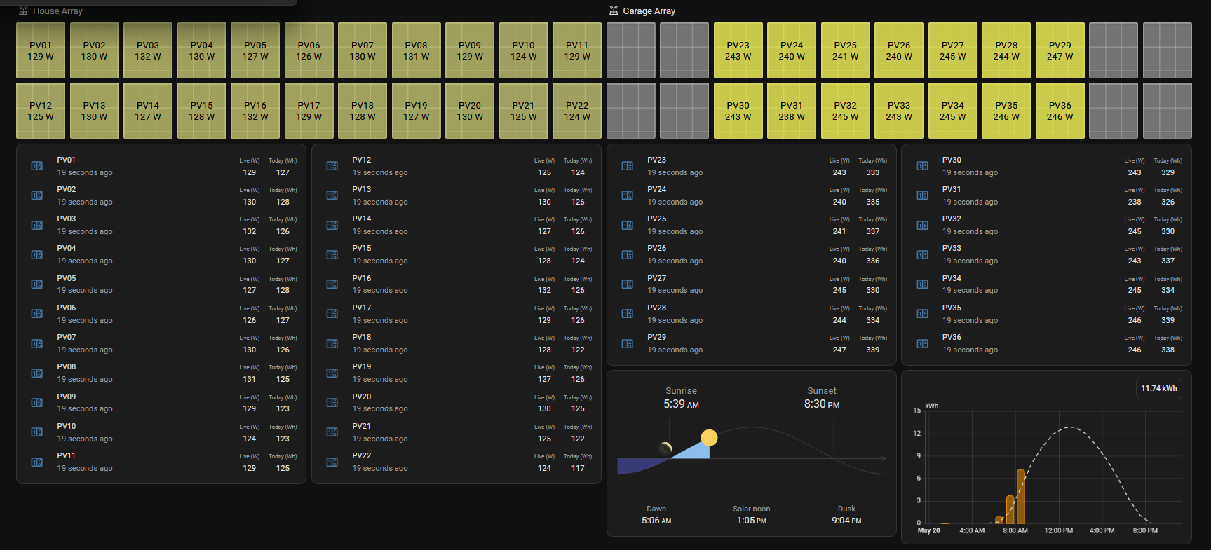

Decided to install the pending HA Core 2026.5.3 update. First poll of data after the restart did this:
Further research led me to some open issues with HA Core that may apply:
Utility meter - spikes in the history graph #165357
Some Sensors does not continue from the previous value after a reboot #165332
Integral integration: big jump (*1000) in calculated data on home assistant restart #136428
