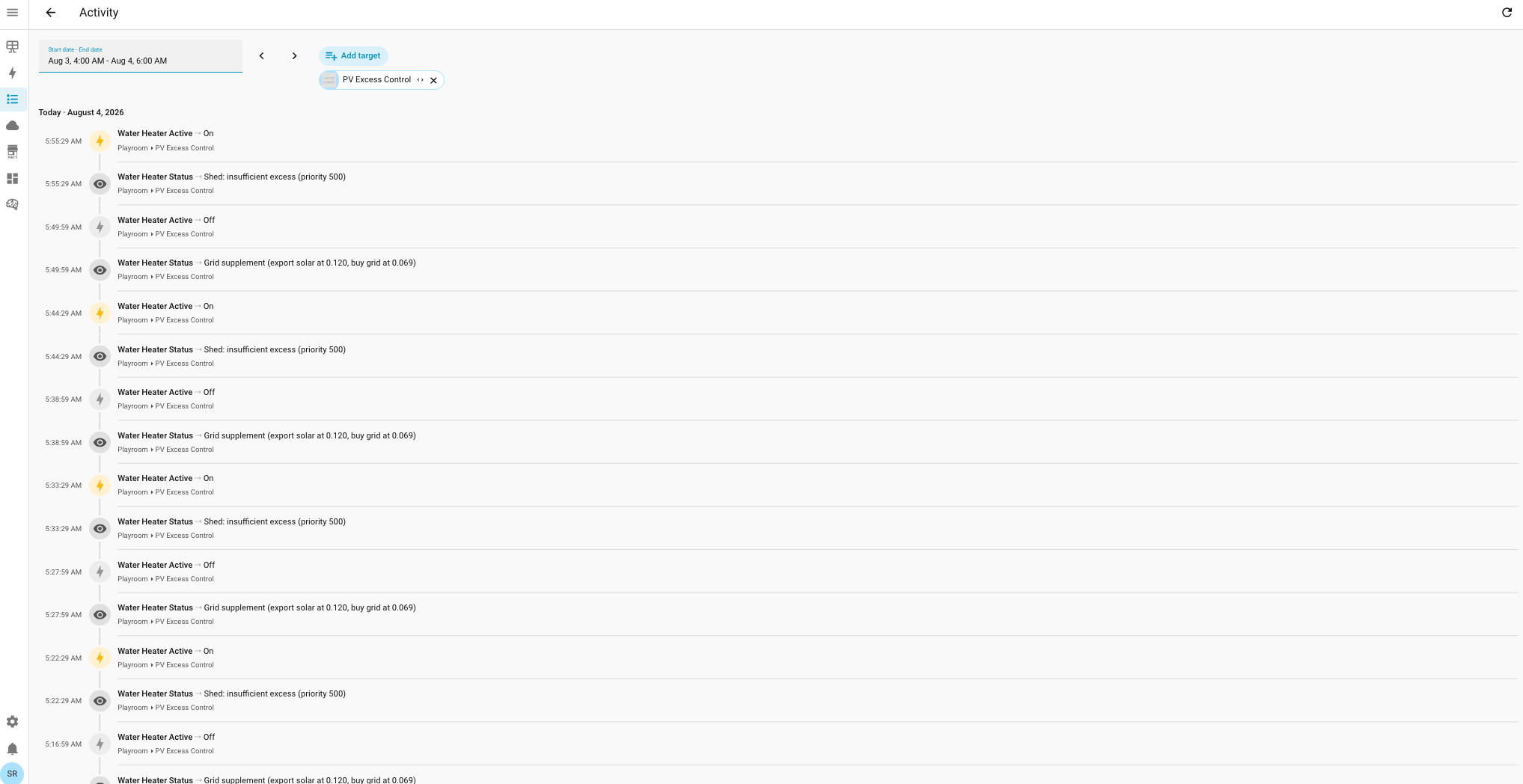

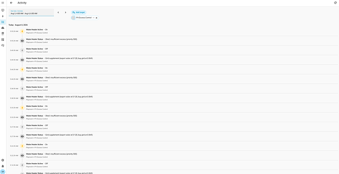

Hi there,
wonder if you can help here, I’ve been using the old Automation for many years and yesterday installed the new intergration. I’m using it to control my water heater and all seem to be working correctly as its configured to come on at 4:00am while the power is cheap, but for some reason the heater is only coming on for 5 minutes them switching off then coming back on after 10 minutes here is the activity log.
