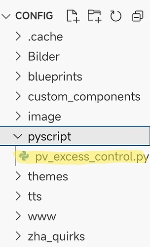

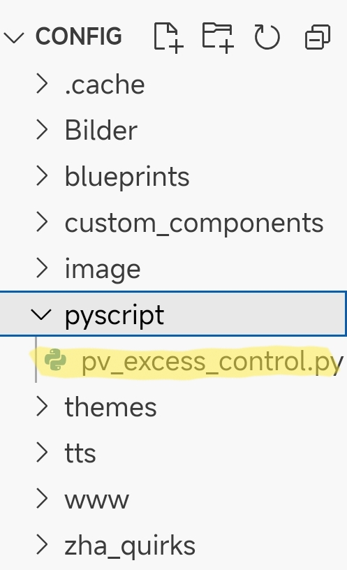

I activated pyscript in my config yaml and installed it with hacs too.
The Installation of this blueprint i did like its described.

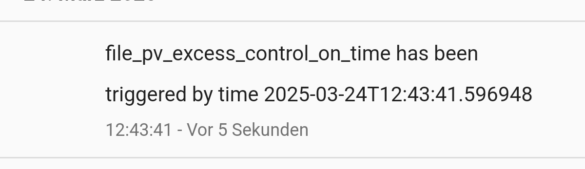

This is showing up in my log every minute
