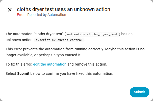

Im trying to install the Solar Excess Optimizer but every time i go to run the automation i get the error " The automation “cloths dryer test” (automation.cloths_dryer_test ) has an unknown action: pyscript.pv_excess_control .
I have installed Pyscript Python scripting and set it up
I have made sure the files are in the correct location
I have added the test to the configuration file (see below)
I have restarted HA
I have removed all files and started again
But i still get this error , im so sorry if im being silly here but im really really struggling
Please Please help…???

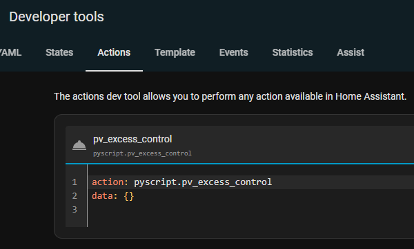

so that’s telling you the Automation cannot find the Action you want to run (pyscript.pv_excess_control)
As a first step check in Developer Tools in HA and see if you can see the action as per screenshot below…this will tell you whether the Pyscript side of things is there and at least narrow your troubleshooting.

@mogatuk1 have you managed to solve this? I have the same issue after every HA restart.
@Gav_in the "pyscript.pv_excess_control" action is available.
The issue have gone when opening and manually started the automation.
Unfortunately, after next restart, the same issue happens.
Thanks for any hint.
have the same issue since updateing HA to 2026.5.4.
The point to restart "run" the automation did not help on my system. I was wonderung what the error message is as I can not find an error entry in the log. debug looks normal...
Any help is welcome
it looks like that this helped for me... as now I do not get the error any more.
Open config/blueprints/automation/pv_excess_control.yaml and change this one line at the bottom:
# before
  - service: pyscript.pv_excess_control
# after
  - action: pyscript.pv_excess_control
Then reload automations via Developer Tools → YAML → Reload Automations and restart HA.
Since HA 2024.8 the keyword service: was replaced by action:. The blueprint hasn't been updated yet.
