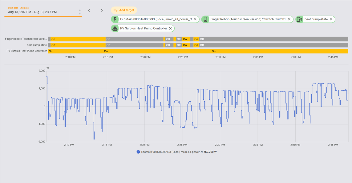

How it performs in practice
Here’s a typical sunny day at my place:
You can see the heat pump kicks in right when export ramps up, and shut s off as soon as surplus drops. No grid power used for heating that day.

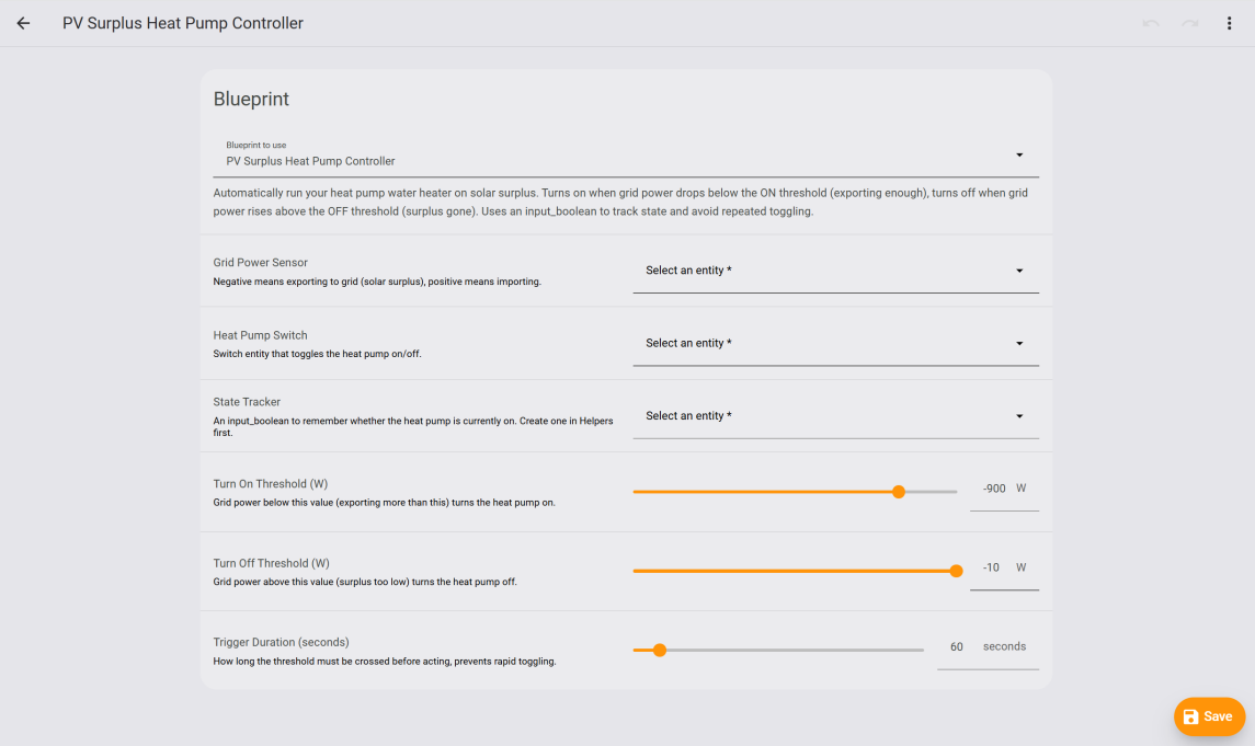

Configuration options
Option Description Default
Grid Power Sensor Your grid power entity
Heat Pump Switch Switch that toggles the pump
State Tracker input_boolean for state memory
Turn On Threshold Grid power below this = turn on -900W
Turn Off Threshold Grid power above this = turn off -10W
Trigger Duration Seconds the condition must hold 60s
Setup guide
  1. Create the helper—Go to Settings → Devices & Services → Helpers → Create Helper → Toggle. Name it something like “ Heat Pump PV State”.
  2. Import the blueprint—Click the Import button below, or paste the GitHub raw URL into Settings → Automations & Scenes → Blueprints → Import Blueprint.
  3. Create automation—Find “ PV Surplus Heat Pump Controller” in your blueprints list, click “ Create Automation”.
  4. Fill in the fields—Select your grid power sensor, heat pump switch, and the input_boolean you just created.
  5. Tune thresholds—Start with the defaults (-900W / -10W / 60s), adjust based on your heat pump’s power draw and how stable your solar output is.
