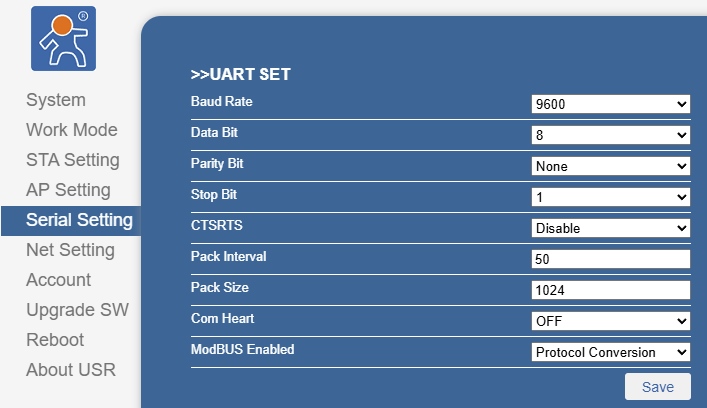

In case you are still interested I’ve managed to get this meter working with Modbus integration in HA and a wireless Modbus gateway. Details described here:
