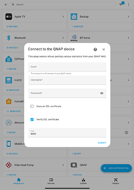

It has been the same problem since last week. I tried reconfiguring Qnap NAS integration, but that didn’t solve the problem.

Solved, now works for my setup. I changed the port number to 80 when it was 8080. Also if youre using Qnap firewall, check the rules, and make sure last one is ANY-to-ANY.
where do you change port? In Qnap or HA?
