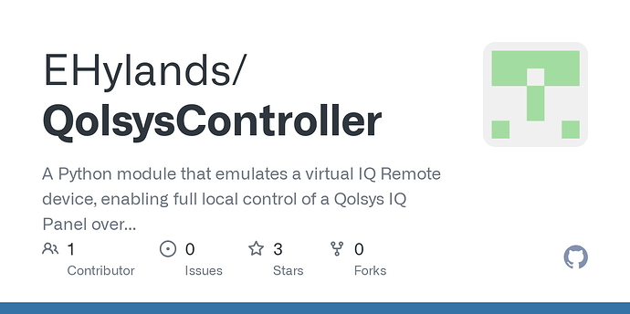

Bringing this old thread back to life!
The Control4 interface is pretty limited, so I’ve been experimenting since 2023 with the IQ Remote.
I’ve reverse engineered the pairing process, MQTT protocol, and command structure between the IQ Remote and the main panel. I’ve now used parts of qolsysgw and added pairing and mqtt commands that can:
• Pair as a virtual IQ Remote
• Control partition arming/disarming and view alarm state
• Read sensor status, tamper state, and battery level
• Pull panel diagnostic values
• Receive disarm photos and alarm video
• Chimes notifications
• Control Z-Wave devices
Looking for help with:
1. Testing the pairing process — can others reproduce it?
2. Triggering Z-Wave devices from a real IQ Remote, so I can log and decode the MQTT commands.
If you’re interested in testing or contributing, reply here
@EHylands so is that a completely standalone app - i.e. not running in AppDaemon or any existing environment? Sounds interesting overall.
For the moment it’s only a standalone python library as a requirement by Home Assistant for integration development.
The core logic is based on qolsysgw code. Integrating with App deamon or a dedicated Home Assistant integration would be trivial.
At first, the main goal is making sure the pairing process is effective.

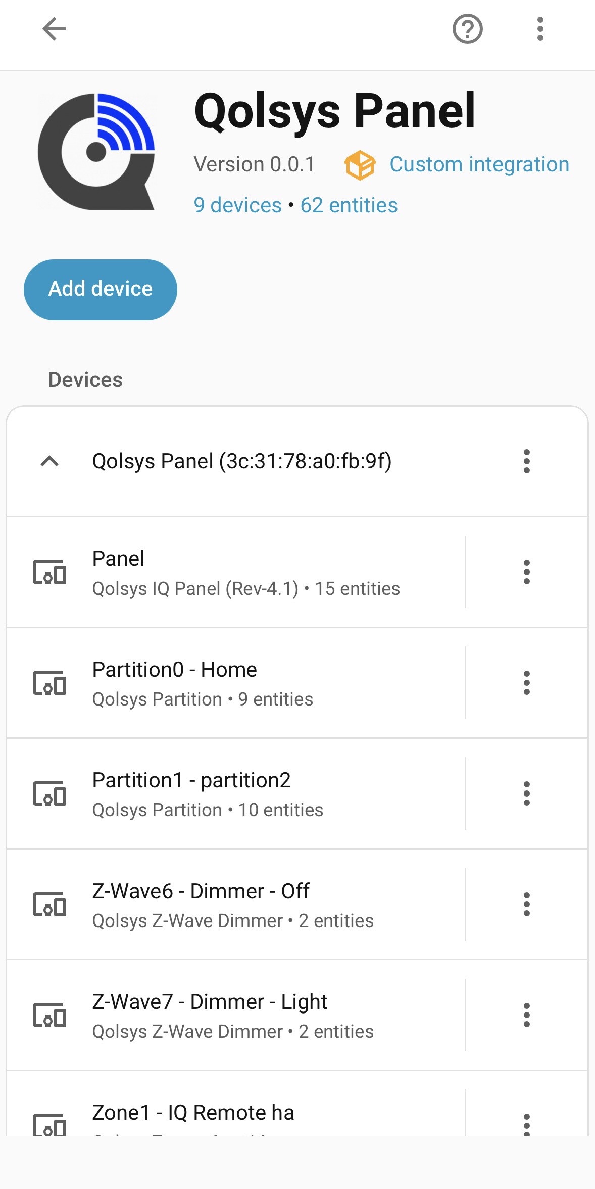

Qolsys Panel integration for Home Assistant

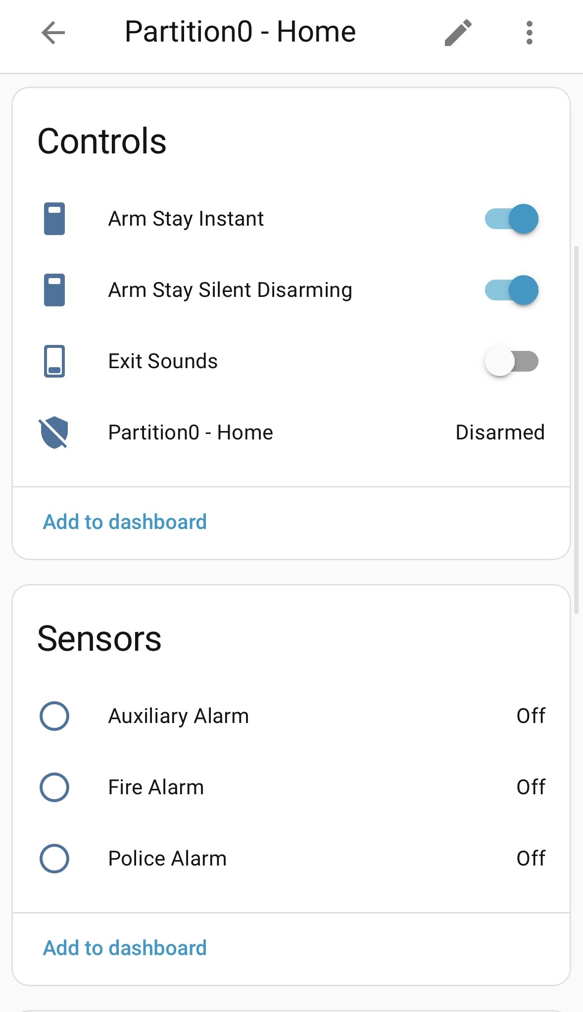

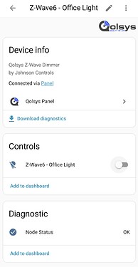

I’ve been working on a native Home Assistant integration for the Qolsys IQ Panel, and it’s ready for some beta real-world testing.

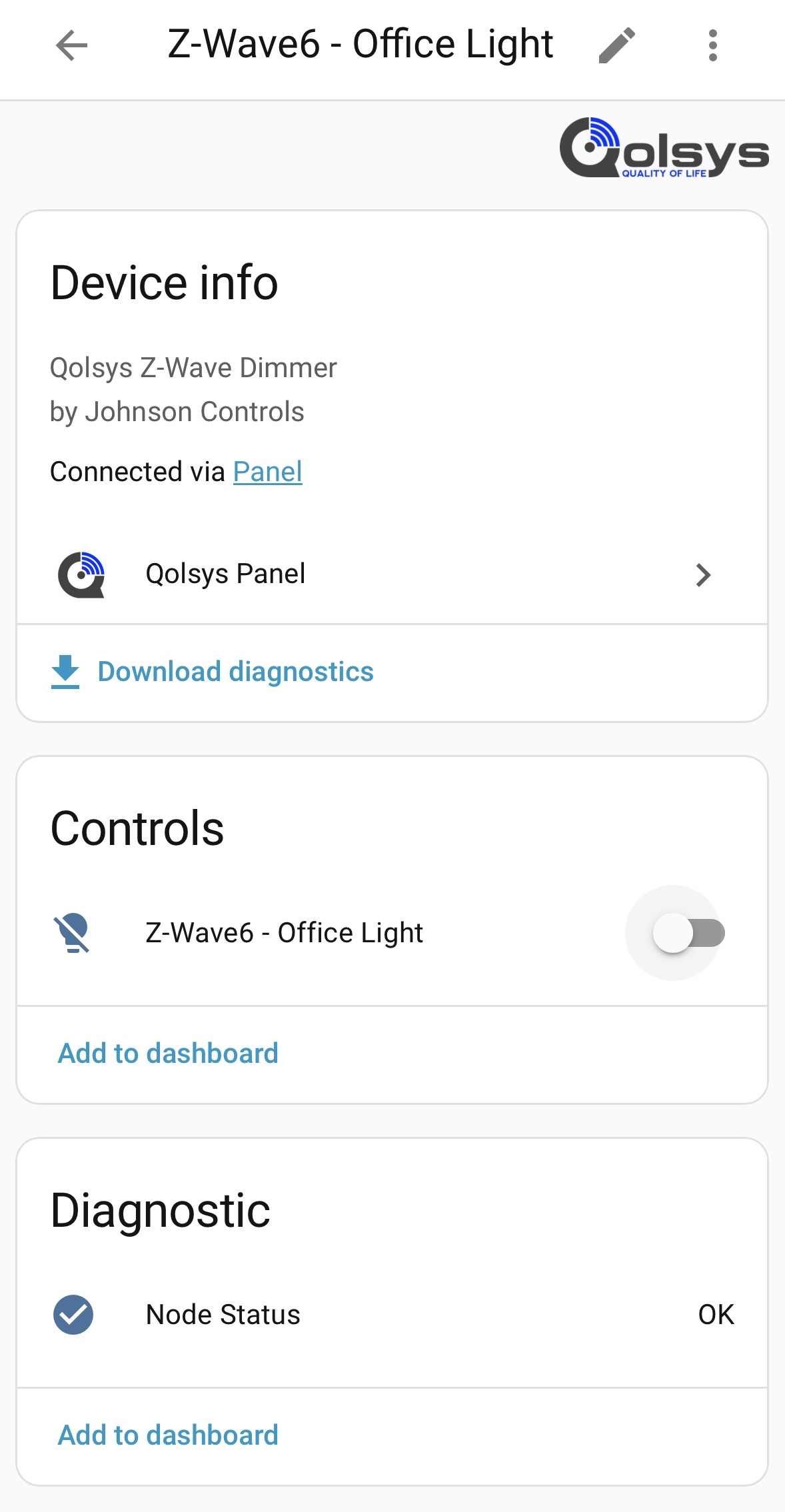

The current feature set is at least on par with what you’d find in the Control4 interface. On the Z-Wave side, here’s what’s supported so far:
  • Z-Wave Dimmers are fully supported
  • Z-Wave Thermostats are partially supported
  • Z-Wave device response time is noticeably faster on new IQ Panel 4 firmware 4.6.1
Important: Be sure to save a copy of your private key after successfully pairing with the panel. You’ll need it to reconnect or restore the integration later.
Project and installation details:
Let me know if you run into anything or have suggestions, all feedback is welcome.

If everything is rock solid on your side, I wouldn’t change anything for now. We are still ironing out a few bugs.

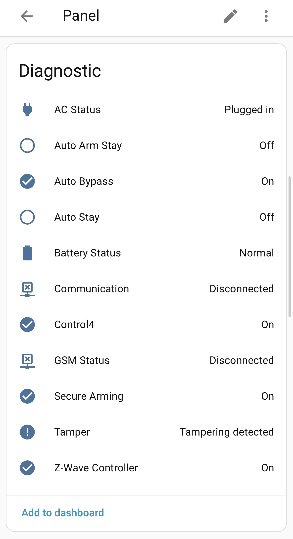

The main advantages of this version (not available on the Control4 interface) are:
  • Z-Wave device support
  • Night Mode for supported panels
  • Arm Home Instant
  • Silent Disarming
  • Exit Sounds
  • Diagnostics sensor
  • Temperature and light sensors for supported PowerG devices
Both integrations can run simultaneously, allowing for side-by-side testing and comparison. Control4 Integration and MQTT integration won’t share the same Home Assistante Unique ID.
