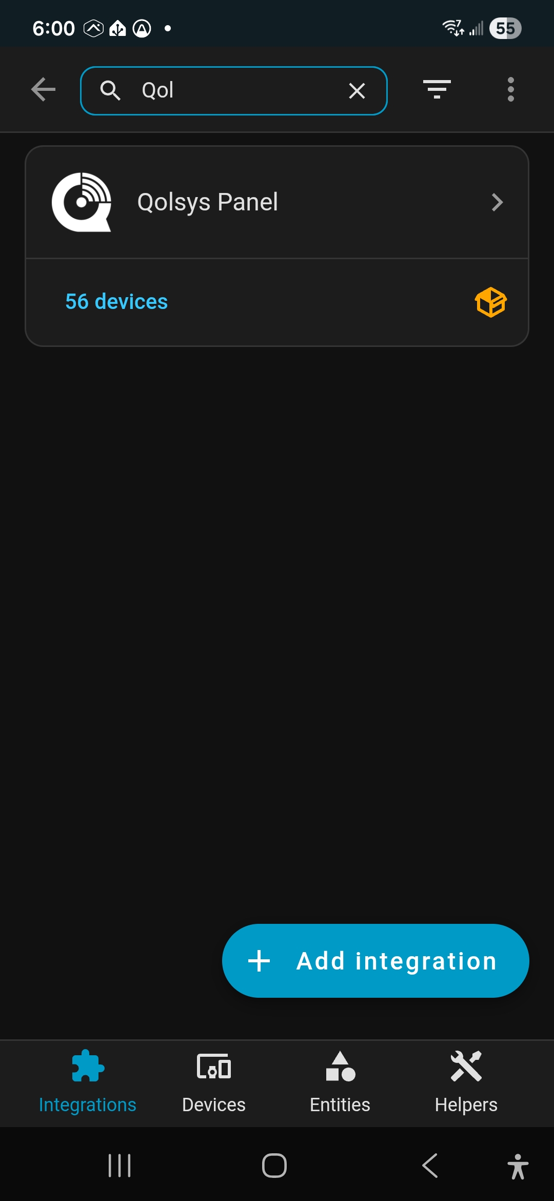

Just set this up a few days ago! Excited about the way you’ve figured out how to reverse-engineer the remote panel connection. It’s been working great so far. Still need to migrate automations to this integration
This project is absolutely fantastic!
I just got it installed and I’m genuinely impressed. Not only did it detect all of my devices flawlessly, but it even successfully integrated my smoke detectors, something I struggled with on the Qolsys Gateway project.
Huge thanks to the developers. I’m really looking forward to putting this through its paces!

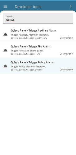

You can check with v0.0.22-beta.3 in HACS

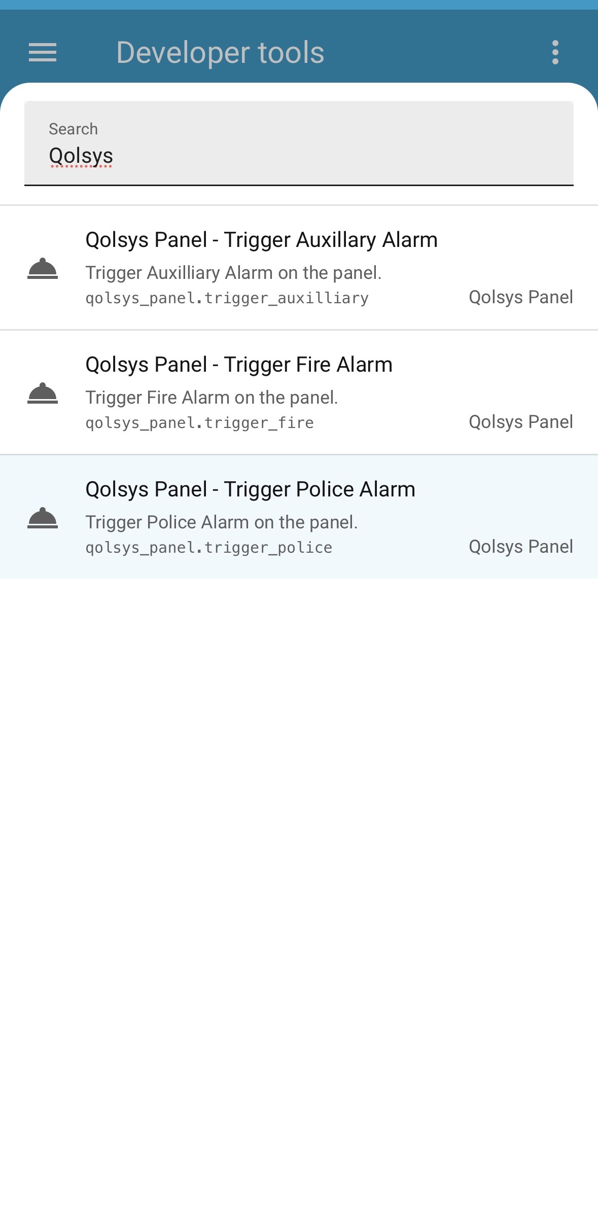

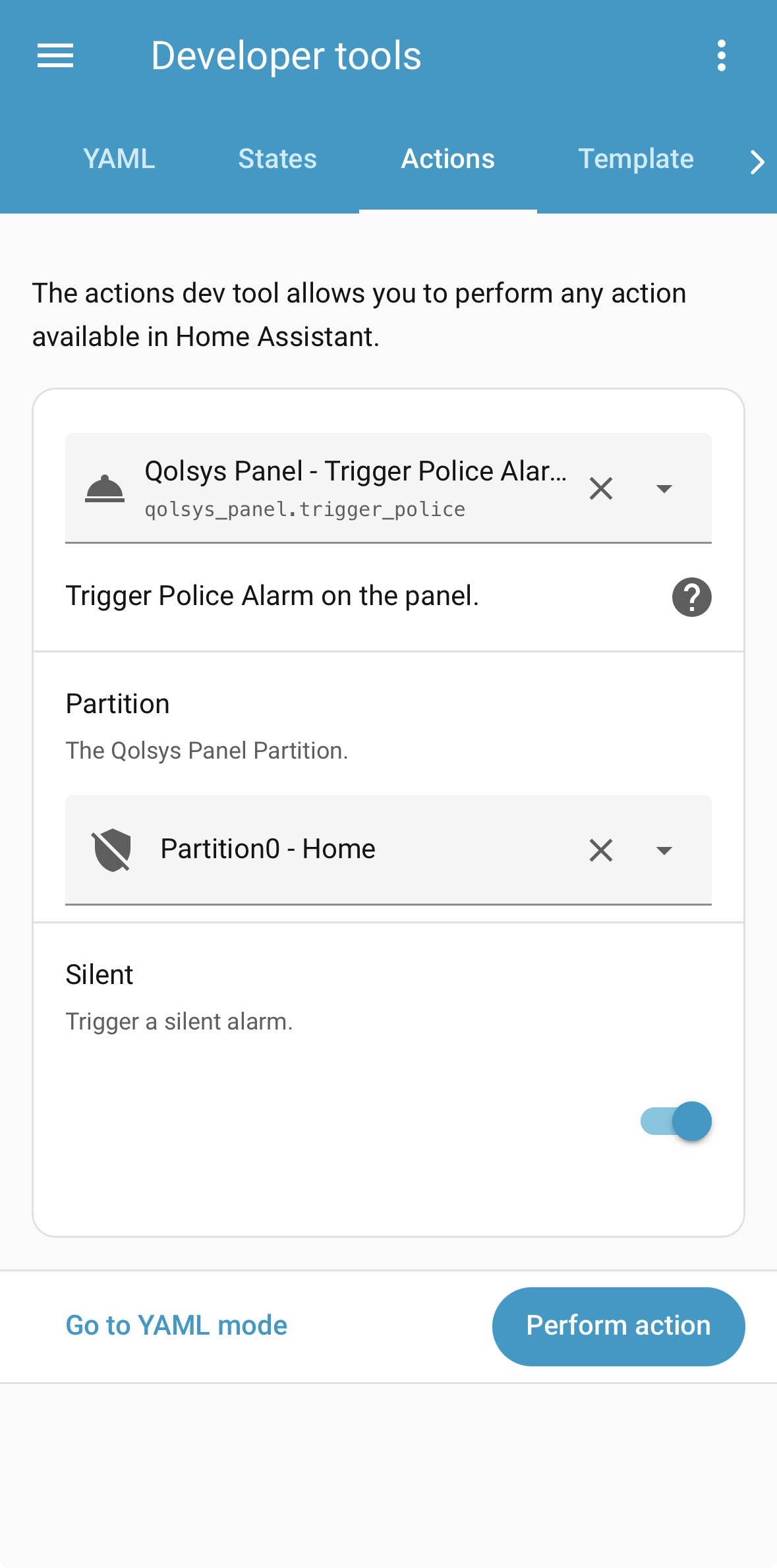

Added support to trigger Police, Auxilliary and Fire Alarm through integration linked services. Services need to be enabled on integration page options.

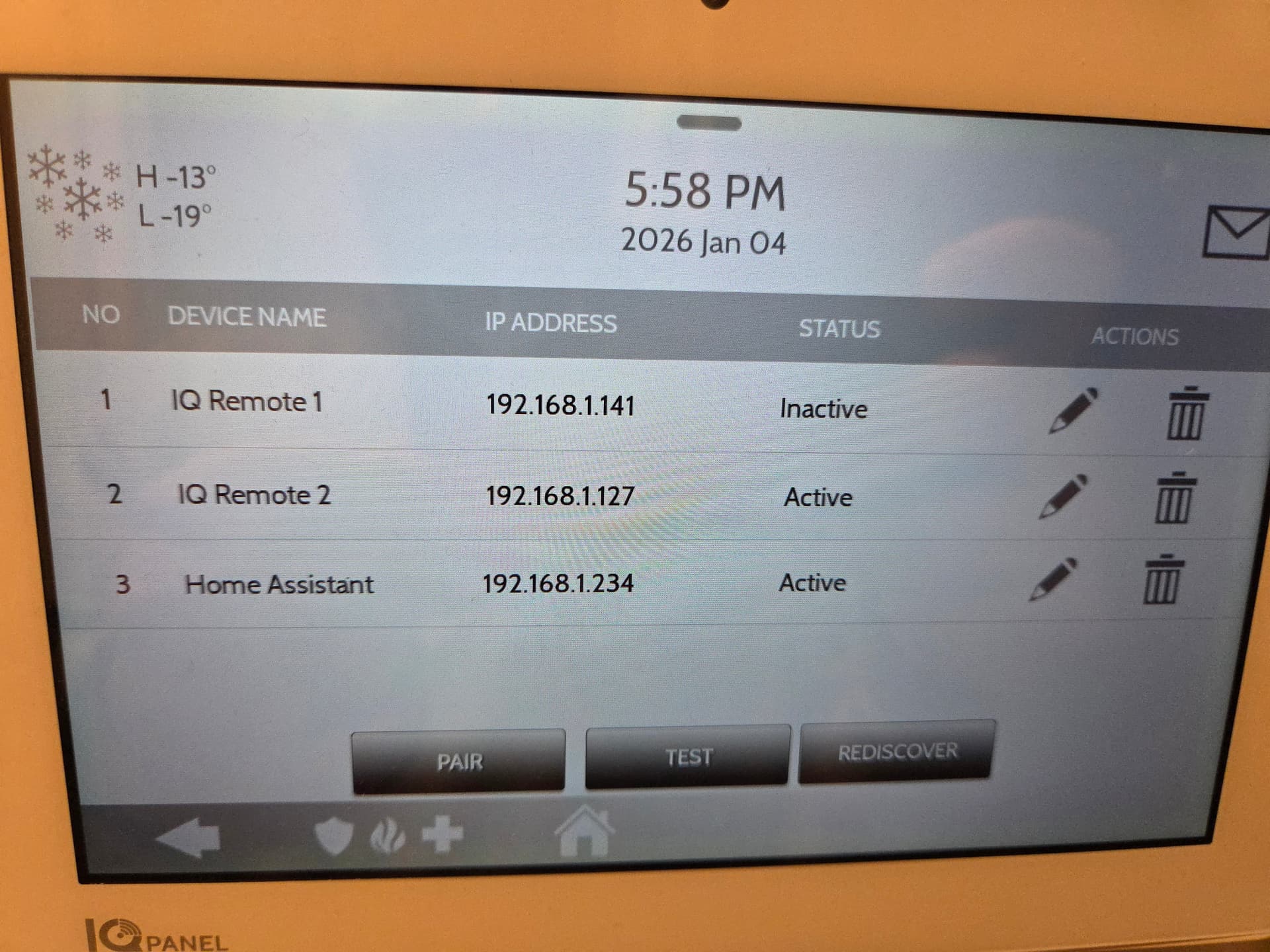

There seems to be a theoretical limit on how many IQ Remotes can connect to the main panel at the same time (3?).
One interesting thing I noticed: if you delete the Home Assistant virtual IQ Remote from the panel’s list, you can still connect using the client certificate that was already created. It doesn’t look like the main panel actually revokes the client certificate when the remote is deleted from the list.

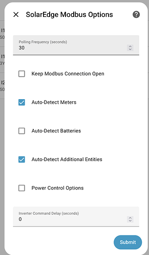

Just put them behind config flow option with a warning confirmation step. That’s what I do with power control options that can violate utility interconnect agreements for my solaredge-modbus-multi integration. Default off with a big warning to turn on. For anyone using alarm.com without central station monitoring such commands carry zero risk except for potentially scaring someone with a loud siren. For those that do have central station monitoring, well, they were warned.
Hi @WillCodeForCats,
Another user reported successfully pairing with the IQ Pro Panel through the installer app.

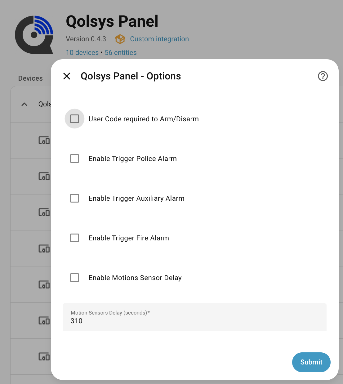

I’ve added configuration options to trigger alarm , fire , and auxiliary alarm through the options flow. I’ll also take a look at your integration to find the most appropriate way to include a disclaimer. :slightly_smiling_face:
So the way I did it is have one option to bring up the warning and on the next step with the warning those actually enable the thing being warned about.
User selects Power Control Options and then submit:
Then they get the warning and have to select which group to enable (in this case one is a battery group and the other is an inverter group):
If the user doesn’t choose one of the two enable options then the power control options on the first step does nothing by itself.
So for the IQ if I were designing it I would have the main option be “Enable Alarm Triggers” as the last option at the bottom of the list and then on the next step with the warning put the three options for enable police/fire/aux.
