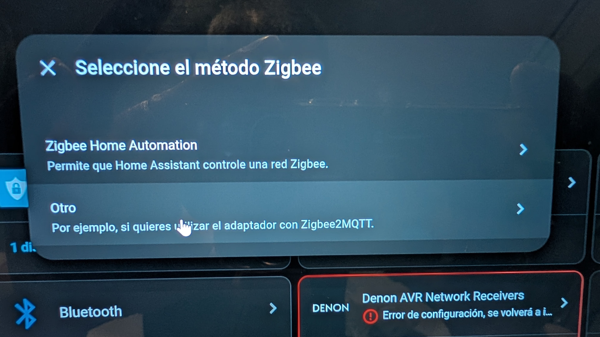

You mentioned trying everything except following the official migration guide. Have you tried that? https://support.nabucasa.com/hc/en-us/articles/29400665034397-Migrating-an-existing-Zigbee-Home-Automation-ZHA-network-to-Home-Assistant-Connect-ZBT-2

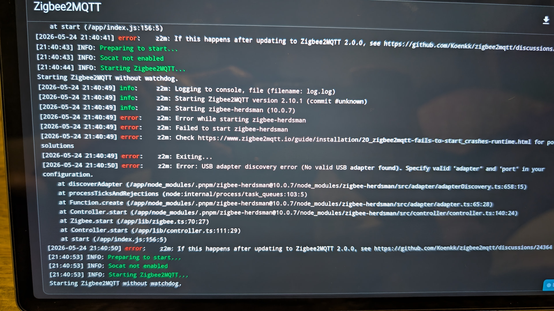

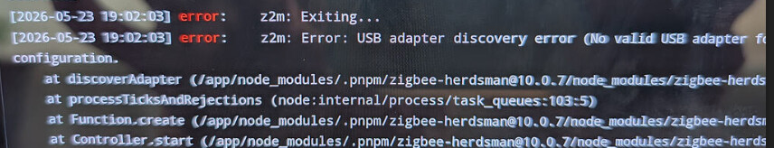

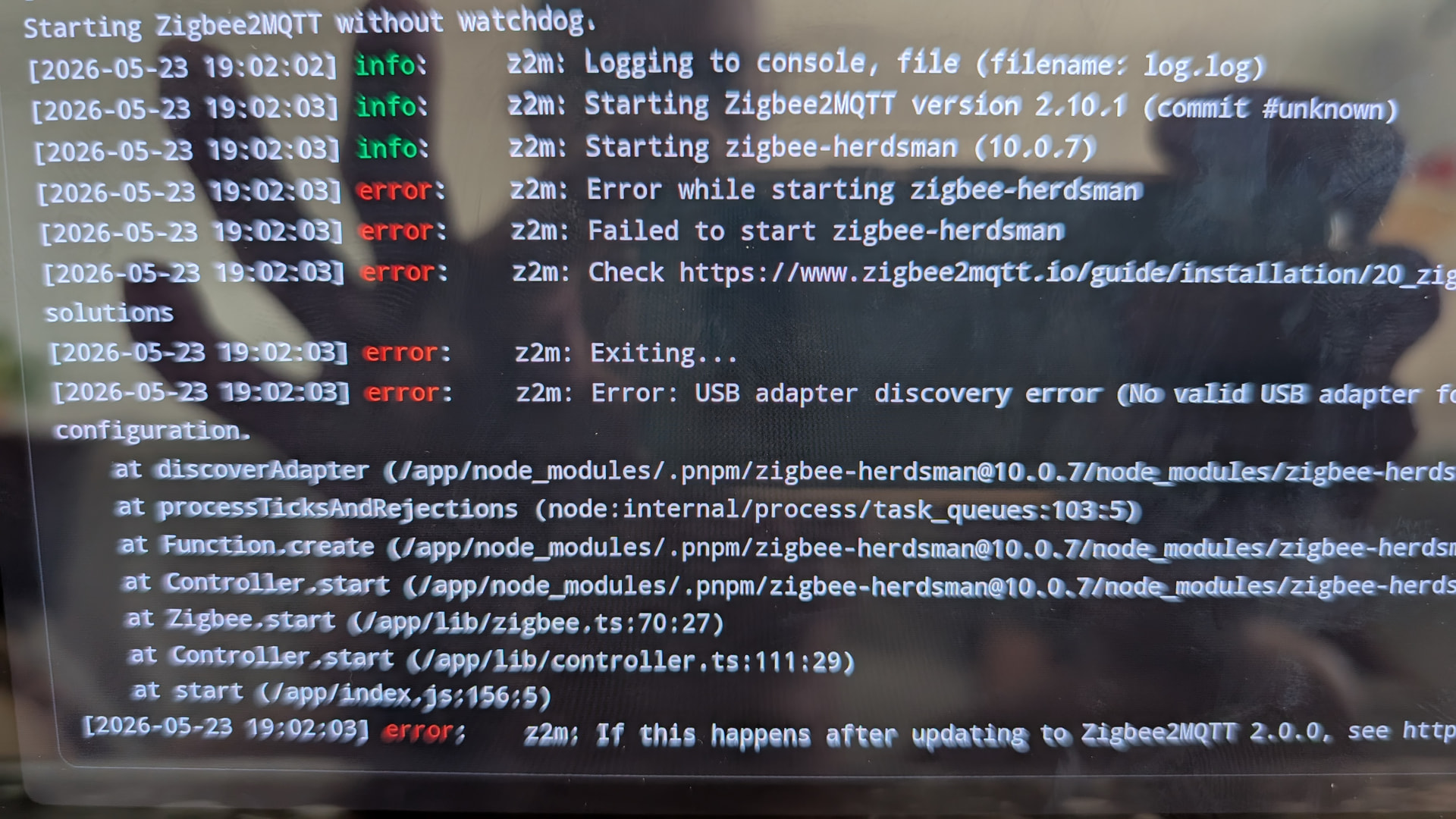

Yes, that too, in fact I've tried it again and it still doesn't work... I'm getting these errors...

You could have mentioned you were using Zigbee2Mqtt instead of ZHA earlier. That would have helped us immensely.
Look closer at the error screen. It's giving you a link to the Z2M troubleshooting page. Search there for the "No valid usb adapter found" error & how to troubleshoot it

Hello again, and thank you for your help. I'm sorry, but yes, I am using zigbee2MQTT, which I hadn't mentioned before. I'm following the same instructions as on the official website, the same steps, and in step 4 I select option 2, "custom." After removing the old device (Sonoff), I wait, but zigbee2MQTT doesn't start, and all devices are offline. I've restarted, but nothing has changed. I've also tried entering the address shown in system/Hardware/ttyUSB0/.... and in zigbee2MQTT/configuration/port/.... and in adapter/ezsp. I've restarted, but still nothing. I don't know where the problem is or what I'm doing wrong. Thanks!

I think the problem is not about migration (at least not just yet), but Z2M could not see or talk to the USB dongle.

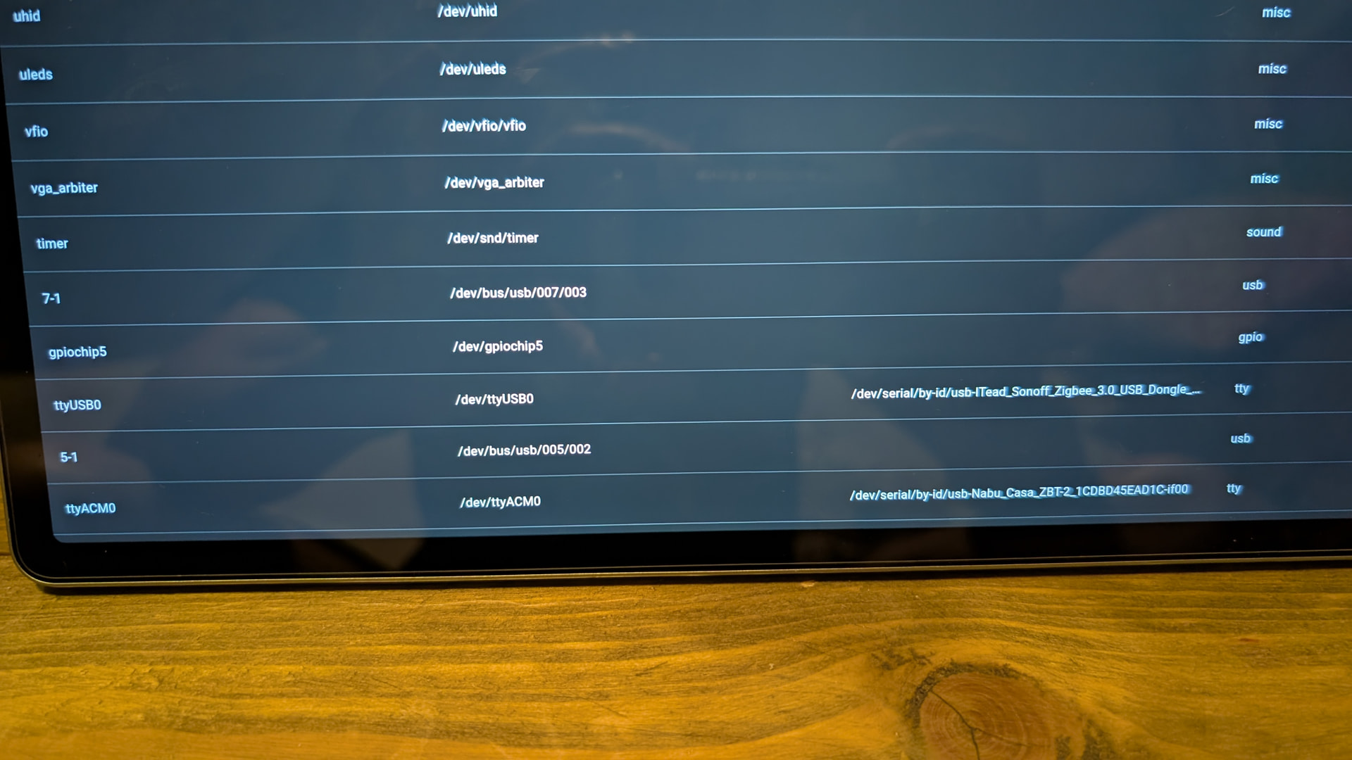

So, is there a way to check when you plug your ZBT-2 to the metal box, does the OS see the ZBT-2…?
Does both sonoff and ZBT-2 plugged into the same metal box that runs HA? Does the OS see both? Does HA see both?

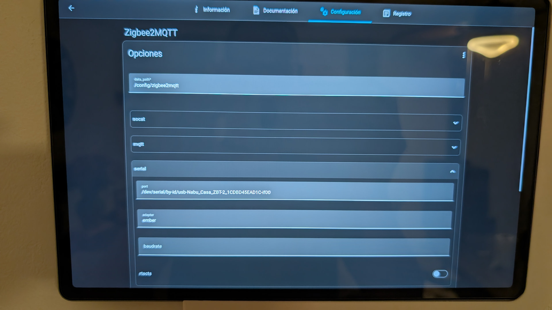

What have you tried exactly? Can you elaborate step by step (, instead of I follow xxx guide)? Give us some pictures / screen shots also.
Show us your current Z2M config, especially the serial section. That error you're seeing is referenced in the troubleshooting link you got, and it's specifically due to incorrect serial configuration. Zigbee2MQTT fails to start/crashes runtime | Zigbee2MQTT.

I just did it and it recognizes both devices

And that was why ShadowFist asking the question. Your zigbee dongles (sonoff and ZBT-2) are using different routes (this is good). But Z2M does not know which route to go so that to talk to different dongles. Please answer what ShadowFist asked above.

I'm not sure if one of the images answers the question the other person has; if not, please let me know. Thanks for your help.
