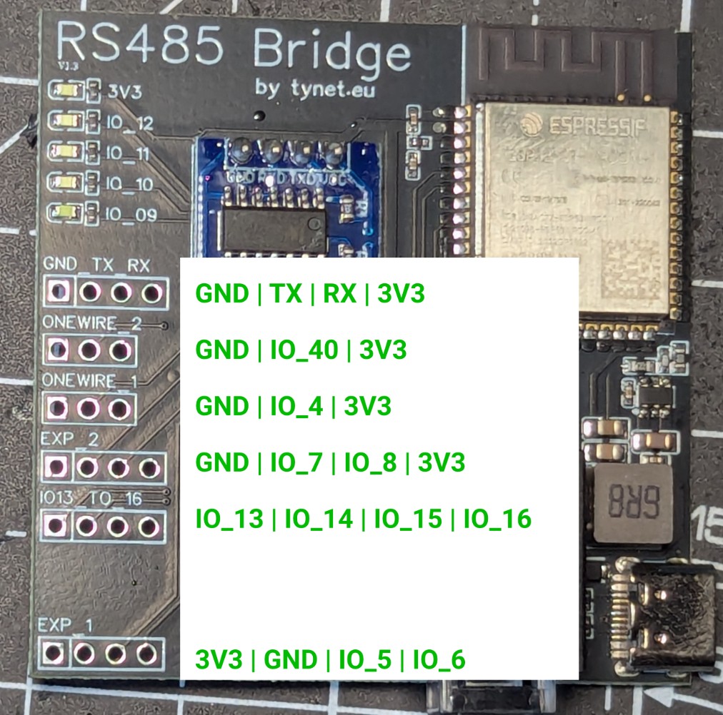

I have an ESP-RS485 board for a garage door opener.
The manufacturer uses the two RX/TX pins GPIO17 and GPIO18 internally for serial communication with the garage door opener.
They have also provided the two ESP32-S2 TX/RX ports GPIO43 and GPIO44 on their board as a user option for expansion.
I would like to use these two ports for a display (Nextion).

Is it possible that if I’m already using both hardware RX/TX ports, I won’t be able to connect or use a 433 MHz transmitter and receiver at all?
I would connect the 433 MHz transmitter to GPIO07.
I still have GPIO pins 13, 14, 16, and 16 free.

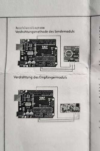

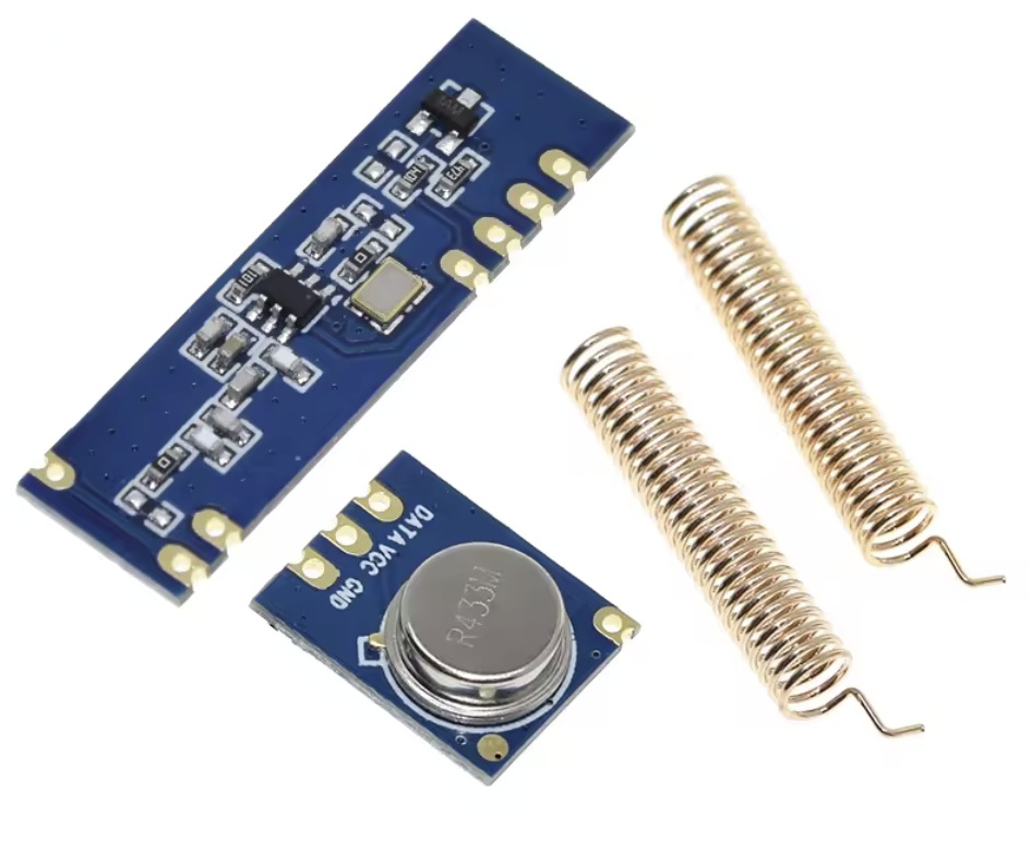

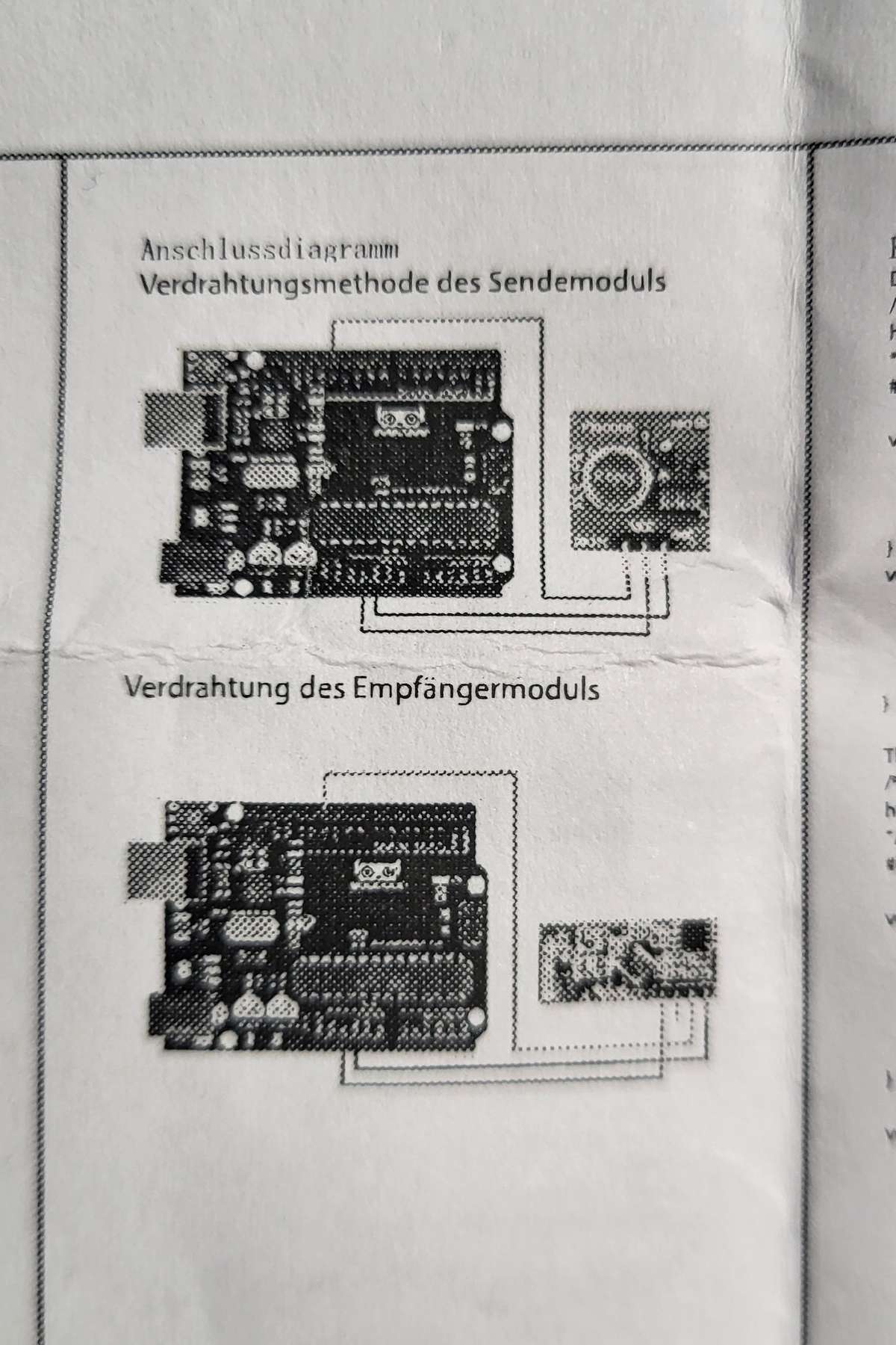

It’s actually just a simple 433MHz transmitter and receiver module that I’m using.
I was just confused when I read something about TX/RX in the manufacturer’s documentation.
They use sample code for an Arduino Uno, and it uses a virtual UART library… that’s why I thought you had to use an RX/TX pin or a soft-water serial port for these 433MHz modules.
I’ve never seen this in any of the ESPHOME examples for 433MHz transmitters and receivers.

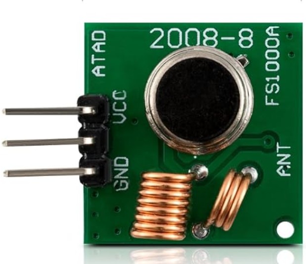

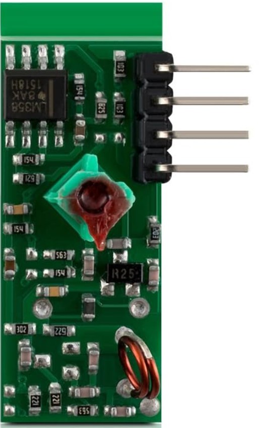

That transmitter is decent, but throw that receiver as fast as you can in the trashcan.
the receiver is the most important component right now, and only once.
In need him onle 1 time…
I need to read a 433 MHz remote control with this component so that I can then use the transmitter to send the code via my ESP.
So I only need the receiver once.
Is it really not suitable for this one time?
I’ve noticed that I get what feels like 10,000 characters when I press just one button on the remote control.
I hope this isn’t the receiver’s fault.
What can I do?

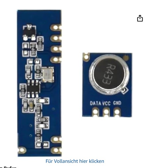

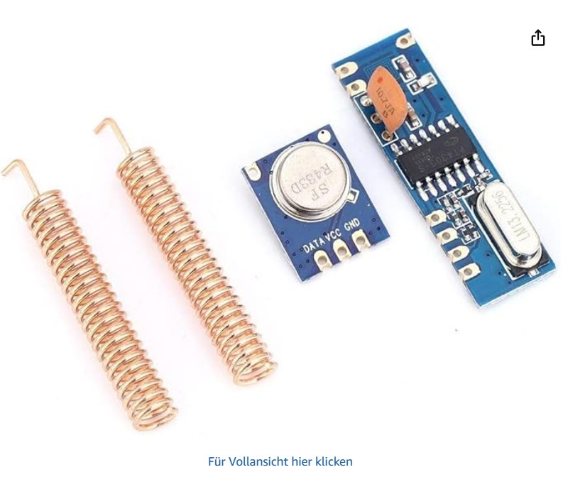

I’ve been looking for 433 MHz modules like the ones you recommended.
I’ve found some interesting ones.
So, these are the STX882 transmitter + SRX882.

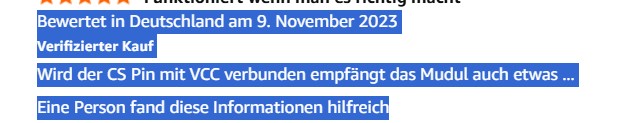

A user who reviewed them on Amazon said that they work correctly when the VCC pin is connected to the CS pin…
those were the Rockyin STX882 transmitter + SRX882 modules.
I also found the
QIACHIP Wireless RX480E Transmitter & Receiver 433 MHz Modules…
they have the most positive reviews.
Almost 200 users can’t be as wrong as just 5.
I’ve attached some pictures.

There are many decent devices available for $1/pc. They are all better than mx-05v.
https://aliexpress.com/item/1005003436580019.html
But you got decent reception from yours, don’t hurry to buy new ones if it’s just one time approach.

Here’s what I did:
I now have the SRX882 and STX882 modules, which @LutzDe recommended above.
I also tested these two modules with a Tasmota-flashed ESP8266 to determine the pulse length.
This was the output when pressing the “+” button on the Vevor diesel heater’s remote control:
23:26:43.409 MQT: tele/tasmota_723F18/RESULT = {"Time":"2025-10-29T23:26:43","RfReceived":{"Data":"0x1C5E08F0","Bits":32,"Protocol":1,"Pulse":255}}
The pulse length was identical for “-”, “ON”, and “OFF”. It was always 255.
I then converted the received data using a hex-to-binary converter and compared it to my previous values.
They all matched.
I then inserted the converted binary codes with the pulse length into ESPHome, and lo and behold, everything works perfectly.
The transmit and receive performance of the STX882 and SRX882 modules is excellent.
