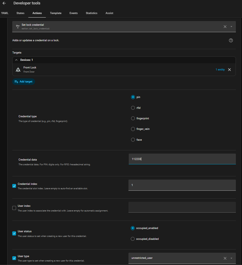

So I did some digging... In Developer Tools -> Actions
action: matter.get_lock_users
  device_id: d9c98a7b47430bce9165fe3111111111
data: {}
returned
lock.front_door_front_lock:
  max_users: 10
  users:
    - user_index: 1
      user_name: ""
      user_unique_id: null
      user_status: occupied_enabled
      user_type: unrestricted_user
      credential_rule: single
      credentials:
        - type: pin
          index: 1
      creator_fabric_index: 3
      last_modified_fabric_index: 3
      next_user_index: null
Additionally
action: matter.get_lock_info
data: {}
returns
  supports_user_management: true
  supported_credential_types:
    - pin
    - rfid
    - fingerprint
  max_users: 10
  max_pin_users: 34
  max_rfid_users: 34
  max_credentials_per_user: 34
  min_pin_length: 4
  max_pin_length: 8
  min_rfid_length: 10
  max_rfid_length: 80
action: matter.get_lock_credential_status
  entity_id: lock.front_door_front_lock
  credential_type: pin
  credential_index: 1
then
action: matter.set_lock_credential
  credential_index: 2
  credential_data: "99887766"
gave me a positive result
  device_id: d9c98a7b47430bce9165fe32df996bb1
  credential_index: 2
  credential_data: "6208182"
And the PIN WORKED.
Okay, let's unhook it from HomeKit, that results in removing the first pin code. But the 2nd still worked.
There are a few experiments with PIN management. I would not recommend any but you can check out raman325/lock_code_manager: Lock code manager for locks integrated with Home Assistant or add in HACS "Lock Code Manager"
bottom-line
You can manual set PIN codes using the Developer Tool and Action without connecting to HomeKit.

for others, I’m am only trying to amplify what D-Jeffrey has discovered:
  1. Remove the lock from any other apps. My first lock (to use this process) still showed up in Apple Home even though it wasn’t a matter over thread lock anymore. i tried to remove the lock several times and each time it appeared to be successful but it was still there in Apple Home. I then deleted the room the lock was located in. Waited a couple of minutes, closed, opened Apple Home and it was gone.
  2. Remove the lock from kwikset app.. (This forces factory reset of the lock)
  3. Pair the lock using the kwikset app all the way to selecting Matter.
  4. Pair directly to HA using matter integration (AI suggested that I pair directly to HA instead of pairing first to Apple Home, which is what I typically do)
  5. Use Developer Tools ACTIONS to set credentials. Minor changes/tweaks I had to make to D-Jeffrey’s code images above: Setting the Passcode via matter.set_lock_credential
    A. Execute the action In Developer Tools > Actions, select matter.set_lock_credential.
    B. Switch to UI Mode (if it defaults to YAML) and configure the following fields:
    C. Target: Select your Kwikset Halo Select lock entity.
    D. Credential Type: Select PIN.
    E. Credential Data: Type the numeric passcode you want to set (e.g., 56789).
    F. Credential Index (Optional): Type 2 (This maps specifically to your second code slot index, preserving your master calibration pin).
    G. User Status (Optional): Select occupied_enabled to ensure the slot goes live instantly.User
    H. Type (Optional): Select unrestricted_user so the passcode grants full access at any time of day.
    I. Click the green Perform Action button
  6. Physically test the new code on the lock’s keypad.

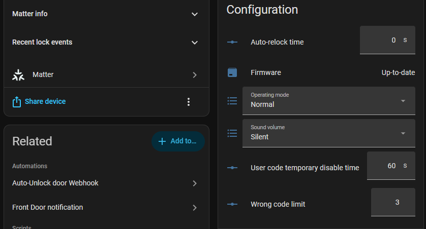

The only thing I can’t find any mention of is if you can enable/disable the auto lock feature from Matter/HA or if I would need to use the Kwikset App? I’m looking to add one on my back patio and maybe even replace my Eufy front door lock as I can’t rekey it to match all my other locks. But when I have friends over I like to turn off the auto lock so people aren’t getting locked out every few minutes.
Sorry to ask another question in this thread but since the title is more generic about these locks I figured I would ask here instead of starting a new thread.
You can control the re-lock within the native controls of matter device settings. (0 s - disables that function).
