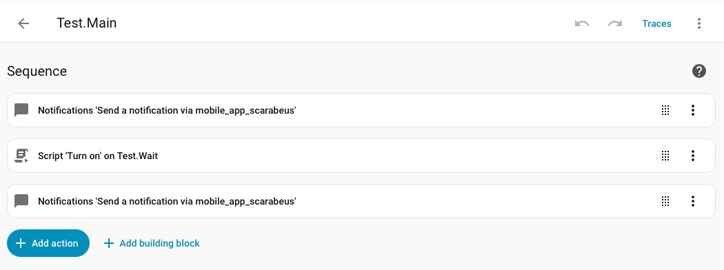

I’m struggling with the return of a nested script calling, and the resulting time line.

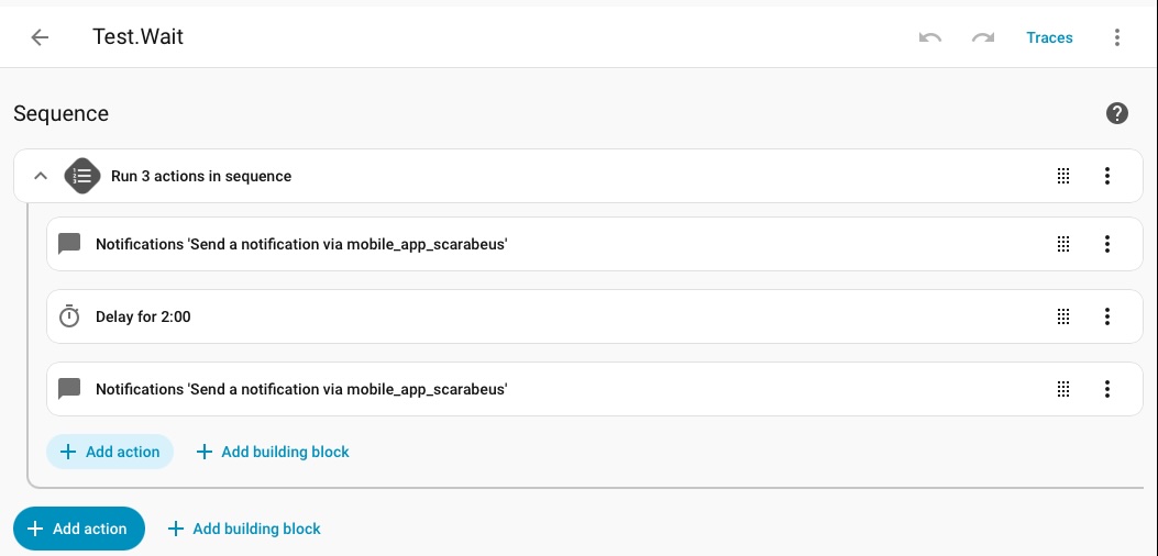

To break it down I created two test scripts: Test.Main and Test.Wait - see images. In both cases I use HA notifications to trace the time line.
Expected: Execution of Test.Main should terminate after the call of Test.Wait is done - so in my scenario after 2 minutes.
Real result: I get immediately the Start of Test.Main, the End of Test.Main and the Start of Test.Wait. After 2 minutes I get End of Test.Wait.
I understood the documentation, that the flow in Test.Main is “waiting” until Test.Wait is finally executed, but this seems to be wrong.
Even moving the notifications and the wait-command in Test.Wait into a sequential block does not change anything.

There are two ways to call a script. One waits for completion of the script the other does not - this is the one you are using. See: Scripts - Home Assistant
Use:
action: script.test_wait # scripts are also actions
Not:
action: script.turn_on
  entity_id: script.test_wait
