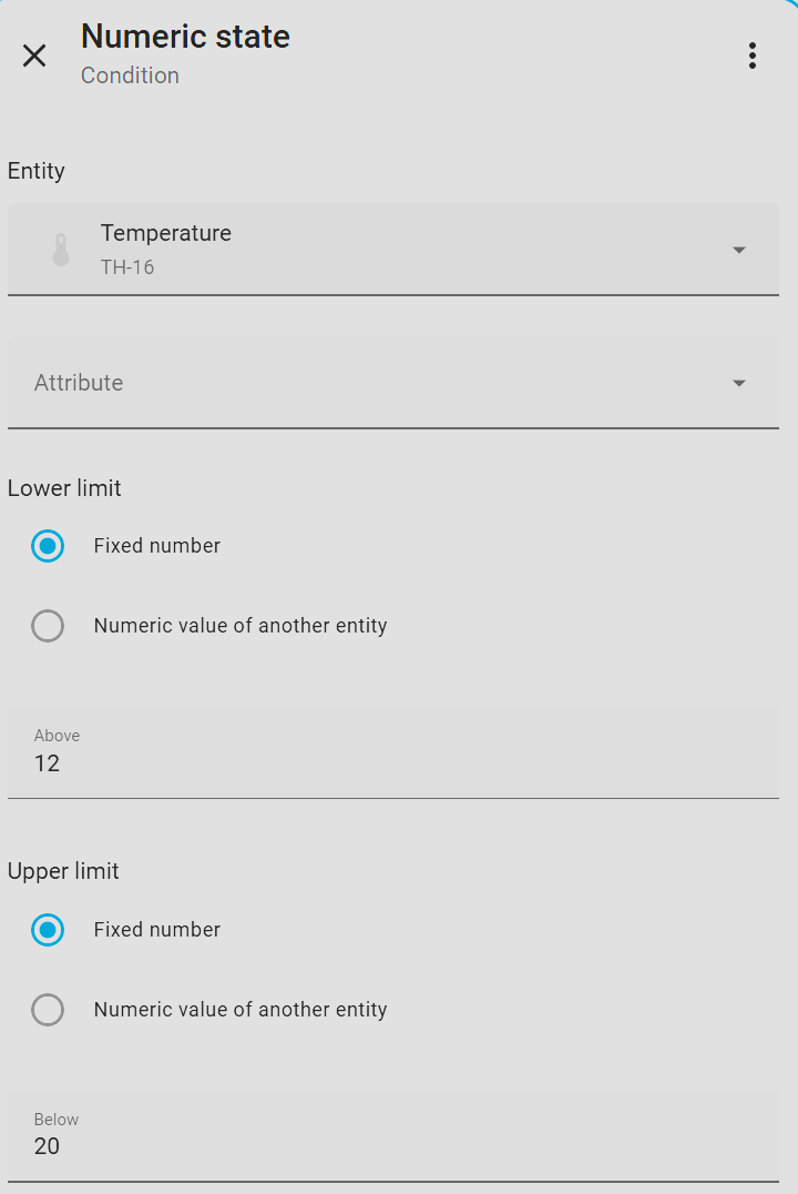

I have a Temp sensor and I want to use it in a trigger with multiple ranges
the first one is > 12, < 20
the second one should be >= 20 , < 30
In the configuration for events I do have above and below
but they are > and < :slight_smile:
How do I get >=?
Sounds very weird to me we cannot do it in the config :slight_smile:
