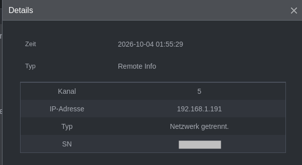

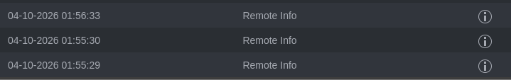

Since I have also integrated the Reolink doorbell with my Dahua NVR, I can see in its logs that the doorbell disconnected around 2:00 AM (Note: In this case, the time on the NVR and HA is not 100% synchronized.) :laughing:
with a user logout occurring - and then, about 60 seconds later, a user login took place once the camera became available again after rebooting.
01:55:29 = Disconnected
01:55:30 = User logout
01:56:33 = User login
In other words, rebooting the Reolink Doorbell Wi-Fi (in my case) takes about ~ 60 seconds. I’m wondering if that timeout period - which currently seems to be set to something under 30 seconds - could or should be increased to, say, 60 seconds plus a margin, so that these error messages don’t pop up “immediately” during brief connection drops, such as this maintenance reboot.

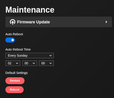

Do you actually need that Auto reboot toggle enabled? What could go wrong if you disable it?
That’s a good question. :slightly_smiling_face: I’ve actually always had the settings for a weekly (maintenance) reboot enabled on all my cameras (various Dahua models and the Reolink Doorbell) as well as on my Dahua NVR. I can’t really say whether the RAM might otherwise fill up or something similar without this (maintenance) reboot, because I’ve never given it any thought or tested it out. But I assume the manufacturers had a reason for including it - otherwise, it wouldn’t be enabled in the default settings. :thinking:
My best guess is that it’s enable by default so that if a support issue comes along, the customer service guys don’t have to ask if the camera was rebooted (and the eventual lies from the customers who say it was when it wasn’t).
There’s a thread over on reddit about it here. A couple of scenarios are absurd, but most of the rest make sense. I suggest you either disable the auto reboot function entirely for a few weeks, or at least change the default reboot time.

But let me put it this way: I’ve been using IP cameras here for about ~ 15 years now, and this (maintenance) reboot is enabled by default on all of them - and I’ve always just left it that way. I’m not going to change anything about it now, just because of the error message from the Reolink Doorbell/Integration in the HA log. It’s not that important to me. :slightly_smiling_face:
There isn’t much to change there. You can only select the day of the week and the time for the reboot to take place, but you cannot, for example, specify that the reboot should occur only once a month (or something similar).
