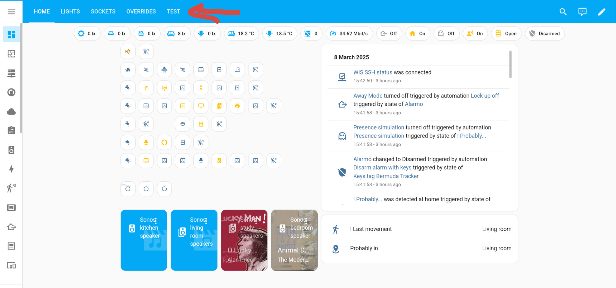

Firstly, “sections” refers to the layout style of the dashboard. “Dashboards” are main displays accessible through the menu on the left, and sub-dashboards are “views” (arrowed below).
To set up navigation from a badge:
  • Go to edit mode (pencil icon top right)
  • Go to the badge you want to edit and click on the pencil icon that appears when you hover over it.
  • In the Interactions field, select Tap behaviour and Navigate
  • In the Navigation path field you should get a dropdown list of dashboards and views you can navigate to.
For historical reasons, the dashboard names all begin with Lovelace.

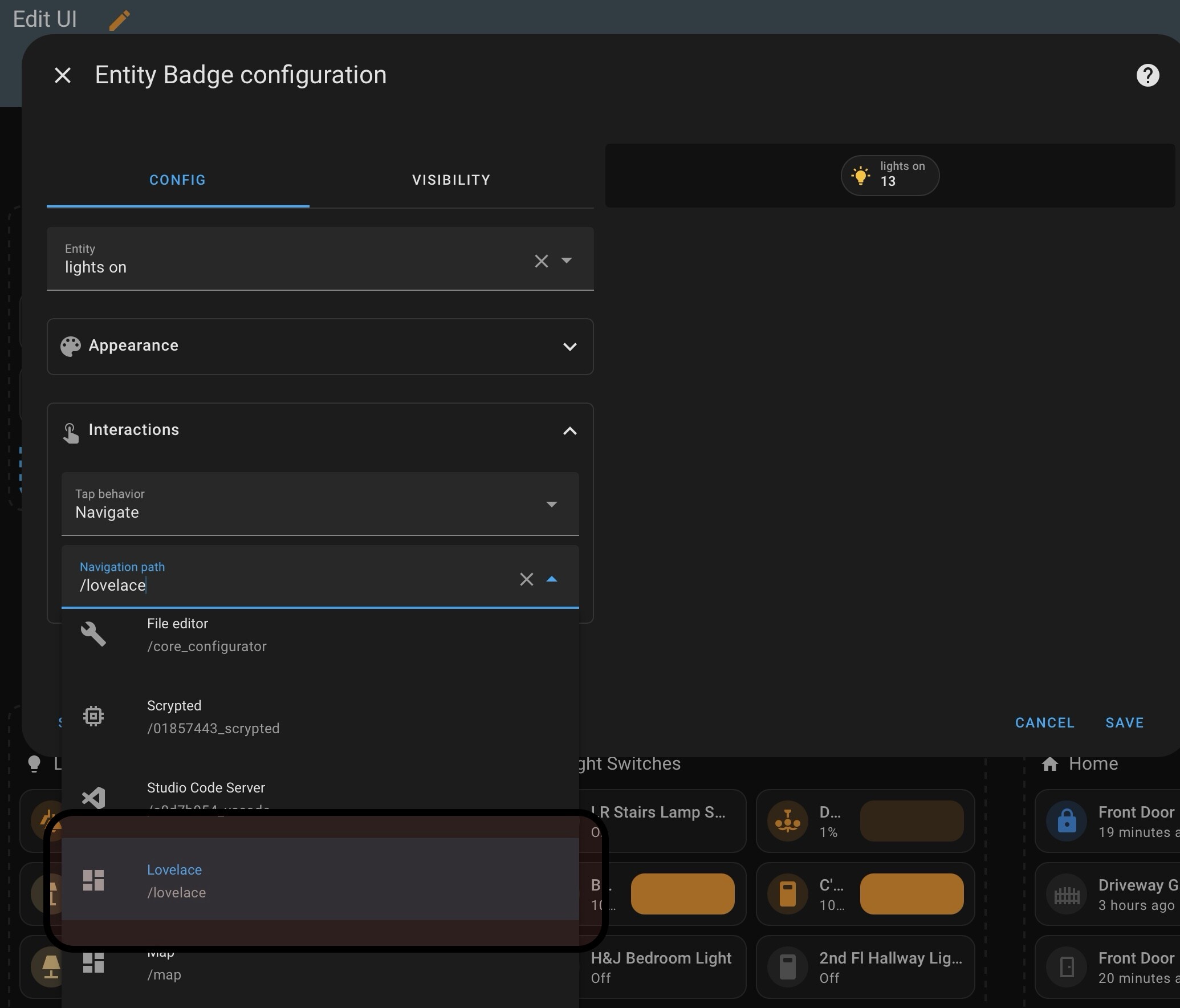

Thanks for the extra explanations and details Jack, so to understand what you wrote, it doesn’t seem I’m able to directly navigate to the lamps and lights in a dashboard from an action.
It sounds like my next steps to get this to work is to create sub-dashboards which are “views”. Then after created, I can set up the actions to navigate to those ‘views’. FYI, in my dropdown for ‘navigation path’ right now I only see one “/lovelace”, I am assuming that is because I did not create any sub-dashboards/views?
Ps- to be 100% clear I am attaching a screenshot of what I see from the navigation path dropdown right now.
thank you for your time!
