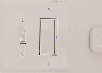

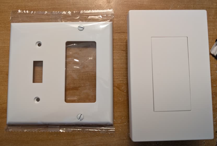

I was going to install a Sonoff ZBM5 next to the ceiling fan switch in my 1/2 bath. But as you can see this switch would not work with this faceplate. Can someone recommend a smart switch which would work with the fan switch?
-Thanks

You likely need smart relay instead of switch. What relay, depends on your wiring and the load you need to switch.

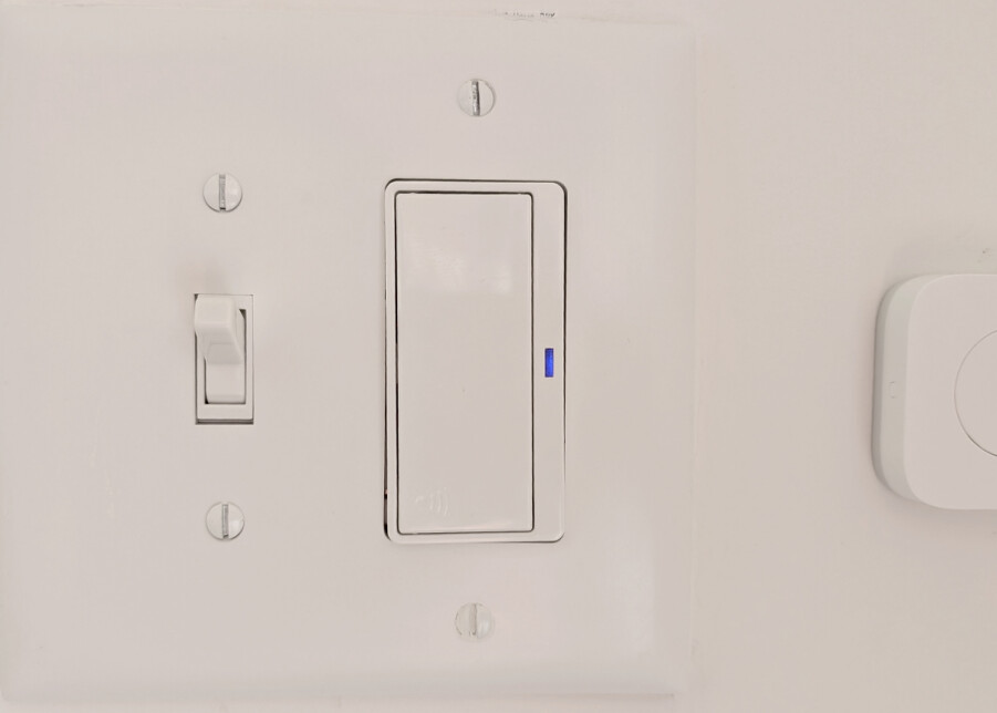

Thanks. I have an Eaton smart switch that was installed when I moved in (See pic below). This is what I need, an in-wall switch that will fit the face plate (See below). Now to find one that is a Zigbee repeater would be nice!

I wound up having installed two Z-Wave LR switches, the Zooz ZEN71 and a ZEN75.
Thanks Bernie. I’m going to try the enbrighten 43080 as it seems to fit the requirements. It also supports dimming although this is not a piece of functionality that I need in the current use case. Have a good day.
