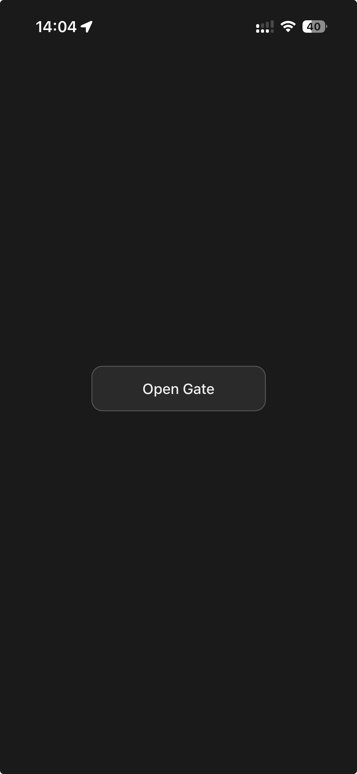

I created a small web page (actually a Progressive Web App) to give people access to a gate.
The PWA generates a UUID the first time it makes a call to HA via a webhook. I then add that UUID to my automation for a tiny bit of access control.
Webhooks don't return data, so my automation then posts the state to the same webserver so the PWA can show state (e.g. gate open/closed).
I did very extensive UX design on the app. :wink:

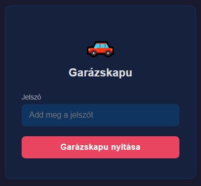

Great idea. I worked out a php page, with a password, using Claude last night. It will open and close the garage, with some feedback from HA about the garage door status. Claude even added some UI elements to make it look nice.
php:

and here's the automation that goes with it.
alias: Garage Door Webhook Trigger
description: Opens garage door when webhook is called
triggers:
  - webhook_id: very-long-random-char-string
    allowed_methods:
      - POST
    local_only: false
    trigger: webhook
conditions: []
actions:
  - target:
      entity_id: cover.smart_garage_door_opener
    action: cover.open_cover
mode: single
Just make sure the devices and webhook_id match in both the php and the automation. Also, in most cases, the 'HA_URL' will need the port number - mine is behind a reverse proxy.
