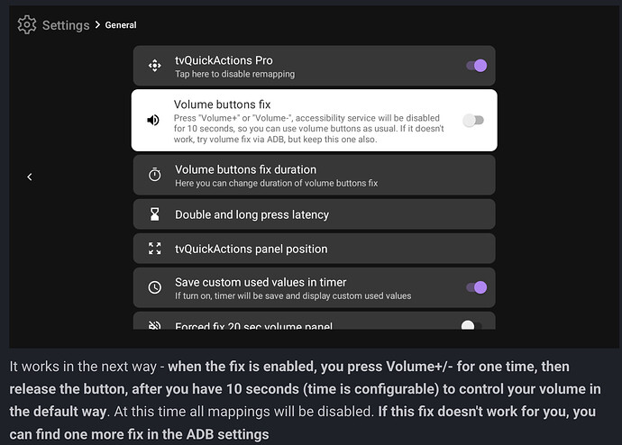

I had a question about the volume control issue when turning the Accessibility on. There is another app called tvQuick Actions pro (Quick Start Guide - tvQuickActions Docs) which addresses the volume issue by temporarily disabling accessibility services for 10 seconds when the Volume (+) or (-) is pressed. Do you think you could implement a similar workaround for QuickBars? Probably would help make your app work for most TV manufacturers.

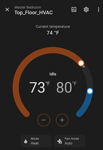

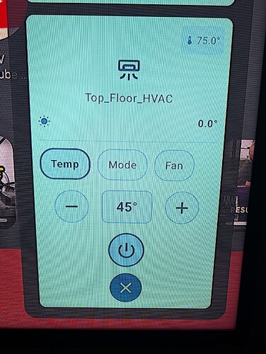

Amazing app. My problem is that I can’t get climate to work. It’s stuck at 45 degrees. Might be a centigrade vs. fahrenheit issue.
