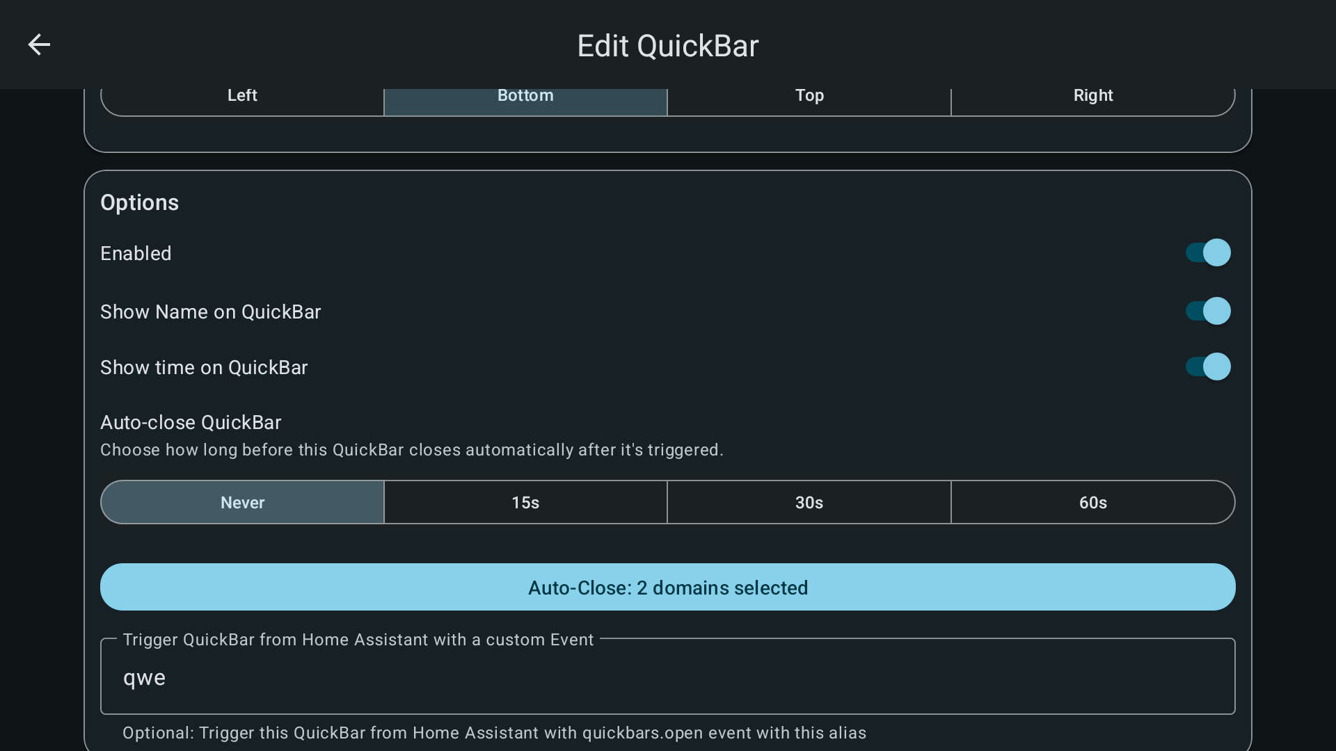

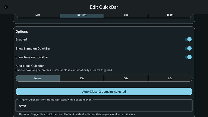

  • Auto-close timer for QuickBars – You can now set an auto-close timer per QuickBar (in the QuickBar settings). Options: Never, 15s, 30s, 60s.

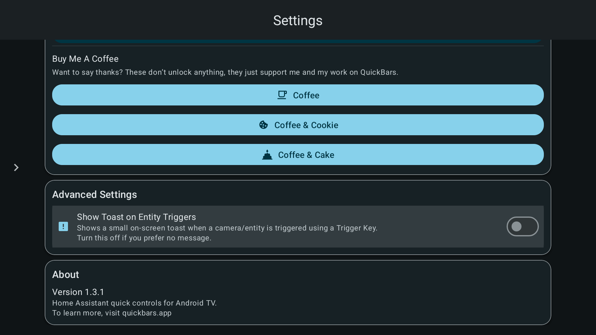

  • Global “Show toast on entity triggers” toggle – There’s now an option in QuickBars Settings → Advanced Settings to globally disable the little “X triggered” toasts when entities or cameras are fired by Trigger Keys. Perfect if those popups were getting on your nerves.
