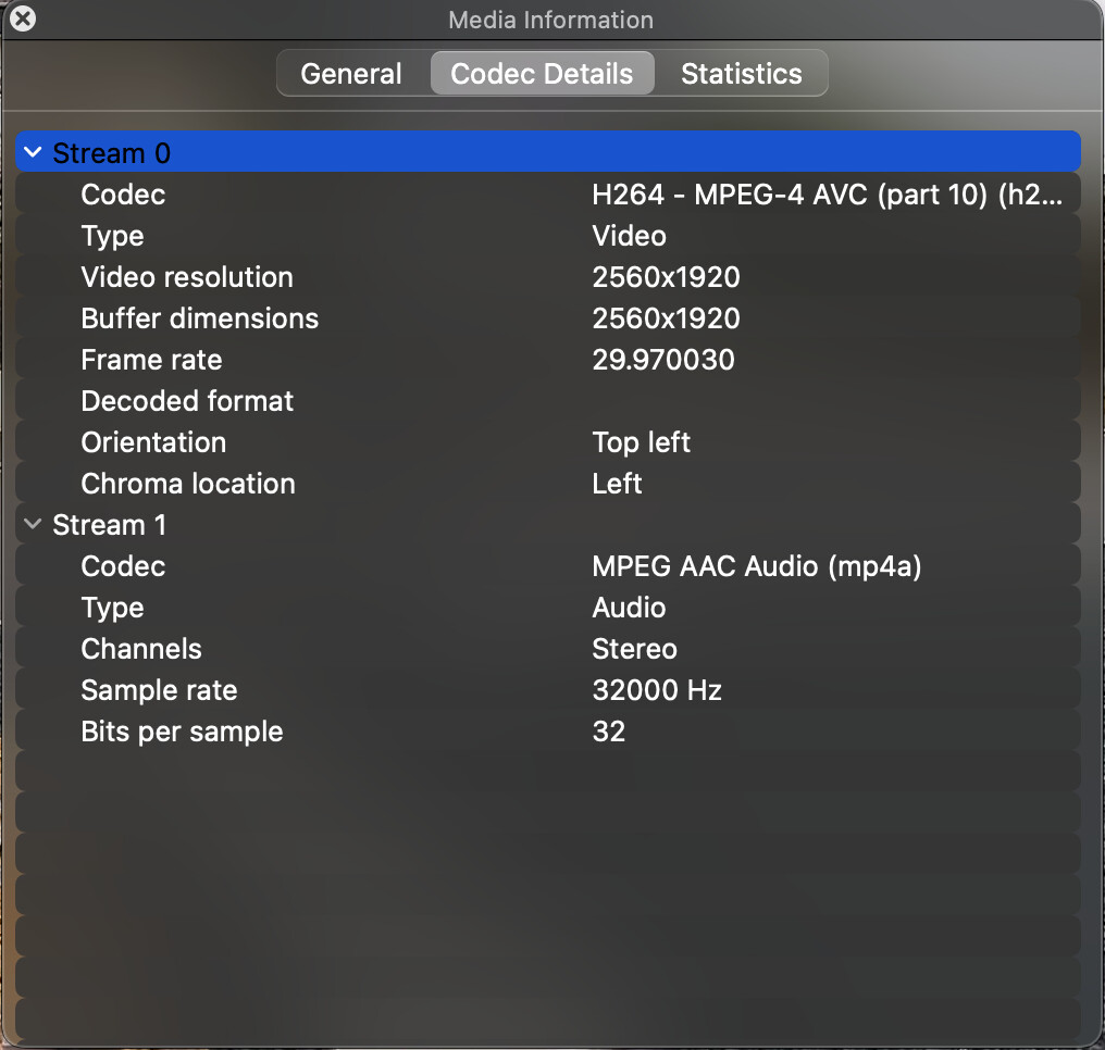

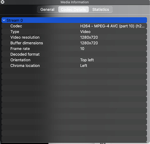

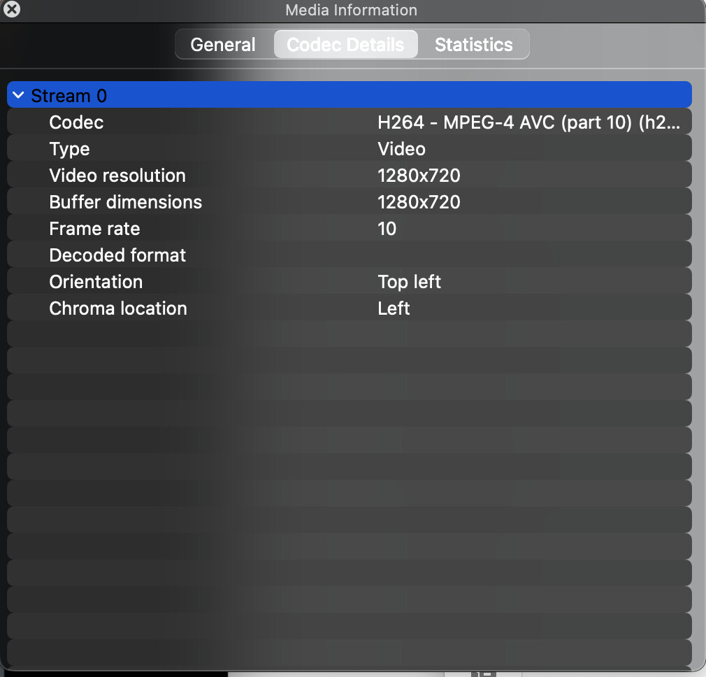

Hello Omri,
the RTSP implementation is working for streams coming from go2rtc within Frigate.
But if I want to use birdseye from frigate, nothing shows up. The stream is working in VLC
media information of a working stream from go2rtc
media information from the non working birdseye stream
if you need anything else to followup, please let me know
