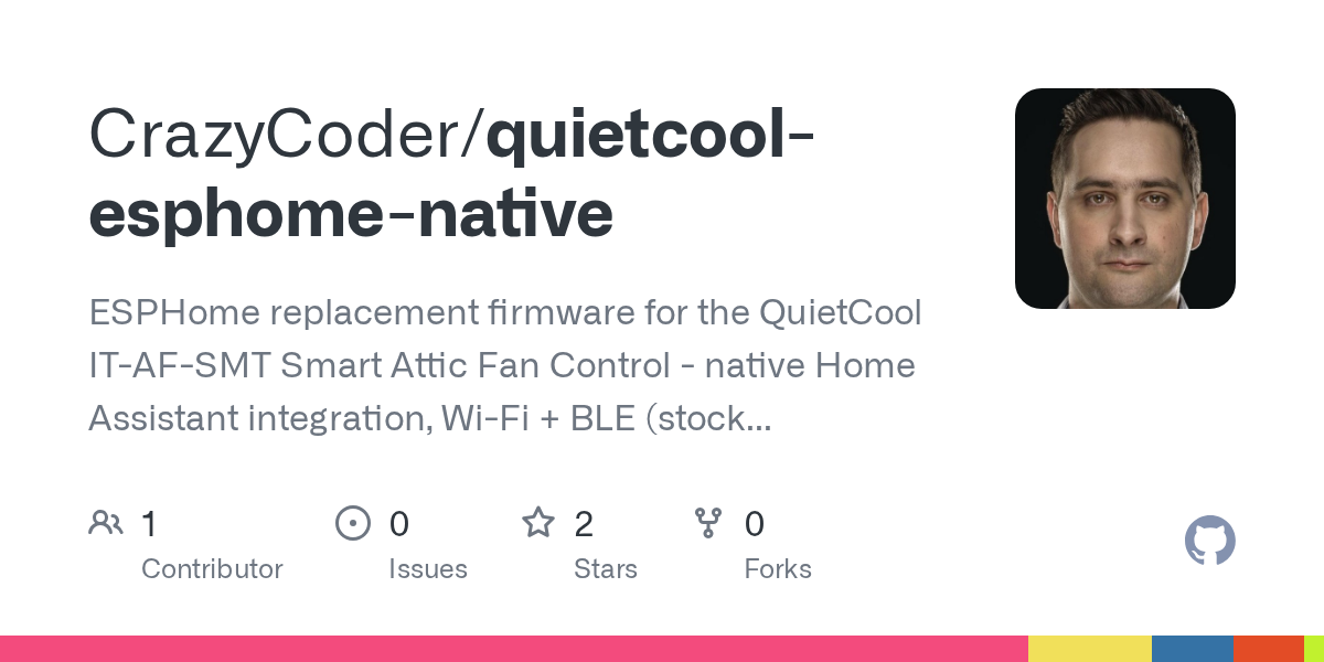

BTW, my feature complete ESPHome native firmware is almost ready and can be already tested. I’m doing the final polishing and testing before the wider announcement.
If you need the full BLE protocol documentation, see here.
This provides a native Home Assistant integration via Wi-Fi, and the mobile Smart Control app still works at the same time via BLE.
Web installer can flash it in 2 minutes. You only need to initiate pairing, either via the Smart Control app or using the Pair button on the controller, and it will replace your OEM firmware with the ESPHome version. Rollback to OEM is also easy if you find any issues (single button in HA).
It preserves existing settings and presets from the original firmware.

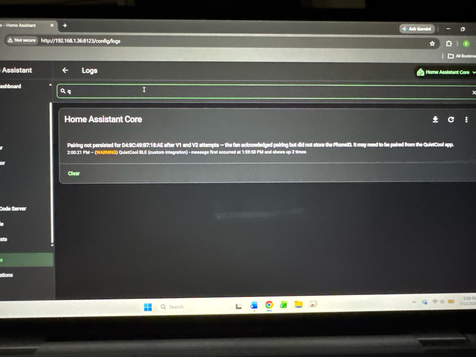

I updated to 0.2.12 and tried pairing again. The fan acknowledges the pairing command but does not persist the Phone ID.
I saw that 0.2.12 allows entering an existing Phone ID to skip pairing and log in. I checked the QuietCool iPhone app, including the Fan Info screen, but I don’t see the Phone ID displayed anywhere.
Do you know how I can retrieve the Phone ID being used by the QuietCool iPhone app so I can enter it into the integration?

I tried pairing again using Pair Mode from the QuietCool app and captured debug logs.
The V1 Pair command returns Success with PhoneID bbae162c7d125251.
The subsequent Login using the same PhoneID returns:
{'A': 13, 'R': 'Fail', 'P': 'Yes'}
The integration then tries the V2 flow. A=15 returns an empty response {}, and A=14 pairing returns:
{'A': 14, 'R': 'Success'}
So the fan acknowledges both V1 and V2 pairing as successful, but login with the PhoneID still fails.
QuietCool BLE Pair → {"Api": "Pair", "PhoneID": "bbae162c7d125251"}
QuietCool BLE Pair ← {'Api': 'Pair', 'Result': 'Success'}
QuietCool BLE Login → {"Api": "Login", "PhoneID": "bbae162c7d125251"}
QuietCool BLE Login ← {'A': 13, 'R': 'Fail', 'P': 'Yes'}
QuietCool BLE A=15 ← {}
QuietCool pair: V2 PairMode response: {}
QuietCool BLE A=14 → {"A": 14, "P": "bbae162c7d125251"}
QuietCool BLE A=14 ← {'A': 14, 'R': 'Success'}
QuietCool pair: V2 Pair response: {'A': 14, 'R': 'Success'}
I might be wrong without seeing your exact fan, but here’s a theory that could fit.
The thing that stands out in your log is that Pair returns Result: Success, yet Login with that same PhoneID comes straight back as Fail. If the id had really been saved, that next login should have matched it. So it looks like the fan may be accepting the Pair command and replying OK without actually writing the id to its flash.
If that’s what’s happening, it’s probably not the 50-pair limit, since that tends to answer Beyond rather than Success. A more likely explanation would be the fan’s small NVS config storage being full, so the save fails quietly while the command still reports OK. The same behavior came up in the awkaplan/quietcool-esphome thread, which was based on the same AFG SMT PRO-2.0 fan: the firmware kept accepting new pairings but stopped saving them, and logins failed until someone switched back to a pair-id that had worked before (Changes to use the new JSON API in newer quietcool firmware by kentonr · Pull Request #2 · awkaplan/quietcool-esphome · GitHub).
An easy way to check whether it’s the fan and not Home Assistant: try adding a second phone in the QuietCool app. If that also fails to pair, it points more at the fan’s storage than anything on the HA side.
One thing to note about the fix in that thread: it only worked because they still had a pair-id that had registered before. The QuietCool app doesn’t show the id it uses, and reading the ones already stored on the fan means dumping its flash over USB-TTL, so unless you kept a working id from an earlier Home Assistant setup (that one lives in HA’s own config, not on the fan), that route isn’t really practical.
So the realistic option is a factory reset, which frees up room anyway. The pair-ids themselves are tiny; what actually fills that storage is the rolling sensor logs and the duplicated preset data the firmware keeps, and a reset clears all of it, which is what makes space for a new pairing to save. In the QuietCool app that’s Fan Settings > Reset to Factory Default, or you can hold the Test/Speed button on the unit for a few seconds, though that varies by model so the app route is easier. It removes all stored phones, so you’d re-pair the QuietCool app afterwards, and resets your settings.

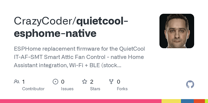

Or if you are brave enough, you can try the complete native ESPHome firmware from my repository (it cleans NVS bloat on the first start but keeps your existing pair IDs). Then you can try the pair option in my firmware, and it will store your new pair ID. Then you can revert to stock per the docs if you want and the pair ID will persist. Use on your own risk =)
