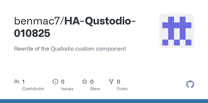

I stumbled across this integration and managed to get Claude to rewrite it for the latest versions of HA 2025.7 and the Qustodio API. Works for me, delete the old one and add this new folder in your custom_components folder.

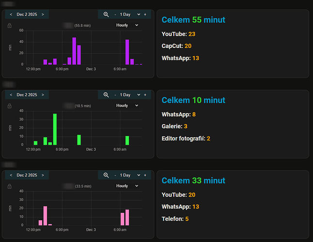

Edit 1: It seems to me that the time of the application is somehow delayed compared to Qustodio app itself and even to the overall time. But I suppose that is just what is provided by the API ā¦
Edit 2: Would be better to set state_class to total_increasing for the overall time sensor. That way it can be used by the built-in Statistics Graph card to show hours split. At my screenshot it is History Explorer card
Good idea! Iāve made that suggested change - new version published.
I tried to take a look at the history card, but it doesnāt seem to be in HACS and both the old and new fork seem abandoned.
The change works.
Sensor is now available in Statistics Graph card.
