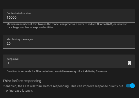

The latest version of Ollama integration has a control switch to control thinking.
You can completely disable this stage.
But even with thinking enabled, the text of thoughts will not be added to the response.

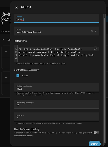

I have “Think before responding” switched off. I’m on HAOS 2025.8. I’m using Qwen3 in the official Ollama integration. And I added /no_think to the Instructions section for the conversation agent. But still seeing empty tags in the responses. Am I still missing something? Or am I misunderstanding your instructions?
model downloaded from ollama collection? library may not work well with third-party versions
this action is not required
edit: Nevermind, it’s working now! I re-downloaded the model to get a screenshot showing my setup and that seemed to fix it!

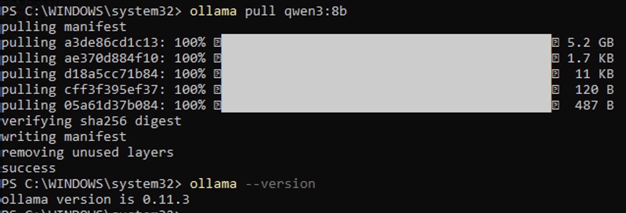

@mchk Yes, I used this command to download it.
ollama pull qwen3:8b
then use ollama serve. I’m on version 0.11.3
In my setup the “Think before responding” toggle doesn’t have any effect. It still adds a full thinking block at the beginning of the response. But if I add /no_think to the Instructions, then I get an empty think block.
edit: I’m just noticing that if I activate the “Think before responding” toggle, then I always get this error:
Unexpected error during intent recognition
Here’s my Ollama integration settings.
