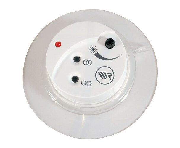

They worked on my Solar powered Sun sensor Rademacher: “DuoFern Sonnensensor 9478” :
it’s not visible anymore on: Übersicht Sensoren Rollladen und Sonnenschutz - Rademacher because it’s replaced by a battery powered sun sensor.

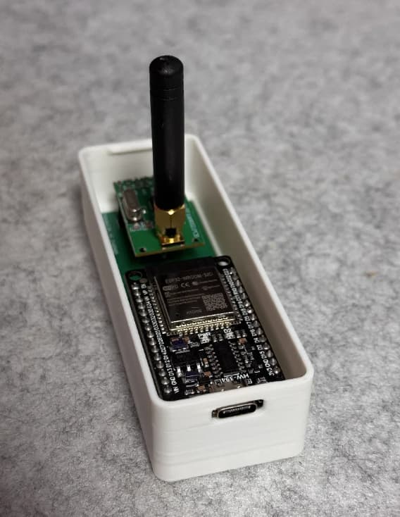

Since the Rademacher Duofern USB stick is obsolete (you can’t find or buy it anymore) I was looking in other “backup” solutions into controlling my Duofern roller shutters for when my USB stick dies.

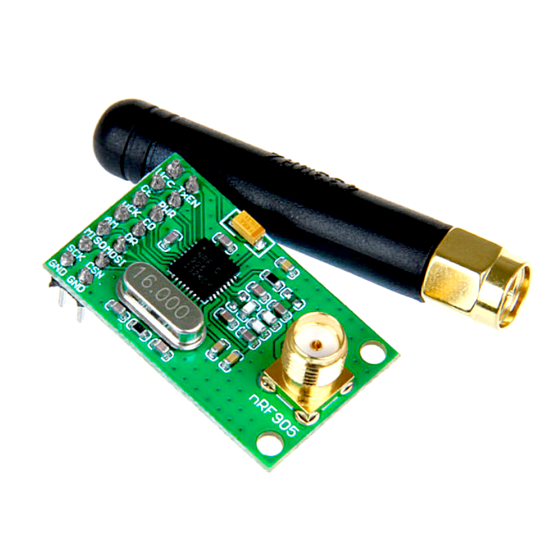

I’ve been develloping my own ESP32 chip based control for it using a NRF905 transceiver:
This sends complete Duofern packages into the air (parallel next to my HA USB stick).
At the moment the ESP32 chip used an internal on-board website for control & testing, but in the end it will be fully HA controllable over MQTT or WebAPI.
There are indeed some “quirks” in the whole handshake procedure. I notice when I send Duofern messages by ESP32 my existing PyDuofern integration lost it’s handshake and had to rehandshake.
My ESP32 also does some handshaking & resending when receiving not ACKED telegrams & get’s ACKED after some extra telegrams.

Sure i’m willing to provide Duofern logs for Sun sensors. (I only have 2 9478’s)
and willing to help test it out.

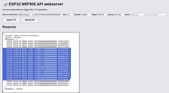

Below is my “bare” Duofern log my ESP32 Duofern application captures when the solar sensor trips to Sun state or No Sun state.
6F1234 is my network key and A524A8 is my 9478 Sun sensor (solar powered).
“6F1234 A524A8 00 0015BF 142011 FF070801FF0100000000000000 1B525687BA0B”,
“6F1234 A524A8 00 0015BF 242011 FF070801FF0100000000000000 7E219F834A7F”,
“6F1234 A524A8 00 0015C0 042011 FF070801FF0100000000000000 CD4327D50969”,
“6F1234 A524A8 00 0015C0 142011 FF070801FF0100000000000000 C2176BEE7D68”,
“6F1234 A524A8 00 0015C1 042011 FF070801FF0100000000000000 B3E8B84ECBFA”,
“A524A8 6F1234 02 0015C2 042011 FF070801FF0100000000000000 908BA4DB4A47”,
“A524A8 6F1234 03 0015C0 032011 FF070801FF0100000000000000 136FF60E7E33”,
“6F1234 A524A8 00 0015C3 042011 FF070801FF0100000000000000 E9F1F2A31D7C”,
“A524A8 6F1234 02 0015C4 032011 FF070801FF0100000000000000 2103666E0A08”,
“6F1234 A524A8 00 0015C5 042011 FF070A01000100000000000000 234444292FD8”,
“A524A8 6F1234 02 0015C6 032011 FF070A01000100000000000000 5B56B8F41C64”,
“6F1234 A524A8 00 0015C7 042011 FF070801FF0100000000000000 75C65684BA4C”,
“6F1234 A524A8 00 0015C7 142011 FF070801FF0100000000000000 9C6E977D65B8”,
“A524A8 6F1234 02 0015C8 032011 FF070801FF0100000000000000 ADD8CA4FA7D8”,
“6F1234 A524A8 00 0015C9 042011 FF070A01000100000000000000 8721E1FDCDFA”,
“A524A8 6F1234 02 0015CA 042011 FF070A01000100000000000000 C9B449E749EE”,
“A524A8 6F1234 02 0015CA 032011 FF070A01000100000000000000 BF3355C8BA86”,
For comparison 407F0E is my one Rollotron attached at the moment. (think it’s a 1200 model, not sure)
You will recogize the different Duofern status stuff in the 6’th string part.
In the 4’th string part you see the incrementing counter.

A524A8 my Sun sensor is visible there :slight_smile:
As for backup solution instead of the USB stick, i’m develloping my own bare metal Duofern solution based on ESP32 chip & NRF905 wireless transceiver.
But this is a long work in progress since I do this in my spare time.
At the moment it’s just experimental code just to test out from a webpage on the ESP32: (marked below is the same sun sensor messages from today)
I’m just starting to learn all different Duofern packets also with the help of FHEM & PyDuofern code. Also how to send & receive since you have to retry or send some packets multiple times, include incrementing ID’s and since NRF905 sends our bare wireless also add some magic Duofern secret hash codes.
Hardware is based on a design by Joost who did an ESP32 to NRF905 board to control Zehnder air units. (discussed here: Zehnder comfofan s aansturen via RPi, Arduino - Modding, mechanica en elektronica - GoT)
You can find his ESP32/NRF905 PCB here:

It looks like this then: (my Duofern backup solution when my original Rademacher USB stick will fail):
Zehnder uses other Frequency, but you can change the NRF905 frequency to fit Duofern’s 434.5 MHz.
Other solution would be to use NRF905 ESPHOME.

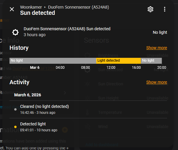

My solar sensor is recognized but I think inverted detection signal (have to check further when the sun shines today :sunglasses: )
But I can’t seem to add “Issues” or “comments” to Irstman’s github.
Further you can tick off tested: DuoFern RolloTron Standard (40xxxx) works also great.
So if you’re reading Irstman, thanks a lot for completing the missing Duofern FHEM code into this native HA one. :+1:
Well first of all - thanks fo Mark’s integration which was what got me going in the first place! I didn’t want to steal it or something, I was just missing the dawn / dusk part and then it escalated rather quickly that with the help of Claude I was able to integrate more and more of the missing features (as I’ve never used python before) and started adding something more (auto-discovery of paired devices if opt-in enabled).
Second… well, I don’t know why but github didn’t enable issues on the forked Repo. I’ve enabled it now.
And maybe the invertion is based on how HA handles 0 / 100 % which is just the other way round from FHEM. I will try to take a look, can you send some raw frames from the debug log via an issue (which is now possible :slight_smile: )?

It’s looks like there is no invertion.
The sun detection works exactly like with PyDuofern.
I can confirm a sun sensor (solar powered) works: type A5xxxx
