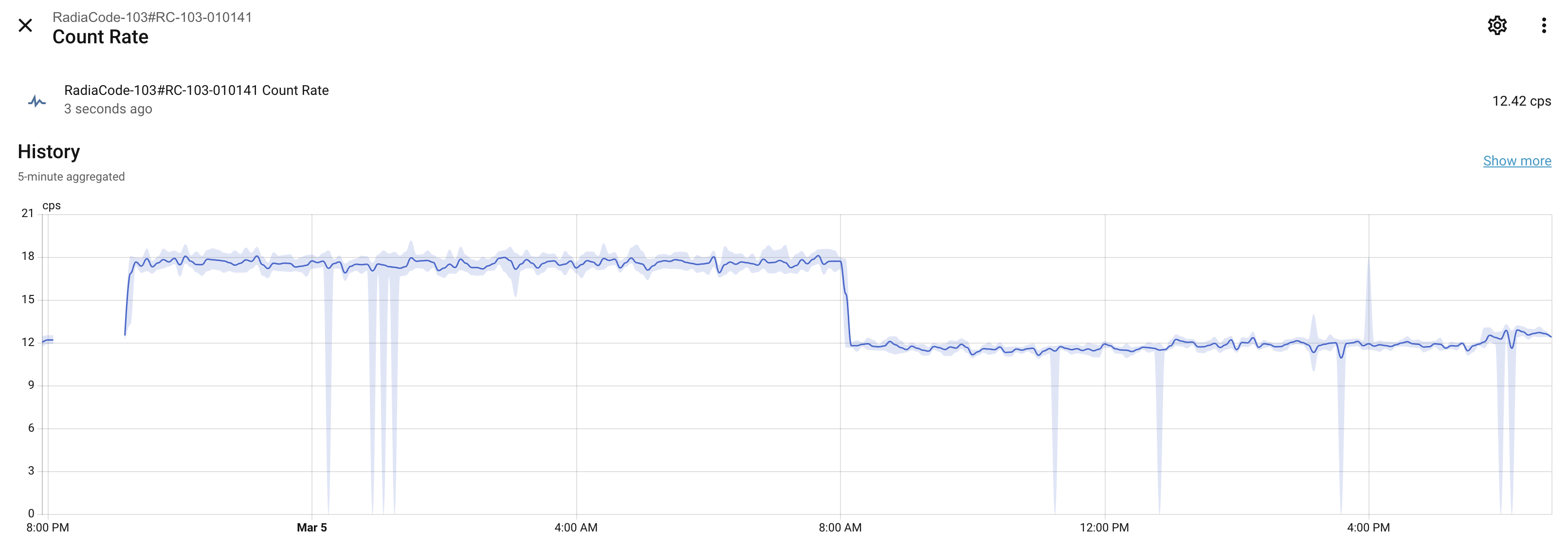

Hi all- I’ve finally got around to doing something I’ve wanted for a while: connecting my RadiaCode radiation detector/spectrometer directly to Home Assistant over Bluetooth.
(CPS capture of the Radicode on a banana overnight, followed by typical background levels)

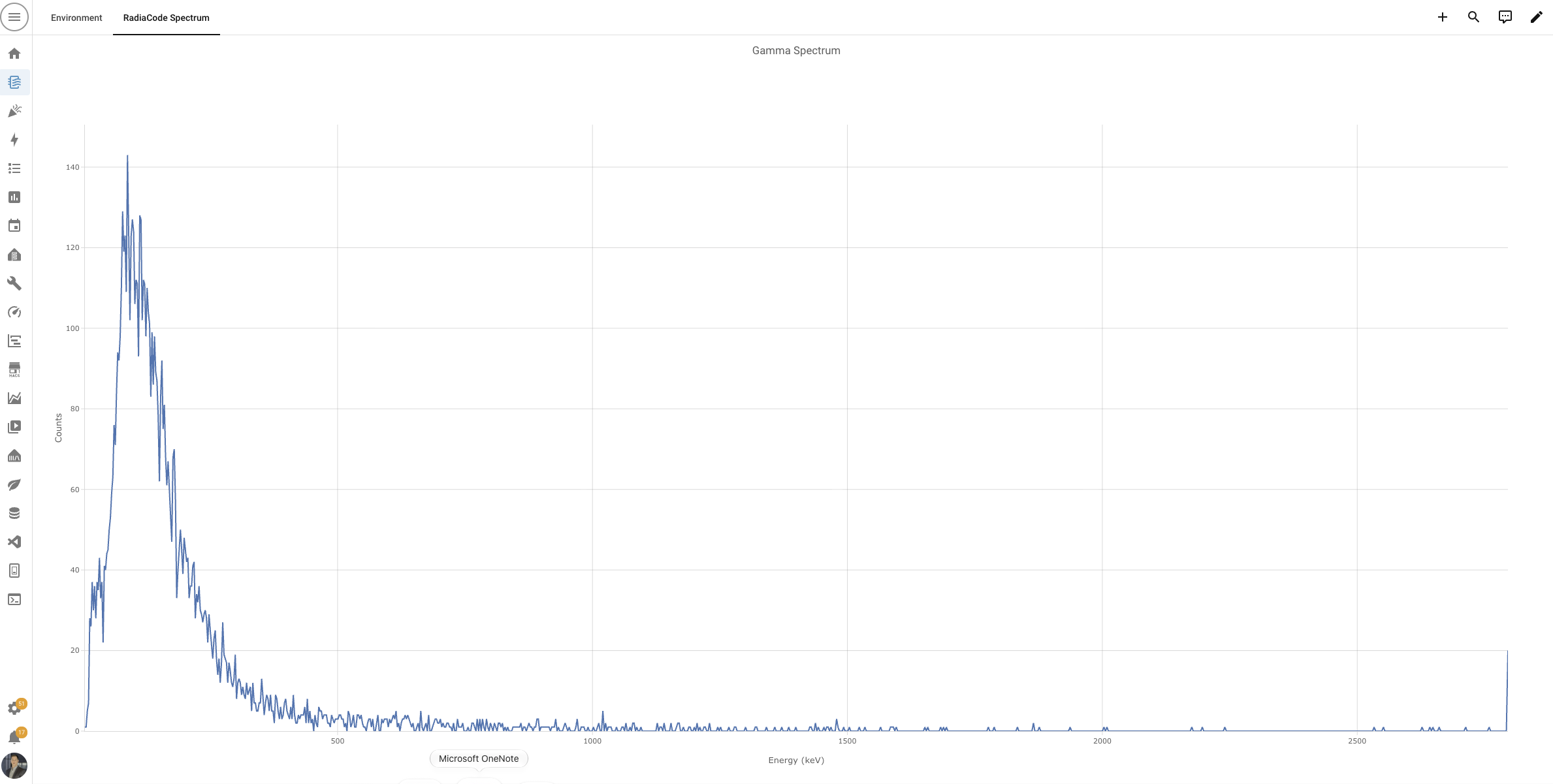

Hi all, for those following, we (Sol and I :slight_smile: ) just released a major update that fixes a number of connection and spectrum display issues. You should now be able to get a nice spectrum display in Home Assistant using Plotly Graph Card.
