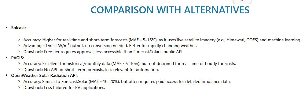

I did see on the link you sent that for more accurate data the Solcast option is the better way to go.
solcast limits to 10 API request per day…

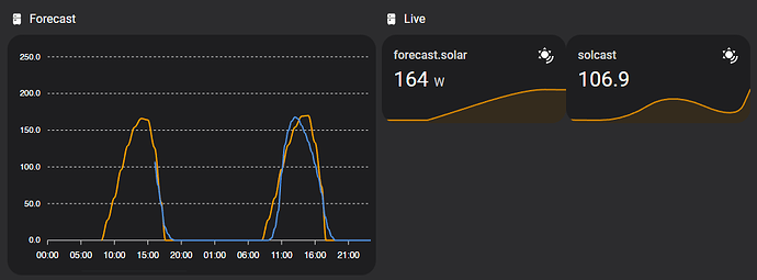

I integrated both solcast and forecast.solar, granulometry is better with solcast but data is finally quite similar…
sensor:
  - platform: rest
    name: "Forecast Solar Raw"
    unique_id: "Forecast_Solar_Raw"
    resource: https://api.forecast.solar/estimate/watts/xx/yy/90/52/1
    scan_interval: 3600
    value_template: >
      {% set data = value_json.result %}
      {% if not data %}
        unknown
      {% else %}
        {% set api_time = value_json.message.info.time %}
        {% set hour_key =
          strptime(api_time, '%Y-%m-%dT%H:%M:%S%z')
          .strftime('%Y-%m-%d %H:00:00')
        {{ data[hour_key] if hour_key in data else unknown }}
      {% endif %}
    unit_of_measurement: "W"
    device_class: power
    state_class: measurement
    json_attributes:
      - result
      - message
  - platform: rest
    name: "Forecast Solcast Raw"
    unique_id: "Forecast_Solcast_Raw"
    resource: https://api.solcast.com.au/rooftop_sites/1ca6-7b01-5516-3f6b/forecasts?format=json&api_key=j***************************
    scan_interval: 3600
    value_template: 106.9  //hard value for the test only
    device_class: power
    json_attributes:
      - forecasts
