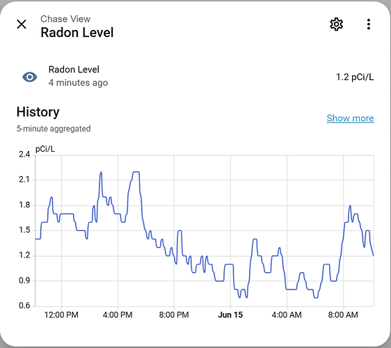

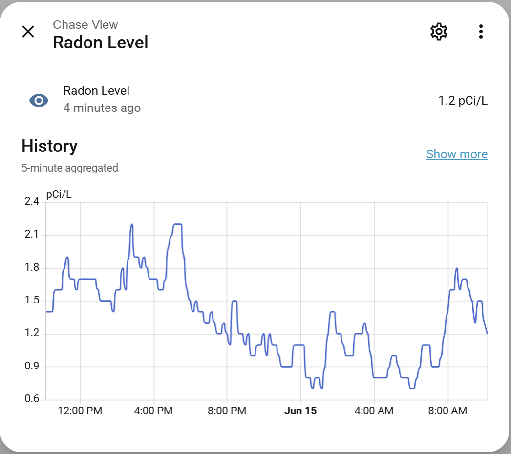

Yes, every other one I researched would only update the short term every hour, the short term being 24 hours. So that is pretty useless for fan control. This one gives an actual reading every ten minutes, which is what I'm using to control the exhaust. Below is what it looks like in HA.
I'm kind of surprised the level changes that quickly after the fan starts since I'm not actually ventilating the room, just the foundation.
In the case above, the fan started running at 2:46 pm and stopped at 10:56 pm.
I have my setpoints at 2.0 and 1.
