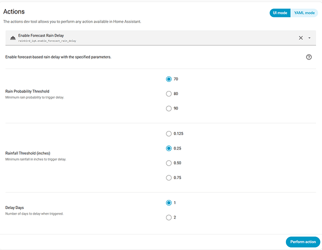

  • Enable/disable forecast-based rain delay
  • Set weather adjust to automatic or manual (with seasonal adjust %)

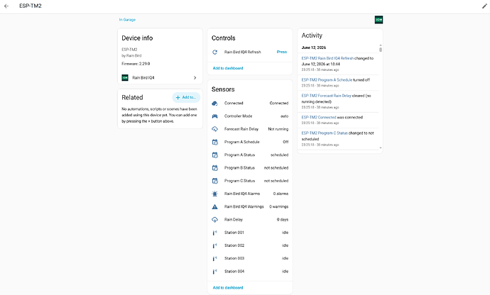

The only issue I have found is that it shows the wrong controler under device info:
But who cares :wink:

Thanks also for pointing out the incorrect controller model; since it was initially for my personal use, it's currently hardcoded as ESP-TM2 :sweat_smile:. I'll fix it in the next release.
Edit: I have released version 1.0.2 with the change in the controller name
Cheers it is now correctly showing ESP-ME3 :slight_smile:

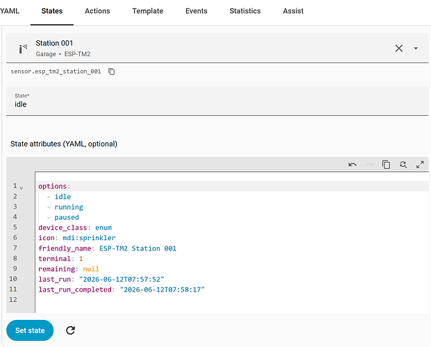

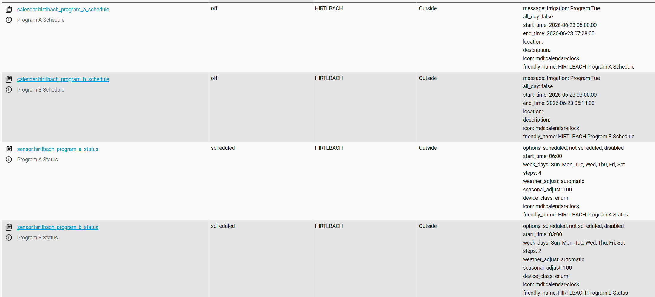

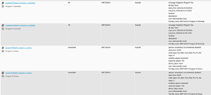

Could you share the raw attributes of the Program A sensor in HA? You can find them it in Developer Tools → States
I’m not sure if it’s a problem with the integration or the card

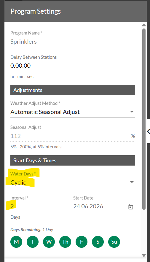

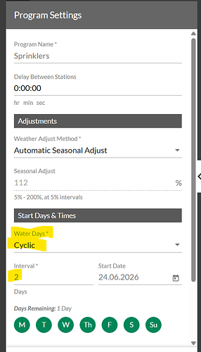

Looks like the sensors are missing some info on the detailed schedule data
Here is how it looks on the IQ4 site
Thanks for the details
The issue is that your program uses Cyclic water days, which the integration doesn’t currently support; it reads all days as active but doesn’t account for the cyclic interval.
I’ll investigate how to handle this correctly and will update when I have a fix.
v1.0.3 is now available with support for Cyclic, Odd and Even program schedule types. Programs using these schedule modes now show correctly as "scheduled" with the appropriate attributes (schedule_type, skip_days, next_run, excluded_days).

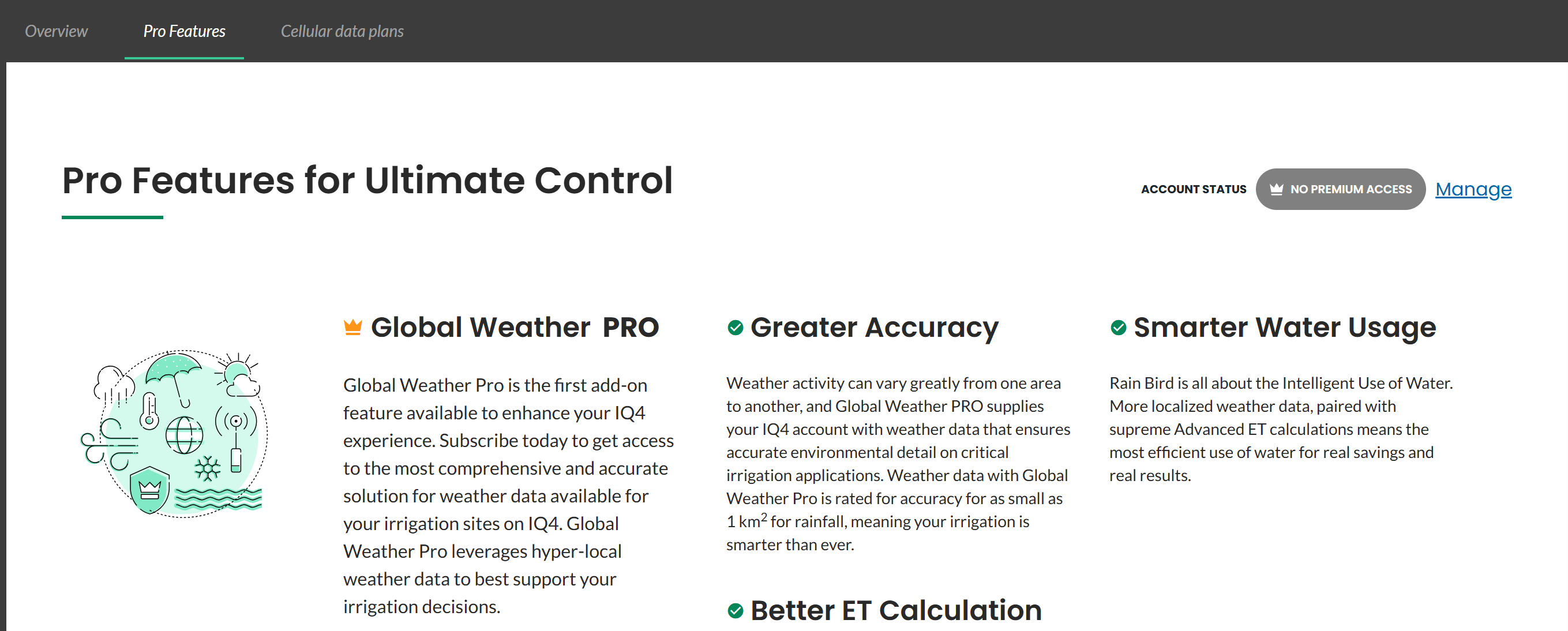

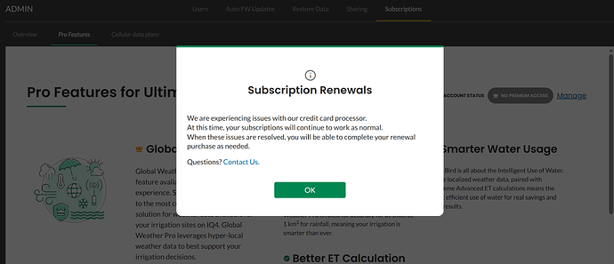

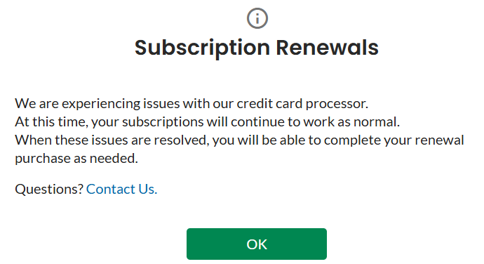

When I log into IQ4, I can see my controller, but it is 'greyed' out and nothing is selectable. Says I need to subscribe to get access. I got on chat and they said yes, I have to subscribe.
have they said what you need to subscribe to?

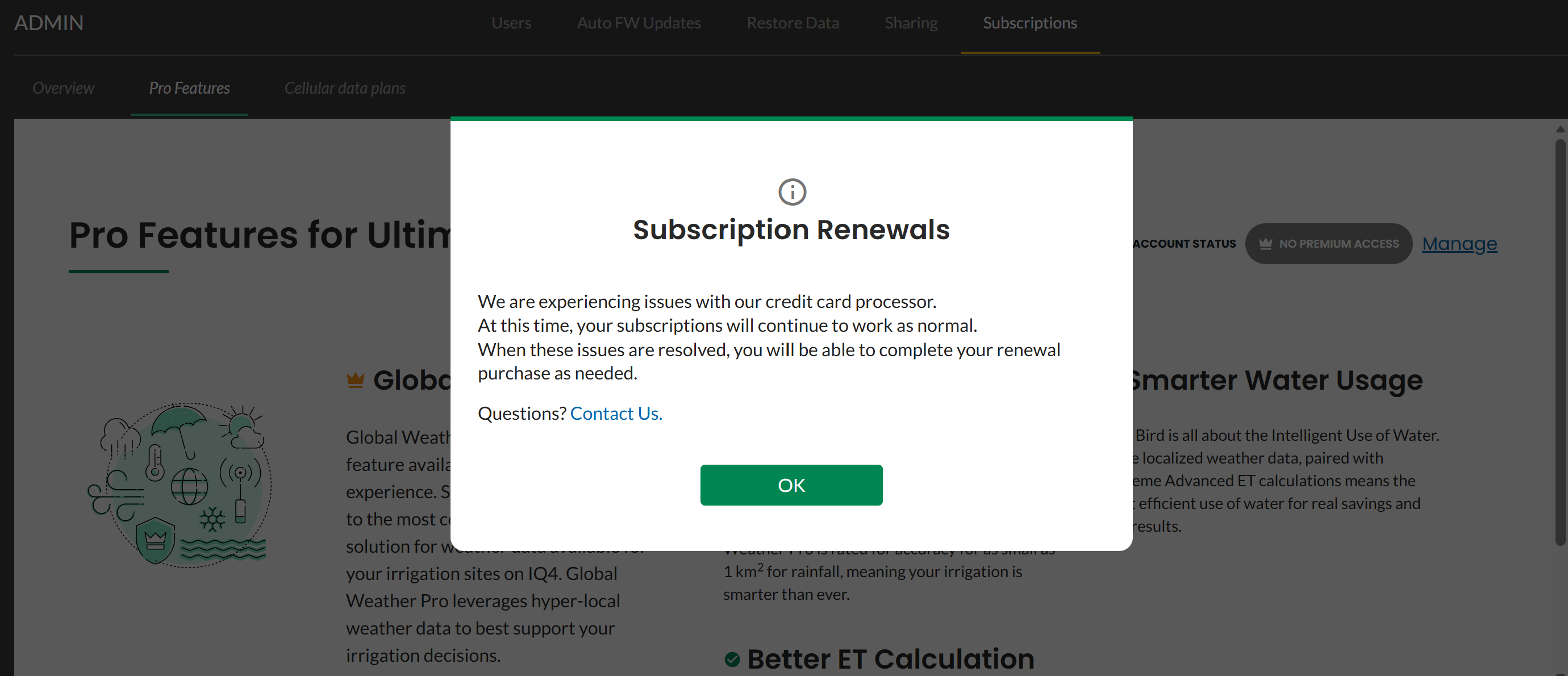

Also when I click on manage subscriptions I get this:

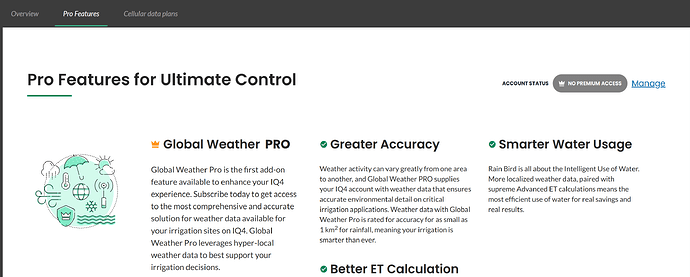

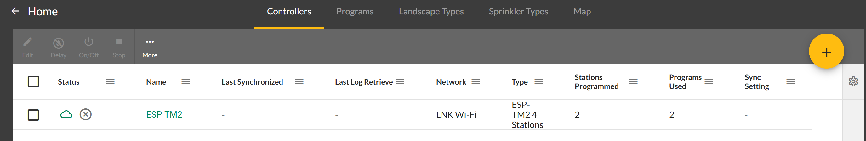

This is what I see in iq4.rainbird.com
Just to confirm:
  • You have the Rainbird 2.0 mobile app, right?
  • You added the controller through the app and you can control it from there?
  • Perhaps you could remove the controller from the mobile app and add it again; if I remember correctly, you had to put the Wi-Fi dongle into pairing mode by holding down the button until the LED blinks blue/red?
