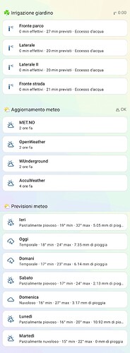

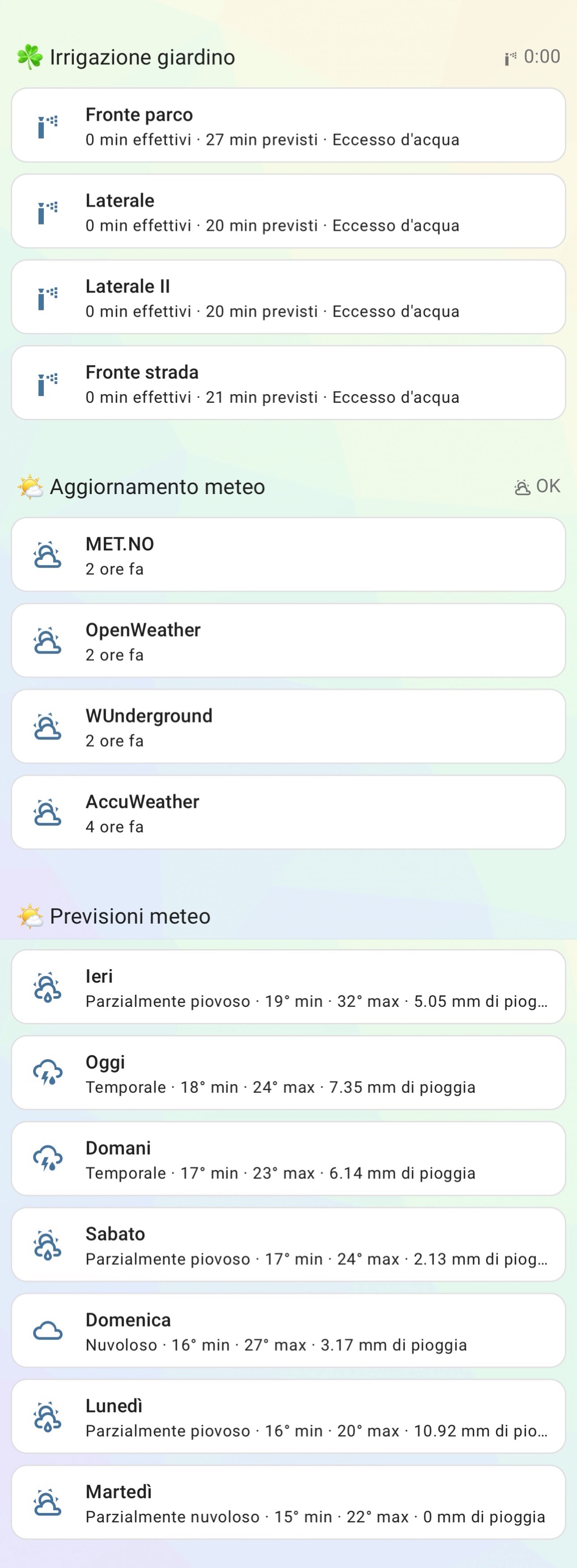

Below, I explain how I did it. I’m with Home Assistant OS.
The python code was written with the help of ChatGPT.
I used the generated sensors to receive notifications and to create additional sensors for making graphs, and therefore, I canceled the premium service subscription and disconnected the RainMachine from their cloud.
  1. Install the official AppDaemon add-on and start it.

            for zone in zones:
                uid = zone.get("uid")
                if uid in zone_names:
                    name = zone_names[uid]
                    cycle = zone.get("cycles", [])[0]
                    real_duration = cycle.get("realDuration", 0)
                    user_duration = cycle.get("userDuration", 0)
                    start_time = cycle.get("startTime")
                    flag = zone.get("flag", -1)
                    self.set_state(f"sensor.rainmachine_{name}_watering",
                        state=str(int(real_duration) // 60),
                        attributes={
                            "friendly_name": zone_friendly_names.get(name, f"Zona {name}"),
                            "unit_of_measurement": "min",
                            "userDuration": int(user_duration) // 60,
                            "userDuration_unit": "min",
                            "realDuration": int(real_duration) // 60,
                            "realDuration_unit": "min",
                            "userDuration_display": f"{int(user_duration // 60)} min previsti",  # TEXT ATTRIBUTE WITH UNIT
                            "realDuration_display": f"{int(real_duration // 60)} min effettivi",  # TEXT ATTRIBUTE WITH UNIT
                            "startTime": start_time,
                            "flag": flag_map.get(flag, f"Flag sconosciuto: {flag}"), # TRANSLATE IN YOUR LANGUAGE
                            "icon": "mdi:sprinkler"  # ZONES ICON
            # === FORECAST CONDITIONS ===
            self.log("Getting forecast conditions...")
            r = requests.get(add_token(forecast_url), verify=False)
            r.raise_for_status()
            forecast_data = self.parse_pre_json(r.text)
            weather_conditions = {
                0: "cloudy", 1: "sunny", 2: "partly-cloudy", 3: "partly-cloudy", 4: "partly-cloudy", 5: "rainy",
                6: "sunny", 7: "snowy", 8: "snowy", 9: "sunny", 10: "snowy", 11: "partly-rainy",
                12: "lightning-rainy", 13: "partly-cloudy", 14: "cloudy", 15: "sunny", 16: "sunny",
                17: "lightning-rainy", 18: "partly-rainy", 19: "pouring", 20: "partly-cloudy", 21: "cloudy"
            weather_conditions_tranlated = {  # TRANSLATE THE FOLLOWING ITEMS IN YOUR LANGUAGE
                "sunny": "Sereno",
                "partly-cloudy": "Parzialmente nuvoloso",
                "cloudy": "Nuvoloso",
                "rainy": "Piovoso",
                "lightning-rainy": "Temporale",
                "snowy": "Nevoso",
                "partly-rainy": "Parzialmente piovoso",
                "pouring": "Pioggia intensa",
                "unknown": "Sconosciuto"
            unknown_condition = "Sconosciuto"  # TRANSLATE IN YOUR LANGUAGE

    The scripts will generate the sensors and then update them every 1 min.
  1. Sensors
    A. Parsers sensors
    sensor.rainmachine_metno_last_run
    sensor.rainmachine_openweathermap_last_run
    sensor.rainmachine_wunderground_last_run
    sensor.rainmachine_accuweather_last_run
    The sensor’s state represents the last update
    B. Total watering sensor
    sensor.rainmachine_today_watering
    The sensor’s state represents the today real total watering time in minutes
    Additional attributes:
    date: the date of the watering
    userDuration: the watering duration defined by the user
    C. Zones sensors
    sensor.rainmachine_uid1_watering
    sensor.rainmachine_uid2_watering
    sensor.rainmachine_uid3_watering
    sensor.rainmachine_uid4_watering
    flag: The reason why an irrigation was reduced or skipped or whatever
    D. Forecast sensors
    sensor.rainmachine_forecast_condition_0 (yesterdaty)
    sensor.rainmachine_forecast_condition_1 (today)
    sensor.rainmachine_forecast_condition_2 (tomorrow)
    sensor.rainmachine_forecast_condition_3 (day of the week name)
    sensor.rainmachine_forecast_condition_4 (day of the week name)
    sensor.rainmachine_forecast_condition_5 (day of the week name)
    sensor.rainmachine_forecast_condition_6 (day of the week name)
    The sensor’s state represents the meteo state (eg. sunny)
    The icon of the sensor is updated based on the meteo state.
    temperature
    min_temperature
    max_temperature
    precipitation
    EvapoTranspiration
    day
    meteocode (I still need to check some of them)
    E. Watering Snooze sensors
    sensor.rainmachine_rain_delay
Preview:
