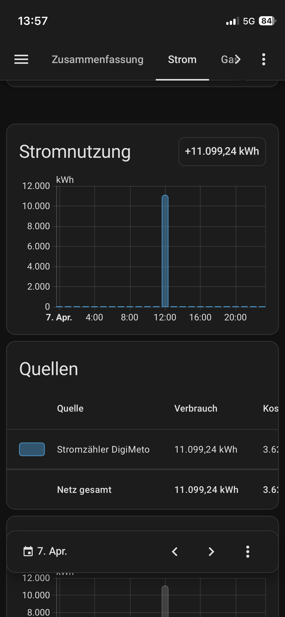

since March I’ve been experiencing intermittent issues with my main energy meter in Home Assistant.
The setup had been running stable for about a year without any problems. However, recently I’ve noticed that the sensor occasionally reports a value of 0, which results in unrealistic daily energy spikes (e.g. >10,000 kWh).
This behavior seems to occur randomly. I haven’t changed anything in the configuration or on the physical device.

What device/how are you getting your energy values into HA?
