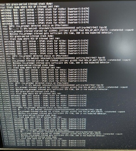

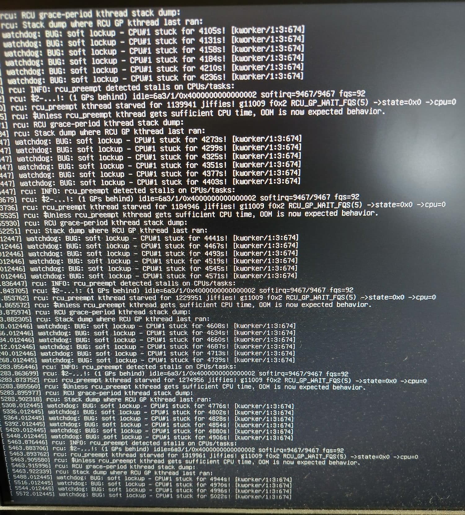

What I mean is - the system completely hangs, so there is nothing visible in /var/log or using journalctl. It hangs early enough in the haos VM boot process that everything in the image is still read-only. The only thing possibly useful I’ve gotten is that sometimes if I leave it sit long enough, I get a bunch of soft lockup - CPU Stuck errors, like these:
Well that one only tells me, it says it “Starved” :grin: ( Maybe it want more “Jiffies” ) or less i don’t know
( But please check IOT7712’s early question ( Your clock ) , but might be likely the cpu couldn’t handle “something” )
I was actually referring to you logs in Ubuntu, not HA’s log , As you say it Hangs the whole system !, but maybe i missunderstand
Just thinking how can a VM Hang a Host ? … Check Your Ubuntu Logs
